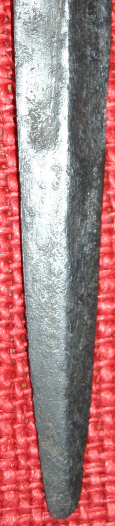

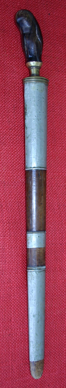

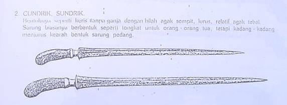

This is one I have had for a number of years and was sold to me as a "woman's sword" from Lombok. I am not so sure about the female attribution, and even less sure about what to call it. It may be a pedang suduk. Recently another similar sword was on eBay from a dealer in Bali who called it a Cundik/Sendirung, which I cannot find in v. Zonneveld or any other reference that I have.

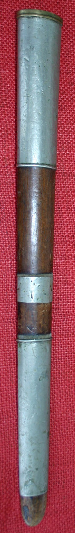

The sword itself is of good quality, with silver and gold mounts (yes it has been tested and found to be gold, although the percentage of gold is probably low). The handle is wood, and resembles pelet wood that we discussed recently on another thread. The precision of fit of the sword to the scabbard indicates this scabbard was made for the sword and may be original. The blade was polished when I got it, and a light etch indicates a pamor that may be ngulit semonko. The tip of the blade appears to have been reshaped a little. The blade is partially sharpened on the back edge, like many pedang.
Interested to hear what you think of this sword, and in particular how you think I should do a "traditional" etch to bring out the pamor of the blade.

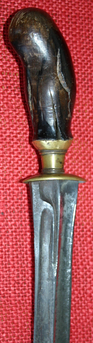

Tell me one thing ; is the base of the ukiran carved so that it fills the gold cup/selut at the base or is that empty space in there ?

Ian , I find the tip of the blade interesting ; done on purpose ?
Old 2nd April 2005, 05:37 PM   #5
Posts: 4,736
Definitely done on purpose -- quite symmetrical and ground to that particular shape. Possibly a repair?
Sorry Rick, I did not answer your question. The fit of the handle to the selut has a space that has been filled with a pitch-like material that has been ground to a precise, flush fit to the lip of the selut. Does that make sense?

Thanks Ian , now that has me thinking .
That method of assembly seems a little suspicious , so now I'm wondering if it is a composite piece .
Old 5th April 2005, 07:44 PM   #9
Posts: 4,736
Don't know Rick -- looks original to me, although an old repair or assembly is possible. The matching of the guard to the sheath is perfect, and the guard is integral with the gold cup/selut. I have not seen any others to be able to comment on whether this is a normal arrangement. Perhaps Naga Sasra could help or one of the other Forumites with more specific knowledge than I have.
Ian.
Old 5th April 2005, 08:36 PM   #10
Posts: 6,430
Hi Ian , I don't really mean to play the skeptic , but that part of the construction struck me as a little strange . If the piece were used couldn't the exposed edge around the hilt tend to possibly injure the hand that wields it ?
Maybe the original ukiran has been replaced .
/I'm still lovin' it though !

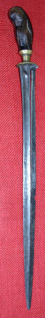

I have a sword that is virtually identical to the one in this thread. The ferrule and the oval guard are the same although mine is made of humble brass. The shape of my hilt is the same also except at the base it flairs out so that it fills the cup of the ferrule completely. The prabot on the blade is the same also. The tip on my blade has not been damaged. The double fullers ending in a reinforced tip looks like the tip on some Balinese keris. The scabbard and its attendant metal banding looks the same also except for the fact that mine doesn't have a metal chape. I don't have a digital camera so I can't post pictures but if folks at the forum think they need to see pictures of my blade, I try to borrow a camera from somewhere. I tend to think that the existence of two such similar blades indicates that they are part of an ethnographic type and not a composite made from salvaged blades. This conjecture is strengthened by the presence of the Balinese style tip. I don't ever recall seeing this feature on a Sumatran panjang. Perhaps the similarity in size and shape to a keris panjang is a case of convergent evolution where similarities in customs and fighting styles caused weapons of separate lineages to attain a similar morphology.

Here are the images of my sword. Hope this helps.

Thank you for posting the pictures. Remarkably similar sword to the one I show above. They could almost have come from the same hands. Even the scababrd style is virtually identical. I would say we have a definite style of sword and not an unusual assemblage.
Noting the wear to the wood handle on yours, I wonder whether the handle on mine might be a replacement for a damaged original (hence its different fit to the cup).
Ian.
