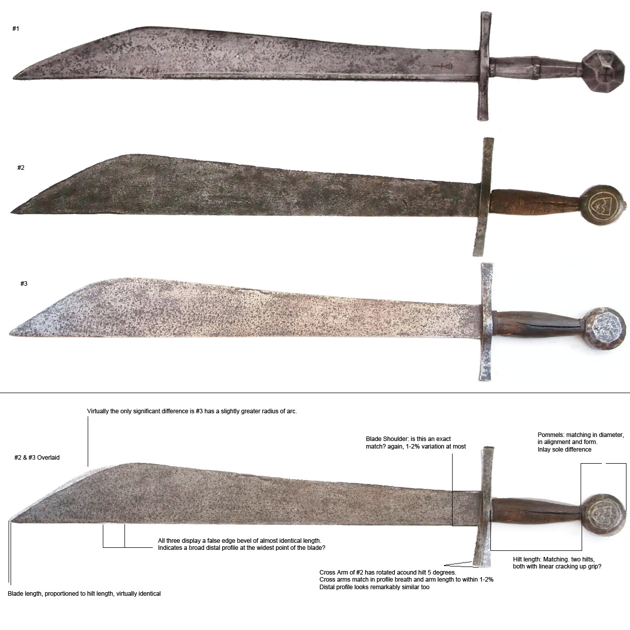

ahh. I'm not certain what the status of the Hermann-Historica example was, I was told by Carl Koppeschaar that it failed to sell after the previous auction, but I'm uncertain of any developments since.
Regarding examples #1, and particularly # 2 and #3 of the photographic samples, I cant help but feel sceptical for one reason: Similarity of proportion.
(Just to quickly explain, I used to work as a 3d artist, creating digital 3d modelling work, and its given me a particular focus in terms of observing proportion and dimension, and I spot details like that quite easily.)
Those three falchions are far too close in proportional simiarity for comfort to me. Something about #2 and #3 in particular jar my eye, because they are too similar. Comparing the invalides and delft falchions, they're clearly very similar, but only a few seconds viewing will let you see the significant proportional differences between them, the tang shape, the false edge, the curvature to the tip, and the pommels are very different.
that's a difference I'm not feeling when viewing #2 and #3. and my gut instinct is telling me there's something very wrong with them. There are too many co-incidences there for comfort. on its own, I would say one or the other was authentic. Together, no. something's not quite right there with one, or both.
If they were simply proportionally similar in one aspect, I would'nt feel there's a problem with them. but the proportions match, to within pretty close tolerances, in each area, the grip length, the pommel diameters, the false edge bevel, the blade at the tang transition, the cross shape, the cross arms length, the cross arms width... again and again, there's repeated matches there, and that making my mind flag up warnings, something's just not right there.
I'm hope I'm wrong. I hope that a fantastic and fully-documented provenance exists for each one of these, since they have clearly been stored in well-conserved conditions. these have not been dredged from rivers like the cluny, thorpe, or hamburg falchions. I'd love to trace their origins.
if I take the photographs and overlay them, you can probably see the similarities quite clearly - so I've done exactly that. I'm not sure it'll make sense, but then I dont know if I am making any sense with these.
Any further information on that pair you're able to give would be of a great deal of interest.
Regarding the Milan example, I'll ensure I can distribute a reference image and some data, and will get back to you on that - I think I'm still unable to send PMs so far.
Good point!
the similarities in proportion of #2 and # 3 are at mildly noteworthy, this is an understatement.
The proportions are quite similar, would the actual dimensions also be that consistent?
I am curious about the provenance of both of them.
certainly more than a few last years, from the existence of 600 years of these swords, must be found

I'm absolutely in agreement, that the actual dimensions do need to be catalogued carefully, its part of what I've been doing with the existing examples that I've been studying.

The similarities are indeed remakable and are a reason to be cautious. But it is not surprising for me, as I wrote in my article: `All three were of very similar shapes and dimensions, and originated from the same source.´If the source is an old armoury, it would not be surprising.
According to the auction catalogue, the length of #2 is 75,8 cm, the length of # 3 is 73,2 cm. Metallurgical analysis would be helpfull, but was not undertaken.
To find a proofed provenance for medieval arms and armour, occurs very rarely. Even if you have a provenance, what is it worth? In many cases: Nothing!
For example: A gothic full armour in a Fischer sale 2008, lot 293, sold for CHF 130000,- +Premium ( Euro 100.000,- incl.). It was described as from the collection of Max Kuppelmayr, pesumably from the armoury of Törringer zu Jettenbach. Nevertheless the complete armour was a 19th century copy! Many items from the Kuppelmayr collection are not genuine.
Or provenance Hearst collection: Hearst employed a good armourer, who even forged good medieval sallets, which were later sold as genuine.
The only way to avoid to acquire not genuine items is to examine them closely(not only on photos) and to compare them with genuine items. And experience, experience......(which includes that you have once acquired fakes).

I remain unconvinced on the pair, I'm afraid.
the fact they came from the same source, so similar is what puzzles me. This falchion type is from the 1240s through to about 1320, the lipped-point forms of your Type III begin to supercede the cleaver form in popularity from about 1300.
Which would indicate at least 2, possibly 3 if the Rothenburg example is from the same source originally, all remarkably similar. the Rothenburg example I've read on its case is described as
"Malchus (Falchion des Tempelritterordens)
Knaufvorderseite mit Kupferdraht eingelegtem Templerkreuz ruckseitig ein stilisiertes H Im oberen Teil der Klinge ein Kupferdraht eingelegtes Kreuz mit stilisiertem Auge an der Spitze
Mitterleuropa um 1300"
Malchus (Falcion of the Templers' order knights)
A copper inlaid Templer Order Cross in front of the pommel, a stilized H at the back side. A copper inlaid cross with a stilized eye on top at the base of the blade.
Middle Europe about 1300
So, assuming the same collection, we have a falchion attributed to the knights templar (and "attributed to the knights templar" is a phrase that makes me highly suspicious, much like "attributed to William Wallace"...), an item which has already had its suspicions of provenance questioned by several other individuals, and associated with this one, we have two virtually proportionately identical falchion, with matching crosses, albeit with an inch length difference.
All three of these examples have remained in exceptionally good state of preservation for the last 700 years, as a contained cluster of three items, while the rest of the falchions in europe are in scattered groups. And one of them just happens to be associated with templars, but the other two arent. why would one of a trio be like that? that feels very odd to me.
As a cluster, the three falchions feel like there are too many co-incidences all falling together at the same time. Remarkable similarities in such a small data set as the twenty or so existing falchion predating the year 1500 are going to skew the data significantly, and of these three examples, I cannot help but wonder if those remarkable similarities are a result of them having come out from the same workshop significantly after thier purported date, freshly washed down with a nice bit of patinating acid....
Furthermore, all three examples demonstrate geometry details that I'm cautious of - a noticable false edge ground bevel on their upper edge, proceeding to a deep fuller which runs along the blade without fading out.
My gut instinct reading that sort of shape is to suspect is that examples no. 2 and 3 both follow the fashion of the Rothenburg example in having a pronounced deep spine on the back edge, with little distal taper.
that contradicts the details known of the conyers, cluny, and hamburg falchions, all of which have a very thin distal profile at their widest points; in the case of the conyers, only 1.2mm thick - a feature infact that I've observed on a pretty good number of 13th C swords in general.
I cannot help but feel that those details leave this trio as highly suspect. Those "remarkable similarities" undermine the quality of the rest of the study.
As a craftsman, I rather suspect that accurate replicas of all three of these falchions may well reveal handling deficiencies absent in the conyers, cluny and hamburg examples. As a student of arms, I feel they are too questionable to be given significant emphasis.
(and I really do apologise for the criticism here. it feels like I'm ripping into your work by questioning these sources, and I hope its not coming over as such)

The description Templars Falchion is pure nonsense! The inlaid cross is a simple cross potent, which can be found on dozens of sword blades and pommels.
Falchions have not been so rare as you believe, see the dozens of depictions in illuminated manuscripts.
Hundreds of medieval European swords in not excavated condition exist in Museums or private collections. Why should there be no Falchions?
The blade of #3 has no fuller and is never too thick, the weight of the whole sword is 1.19 kg, which is relatively light for a sword with such a broad blade.The thickness of the blade of the Conyers Falchion is extremely thin. Nearly every sword blade I know has at least a thickness of ab.3 mm(not measured on corroded ones) at the center of percussion. A back edge is by no means unusual, see the attached photo with a blade without fuller and a back edge.
The fact that three swords originate from the same source does not indicates that these are fakes.
About 20 or more swords from the Alexandria Arsenal are known in western collections, many of them like peas in a pod, Oakeshott said. Are these therefore fakes?
As I have pointed out in my last post, examining a sword on the basis of photos or specific dimensions is useless without having examined it in reality. Not only theory is essential, but experience, experience!
As pointed out before, Falchion #3 is in the collection of an experienced collector of medieval arms and armour (all not excavated,except a few very early ones) who`s advice is asked around the world. If he is not able to discriminate genuine swords from fakes, no one would be able!
Agreed.
I'd have used a phrase significantly more offensive than "nonsense" myself. But then I am scottish.
But that's what the Reichsstadtmuseum Rothenburg one now has attributed to it on the information card beside it...
(edit: And I've love to know where/who the idea that it identified it as such came from. and then slap them round the back of the head!)

Regarding the attached photo, that one has rather puzzled me - after all, for a production date of 1480, it features a falchion of a type that fell out of fashion the better part of 150, maybe even 180 years earlier. its a fascinating depiction.
Regarding #3, I have a dozen examples that spring to mind immediately that are much thinner than 3mm, some corroded, some not, including a pair of examples marked from alexandria (in the care of Dean Castle, the former collectin of Howard De Walden), whose distal profiles were quite astounding to me. So I'd say that is no proof whatsoever one way or the other...
If it is indeed in the hands of a collector who is so experienced, the immediate question is, is this collector infalliable? Has he never made a mistake? I cant help but wonder what the opinion of that collector is on the odds of three samples all coming from one source, and particularly if he has any doubts about not only the one in his collection, but the other two. If you can show me one expert in any field who's never made an error, I'll show you an expert who's not done much work in thier lives. No-one should be afraid of making fools of ourselves by making errors, particularly in a field where such judgements are one of opinion. (and lets face it, by querying these three, I'm more than likely the one making the error! ).
If #3 is absolutely watertight, on the weight of opinion of one individual, then that still leaves #2 and #1 open to debate. Furthermore, what are the opinions of other experts? is one person's opinion utterly infalliable and enough? I've handled enough swords in "records of the medieval sword" and been able to spot mistakes Oakeshott made. I've handled bits in glasgow museums and been able to spot that Tobias Capwell made a mistake in the cataloguing numbers in "The Real Fighting Stuff", for instance...
We all make mistakes by being human.
That said, I'm in absolute agreement, that to consider the provenance by photograph alone is entirely insufficient.
But we have little record if its previous owners, its auction history, which collections it has passed through over time. Were #2 and #3 paired together 80-odd years ago by a collector? Were they paired together 90 years ago by an auction house and then sold together? Which auction house? Were they in the armoury of a castle, much as the Churburg harnesses were? did they just appear in the catalogues of a collector? We all know the story of the words of Louis Marcy in Paris, after all, and his workmanship still continues to appear in museums, auctions and collections - and often identified as genuine items.
I dont know the details of origin. I'm fairly sure you dont have them. Who does? Anyone?
Without this data to hand, we cannot even begin to make assumptions on origin of each one in turn. It is solely speculation, with no more academic worth than the Reichsstadtmuseum's 'templer'[sic] attibutation.
We have no metalurgical analysis of blade or cross; nor do I expect we ever will get such a destructive analysis.
we have no x-ray studies of these items, we have no neutron diffraction study of them, we have no carbon-dating of the organic components.
we have virtually no actual evidence to corroborate their likely date.
All we do have are photos that link it to a set of remarkably similar-proportioned items, in a field where finding one is rare enough. and all in excellent condition.
and those co-incidences just seem a little to good to be true.

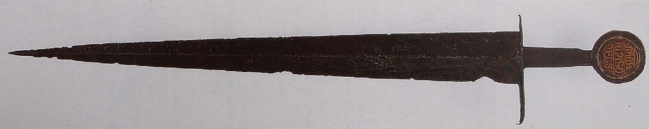

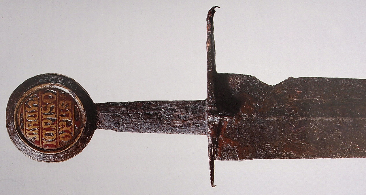

Posts: 129
For friends of provenance!
Here are two photos from an excavated sword (no Falchion), which speaks for its own provenance. It was sold some years ago by a London dealer. The sword is of the same type as the Castillon group A swords. It was also found in France. The disc pommel is enamelled and bears an inscripion and arms, which give us a name and a date. The arms are those of Pierre de Cros, Archbishop of Arles, and the sword can not date later than 1383, where he was appointed as a Cardinal.
Comments welcome!
Best

yes, Iam a friend of provenance
I expect that every serious sword enthusiast is familiar with this sword, a beautiful pommel formed outof 3 pieces and a unique Oakeshott type XVIII, " type? castillon G-A hoard blade".
The pommel is an absolutely beautiful work of art in itself with the legend Archiepiscopus and the arms of the cros family, possible to link direct to the cardinal/archbishop Pierre de Cros. the blade acts as a work of art not far behind.
If I may speak freely and open , and I sincerely hope I did not kick somebody against the sore leg.
If it would be in my possession, I would find out if the original pommel and original blade belong together or if it is later composed.
(I have no idea how to investigate this though, probably we now do need the expert eye here which you refered to in your previous post.)
Please do not get me wrong, it is only because the combination seems strange to me.
The blade seems to me outof the castillon hoard and I only would expect another pommel, as the known ones , not so exceptionally beautiful and unique.
best,
best,
Well observed !
The blade, cross and pommel are surely genuine, but do they belong together? In this case no scientific test can ever help you, only your eye can help you.
When I saw the photo for the first time, the first that struck me, were the unbalanced proportions. The pommel is too large for a single hand sword. The blade and the remains of the cross show a close resemblance to the Castillon swords, including the patination and the corroded spots. For a single hand sword of this type I would also expect a pommel of wheel type and a tang button.
Pierre de Cros was appointed as Archbishop of Arles in 1374. If we assume that the pommel was not made much later, we have a date of c.1375. If we further assume, that the sword was not the first of its type, but in fashion ab. ten or twenty years before, we have a date for this sword type c. 1355-1365.
The Castillon swords are generally dated c.1410-1450. Is it likely that half of the swords from Castillon were of a nearly one hundred years old type? I don`t think so. I believe that the pommel was assembled to a cheap Castillon sword, to increase its value. I therefore would never acquire this sword.
But an assumption is no proof. Under usual circumstances, it would not be possible to proof that the pommel was added later.
But contacts to other collectors are allways helpfull. A collecting colleague of me saw this pommel many years ago as a single item in an antigue shop in Italy. He did not acquired it, because it was too expensive. I fully trust this collector. Then this is the proof for me.
Best

thanks, here we also agree.
because the tang is relatively wide, it is likely that the pommel did not fit at once.
Then somewhere material must have been removed, inside pommel or outside tang. if this is the case, it can be seen by the eye of an expert.
The collecting colleague, is he skilled and his first name starts with an F?
