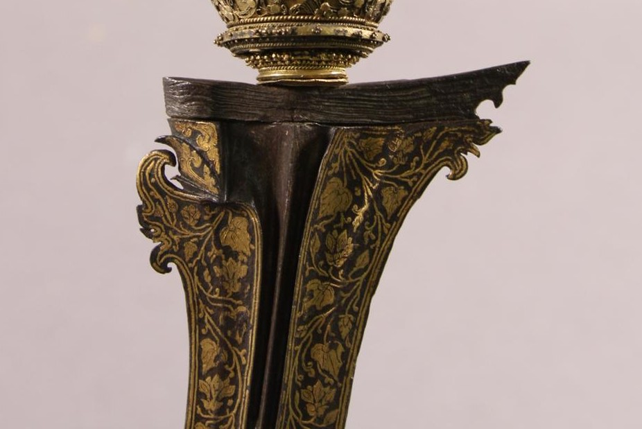

Possibly this thread could be steered in a slightly different direction: the aesthetics of a greneng.
It's easy to observe whether we like a greneng or not, but what if we look at it more objectively. What criteria should a greneng possess, e.g. what constitutes a well cut rond dha as opposed to a poorly made one - even when the latter one is aesthetically pleasing.
Do the pakem contain anything on how the individual elements of the ron dha should be shaped? I've often read that the way in which an mpu makes a greneng is akin to a signature, but I imagine that there are constraints on what he or she can and cannot do. On Moro kris we often see greneng, but these are wholly different to those in Jawa, quite possibly because no such restraints are in place there.

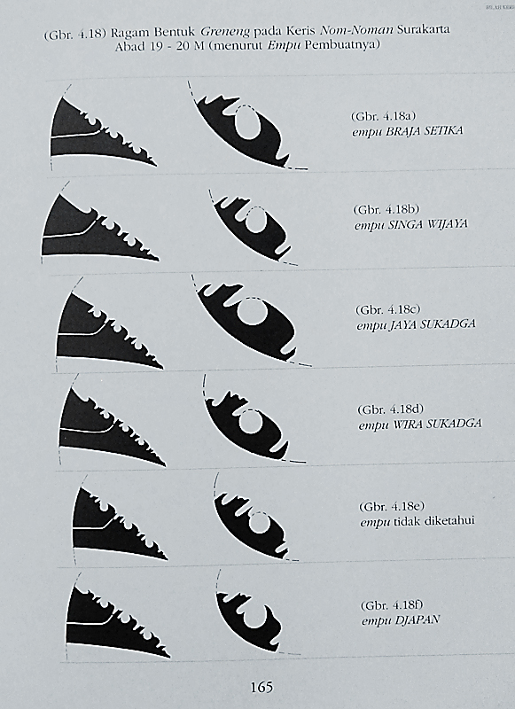

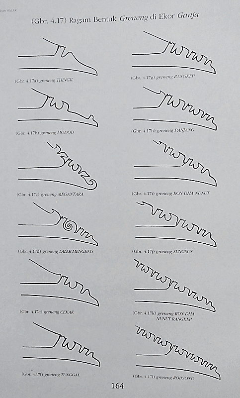

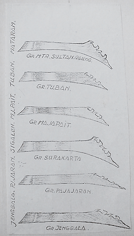

Bjorn, here are some images that will be of use.
The drawings are from the hand of Empu Suparman Supowijoyo, and have been taken from a lecture that he gave in about 1980.
The page of images showing greneng forms attributed to various empus is from Haryono Haryoguritno's "Keris Jawa".
The various forms of greneng are from "Keris Jawa" also.

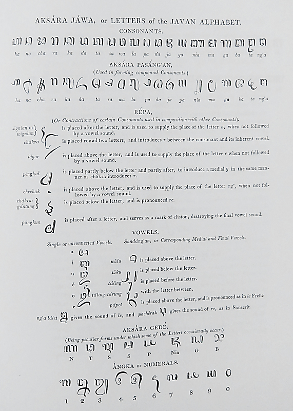

The two pages of text are from Raffles "History of Java".
In respect of the greneng forms attributed to Surakarta empus, it is not clear in the book, but in private conversation Haryonoguritno is reported as having said that in all honesty he was unable to distinguish the work of one empu from another. I have heard this from two people, who have no connection with each other. Thus, "attribute" is the correct way to look at these greneng.
As with much else --- some would say "all else" --- to do with the keris, the attribution of various forms of greneng and ron dha to various classifications (tangguh) is an item of belief. However, it is a crucial item of belief, because where a ron dha is found in a keris it is the key element in assignation of a tangguh.
But this can be confusing, because some extremely good quality keris, that have very obviously been made according to the parameters of one tangguh, can have a ron dha that points to a different tangguh.
For example, in the current era in Surakarta the two empus who began the keris revival were Empu Suparman Supowijoyo and Empu Pauzan Pusposukadgo (Pauzan rejected the title of "empu" for religious reasons, he used the designation "Pandai Seni Keris", however he was known as an empu by everybody). Empu Suparman invariably cut a Surakarta greneng, Pauzan usually made his keris in the Mataram form and usually cut a Mataram greneng, or occasionally a variant greneng in accord with his own interpretation.
Although the gentlemen of Jakarta who exercise very great control over the current World of the Keris in Jawa have decreed that we now have a tangguh that covers all keris made since Indonesian Independence, the great empus of the current era, Empu Suparman and Empu Pauzan did not recognise this. Empu Suparman made Surakarta keris, and although this concept of "Tangguh Kamerdekaan" did not come into being until after his passing, I can assure you the very idea of this would have horrified him, he was dedicated to Surakarta. Empu Pauzan made Mataram style keris in the Surakarta era, and as with Empu Suparman, was a Surakarta Karaton Empu.
When we move outside of Jawa we find that the greneng of keris from other areas is often just notches that have no meaning at all. Because of this, and for other reasons, many old-time traditionalists in Jawa would not recognise that these "keris" from other areas were in fact genuine keris, these other "keris" were merely keris-like objects that had been made by people who did not understand what a keris truly was, and the people who carried these keris were simply trying to copy their betters without understanding anything. They were in fact children who had not yet learnt anything.
Now, it is important to understand that this was a very Java-centric attitude, but it did reflect the mindset of some people:- the Keris was holy, these imitators treated it as profane. They had no understanding.
The key to the greneng is the ron dha.
Common belief is that the form of the ron dha is a representation of the Javanese letter dha, and the various forms of the ron dha reflect the form of the letter dha at a particular time in history.
The word "ron" means "leaf" and is Krama for "godhong". It refers to the lontar leaves upon which traditional writing was done and by extension to the letters written upon those leaves. The Javanese letter "dha" equates to "d".
Aesthetically a greneng should be cut so that it appears to be identical when viewed from each side, it should reflect the true form applicable to the classification, where a feature is repeated it should be identical to the other feature, for example, if a greneng has two ron dha, each of those ron dha should be absolutely identical.

In Old Javanese the word 'ron' still means 'leaf', but the word 'dha', which in Modern Javanese is only taken as the name of a letter of the Hanacaraka alphabet, and a plural marker that can be considered as synonymous with 'sami' or 'padha', has a distinct separate meaning.
In Old Javanese the word 'dha' can be understood as 'good', or as a 'call', 'cry, 'exclamation', 'appeal', dependent upon context.
So if we consider "ron dha" in an Old Javanese sense it has an entirely different meaning to that which applies in Modern Javanese. But this Old Javanese meaning is still a euphemism --- although a euphemism that is much closer to reality than the common idea of 'letter dha'.
Then we have the relationship between Old Javanese letters, especially those used to write Kawi (the Old Javanese literary script), and Old Javanese numerals.

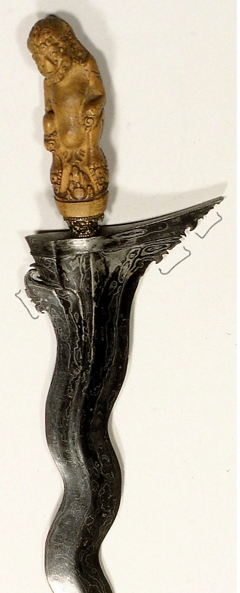

I am very much intrigued by this thread. I've gone to my two krisses and inspected the grenengs minutely. My Javanese kris has two identical ron dhas, but the Bugis kris seems not to have even one.
I suppose the clarity/readability of the greneng message can get reduced by age & honest wear, just like a set of letters which have become worn.

Hello Alan,
As a collector and classification maniac, I learned 2 important issues from your post:
. The drawings from Empu Suparman showing the differences in the shape of the gonjos and greneng for the various tangguh is an unique information that I never saw in any book.
. I did not realize that the ron dha (when presnt) was such a crucial tangguh indicator, from memory it is not mentioned in the EK and not clearly in the book KJ.
Thank you again!

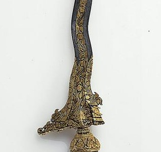

With Greneng of Megantoro I mean a variation of Greneng, as seen on this blade, which possibly is the best preserved M in existence.
Another, perhaps somewhat related Greneng variation is found on Dresden Inv. Nr. 2895.
Also on this blade with replaced Gonjo (so only the Greneng part on blade itself is of importance). Because of the style of Kinatah and Blumbangan I think it is quite older then Sultan Agung.
Of course these all could be younger forms of Greneng (younger then 1525, but barely made after, say, end of 17th cent.), I never (until now) have seen these variations on Keris Bali, also no Megantoro there.
Regarding Jenggot, I probably have misunderstood you. I suppose, if an early Keris had Kembang Kacang and Greneng, there almost automatically was also Jenggot on KK, mirroring the Greneng (the only exeptions I can think of would be Sempana type blades, but I have seen better preserved specimens with small Jenggot).

Thank you for posting this photo Gustav, here we have a very good example of what happened when the keris became profane under Islam.
In this keris that you have posted a photo of, we cannot comment on the greneng, because of the replaced gonjo, we can only comment on the ron dha nunut.
The enhancements that occupy the place of the ron dha nunut and jenggot on this blade are very clearly not related in any way to the ron dha of the early Modern Keris within Hindu-Buddhist society. This was one of the things that happened when the keris was adopted for wear by people who did not understand the cultural significance of the keris, nor its symbolism --- or perhaps they did understand, and intentionally moved away from this. Let us not forget that Demak was established by a prince of Majapahit.
I agree that this keris you have shown us is probably older than the first half of the 17th century. This is a North Coast blade, very possibly classifiable as Banten, and it demonstrates very nicely the point that I made in respect characteristics associated with the Hindu-Buddhist belief system, however, those features in this keris have been distorted.
Dresden 2895 can be seen in Jensen's Kris Disk, chapter 3, page 22. This kris has its original gonjo and is an excellent example of the early Modern Keris under Islam. Jensen measured it as 41.8cm, I measured it at 42.4cm. It has a single front sogokan and in respect of the greneng and ron dha, I noted that they were "very confused". In any case Dresden 2895 is a big keris, in the hand it is very similar to a Bali keris.
This confusion in the formation of the ron dha and greneng is not uncommon in keris from this period. We can only guess why this happened, it could have been intention on the part of either the person who ordered the keris, or of the maker, as a movement away from Hindu-Buddhist symbolism, or it could have simply been a lack of knowledge of the true form required. In any case this distortion of the ron dha is not uncommon and Gustav has given us a very good example of it.
These corruptions of form are most definitely not younger forms of keris enhancement. They are clearly, obviously and logically demonstrable corruptions. They do not appear in the Bali keris, and that tells us exactly what they are.
There is a slight problem with the naming of Gustav's example as dhapur megantoro, but this is not really an issue, its just a name.

regarding the Greneng variation I presented, I don't think it is as simple as "They are clearly, obviously and logically demonstrable corruptions. They do not appear in the Bali keris, and that tells us exactly what they are". This Greneng appears on a very small number of Keris, and they all are older then first half of 17th cent. After that this variation disappears. Speaking of myself, I haven't seen many Keris from Bali, which could be somewhat supportably datable as older then perhaps 18th cent. We have much less reasoned to say on subject older Keris in Bali then we have regarding older Keris in Java - and that isn't much.
This variation of Greneng clearly don't fit in your hypothesis, but I am not sure, if it is a reason enough to deem it as a corruption from Islamic period.
It consists of two identical elements with a Ron Dha in the middle. That element is repeated on Jenggot. Stylistically I don't see any confusion there.
That variation we also see on a Keris from Munich Inv. Nr. Gr. 598, which is much less known, because Jensen probably wasn't aware of its existence. The age of blade is, as always debatable, but I have difficulties to see the hilt of it in an Islamic Kontext.
