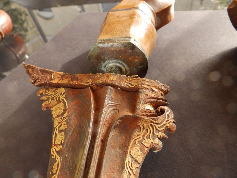

Sometimes we encounter a Selut/Mendak construction on Bali Keris, which consists of a stem and a cup. Some questions about it.
Is it an older style, which perhaps had an integrated ring, like South Sumatran Selut or slightly similar constructions from East Java?
Was this style typical for some certain regions in Bali?
There are some older Uwer rings with a short stem. Would they have been parts of such stem/cup construction?

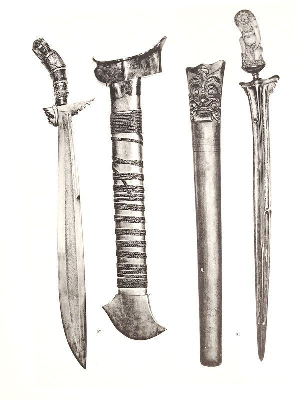

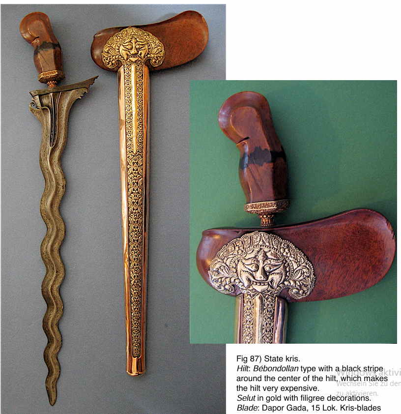

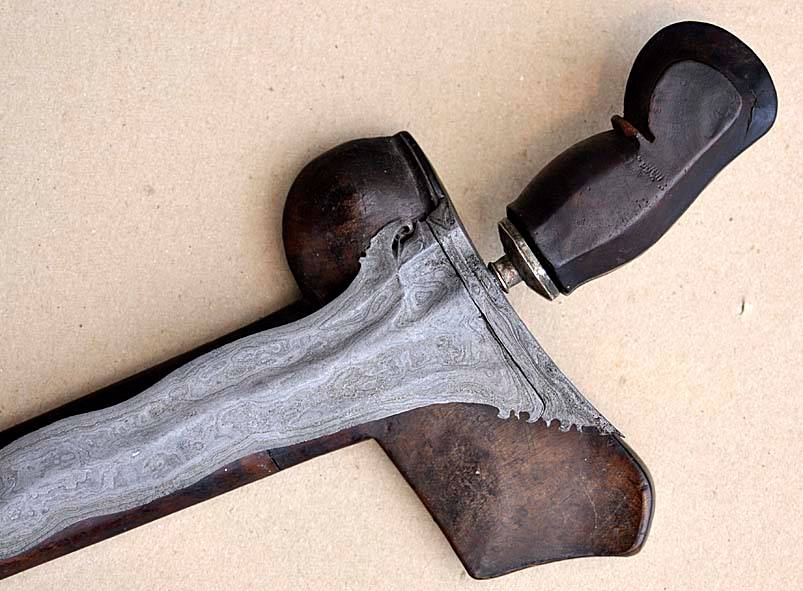

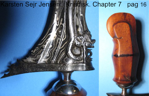

There is a Keris in Jensen's Krisdisk, which I at the beginning thought is a bit strange, with parts of perhaps different age and provenance mixed together.
Some time ago I came across a Keris with similar stem/cup construction, and by chance it has a similar Pendok. The whole thing is most likely from East-Java, but perhaps from Balinese people there, judging by the blade and Kinatah on it.
Then there is a picture of a Sunda(?) Keris, but the fit of hilt and Selut is poor, and the look of that hilt is recent or refurbished.

Balinese keris hilts that have a selut-like fitting or a cup that encloses the lower end of the hilt are not uncommon, what is uncommon, to the point of not being known by a couple of very experienced Balinese collectors is one of these cup type fittings with a longish stem.
I think enough examples of this fitting have been posted to verify that the fitting did exist at some time, & in some place, in the past, but we might have a bit of difficulty in nailing down exactly when & where.
One thing that is of interest in the photos in post #6. The lighter coloured sarung is a jejamprahan form, in olden times, this sarung form was the prerogative of people who were priests or religious leaders, & it needed to be paired with a kusia hilt --- a hilt form that was also the prerogative of priests & religious leaders.
The hilts in the photo posted are not kusia, they are bebondolan of the South Bali form. The bebondolan hilt is the common man's hilt used for everyday wear, it was improper to pair a bebondolan hilt with anything other than a batun poh or kajongan sarung, further, no common man could legitimately use a jejamprahan sarung.
The darker coloured sarung in post #6 is a kekandikan form. In olden times the kekandikan sarung form was the prerogative of rajas & nobles and it could not be paired with a bebondolan hilt. In modern times the kekandikan form is classified as a formal type of dress, only for use in formal or official circumstances, say, something like a wedding, or maybe attendance at a governor's party. Again, as a keris intended for formal wear, a bebondolan hilt should not be fitted. A kekandikan sarung should never be paired with a bebondolan hilt.
So, if we look at these keris & the way in which they have been dressed, in spite of the fact that they both show some age, the fact of the matter is that they are both dressed inappropriately for use in Balinese society, either in the past, perhaps prior to WWII, or in the current era.
If I see something like this, it does raise questions in my mind in respect of the authenticity of presentation of the keris concerned. Collectors & dealers have been playing around with keris from everywhere for a long time now, so if we see mismatched examples of dress it should automatically raise the question of where this keris might have been dressed.
In respect of post #6, the keris shown as "State keris Fig 87". Jensen names the area of origin for this keris as Bali/Blambangan, the Blambangan Kingdom ended in the 18th century, this area of far east Jawa is now the Banyuwangi Kabupaten. So what Jensen has said is that this keris is a "State Keris" from either Far West Bali or on the other side of the Bali Strait, Far East Jawa.
The dress of this keris does show Balinese influence, but it is very certainly not Balinese dress, it is Jawa/ Madura dress for people of Balinese descent.
Another thing it is not is that it is most definitely not any sort of "State Keris". It is the keris of a man who had no claim to either noble descent or royal descent, in other words, a keris that is dressed for use by a common man, but surely a very wealthy common man. There are several things about this keris that cause me to speculate that the entire keris might have been put together & then sold into Europe by a very well known Surabaya dealer who used to live in Jalan Ngagel Tama. I will not mention his name, he has moved to the Hidden World a long time ago.
If we look at Post #8, image showing Chapter 7, P.16 of "Kris Disc" , we are again looking at a "State Keris". This is not a "State keris", it is a keris for the common man, parts of it have some age, but parts of it are much more recent enhancements. Originally this would have been the keris of a man from the middle ranks of society, but with no claim to royal nor noble descent. It has had the dress upgraded from its proper style into a style that would permit a higher price tag & that would be more appealing to a buyer from outside Balinese society. As it is now presented, it has the earmarks of a dealer's montage. Again, possibly from Ngagel Tama, Surabaya.

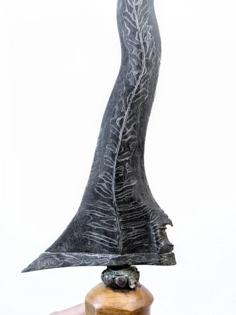

Regarding the "Kekandikan" from #6 - it seems to be a form from the island if Java, and could share a common ancestor with Balinese Kekandikan. I never was completely sure if that form is from Sunda or East Java. Perhaps and most likely both.

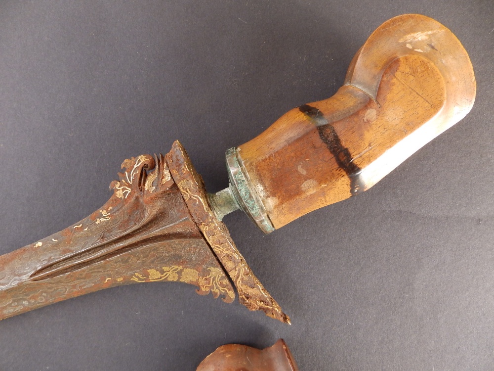

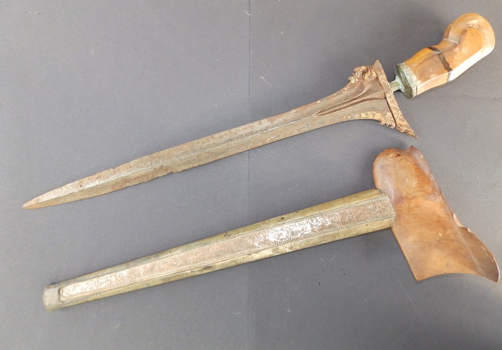

I have one specimen, which is pre-1850 and
could be pre-1800. The Gandar is tapering and fluted, Kruwingan going almost until the tip. There is a name Salempang being attached to this sheath form in West Java, but I have no possibilities to check it. There can be found a name for everything, of course. Hilt is unusual too, a similar hilt is depicted in a photo of Raden Adipati Aria Wiranotokusumo.
Related sheath forms we encounter also in Central Java.

The complete keris that you have shown in post #11 looks to be a mixture of component parts, I cannot relate it to any other keris I remember having seen.
Is it possible to detect a location of origin for the blade of the post #11 keris?

Alan, yes, it differs from Balinese Kekandikan for sure, as differ the Central Javanese forms. But I am absolutely positive, that the sheath form shown in #6, which you called a Kekandikan, is of the same form as the one in #11.
My specimen as a whole was in Europe before 1850. The sheath parts belong together, and the sheath is original ensemble with the blade, which has sunken in a bit. It came together with the hilt, which has the same amount of patina, and likely is from the same region.

The blade has some Pamor Akhodiat.
And an interesting detail of hilt - it is triangular, the top pentagonal.

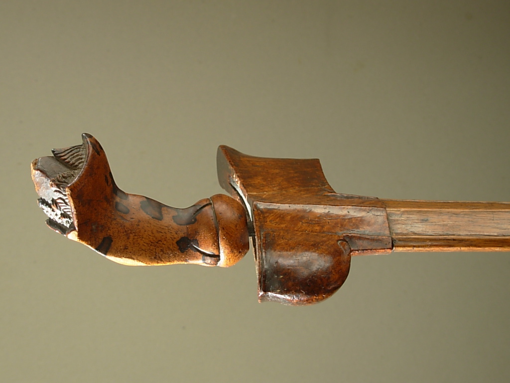

Here is mine, it looks like it had a stem cup selut before itwas removed by a previous owner, the blade is from java. I was told that the the entire wrangka set originated in west java.
I also attach another keris that features a pendok +topengan similar to mine and a bebondolan like hilt from the met.
And also another keris that i came across a few years ago with a similar pendok, but no stem cup selut.

The middle one from previous post was given to MET in 1932, after owners death, so I doubt it also would have been put together by dealer from Jalan Ngagel Tama.

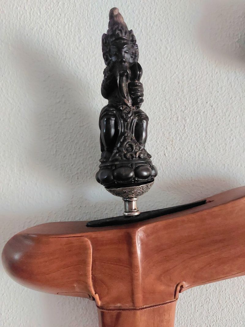

I am sorry, but I don't believe the "Kekandikan" Wrongko from #6 and Wrongko #11 from my collection are made in Bali or Lombok, and in my opinion they are made in West Java or Pasisir. Why?
Both Gambar have a quite long neck. Such neck is absolutely atypical for a Balinese Gambar.
The front part (the Gandhik side, if Keris would be in Wrongko) is similar to Balinese Kekandikan, but also to older Pasisir forms, - the back part, the "axe", is completely different - it is concave and has an angle, which also is absolutely atypical for a Balinese/Lombok Kekandikan.
Attached pictures of Wrongko from #11 besides a regular Lombok Kekandikan, Gambar from #6 and #11, and a picture of Wrongko from #6 together with other Pasisir Keris from that collection.
Apparently this kind of Wrongko is made in West Java or Pasisir again, attached a recent example, and one, which is recent or refurbished older one.

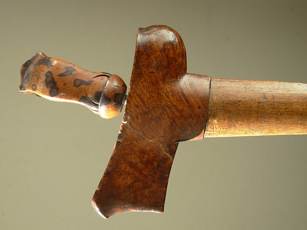

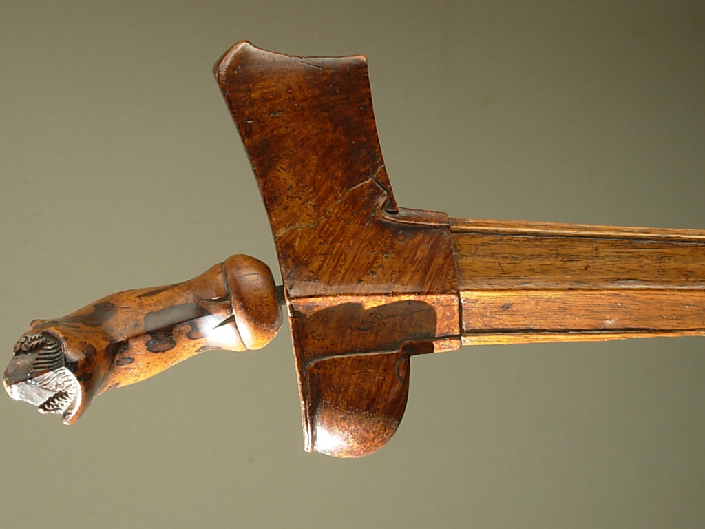

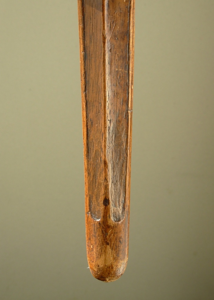

The longish gambar extension is not unknown in Balinese wrongkos, but it certainly is not common. I have seen & owned a few Balinese wrongkos with a longish gambar extension, I tend to think that most of, if not all the ones I have seen were most probably Bali-Lombok.
So now we have a Balinese form of wrongko that has been made & used somewhere else. You have offered West Jawa & North Coast Jawa as possibilities. That seems to me to be a reasonable hypothesis. All we need now is some sort of solid evidence that this kekandikan form was used by Javanese or Sundanese people.
I do not know the norms attached keris wear in Sunda, nor in North coast Jawa, but I do know the norms that are attached now, & in the past, to the wearing of a keris in Central Jawa. If this form of wrongko were to be worn anywhere, who do we think might have worn it, or for what type of wear would it be suited?
When we think about wrongko forms, both in Jawa & in Bali, we need to relate the form to the person who will use it and to the occasion where it can be worn & cannot be worn. It is not just a matter of personal preference. Thus, when we encounter a wrongko form that is not able to be fitted into the rank/occasion matrix, we are left with questions as to just how legitimate that aberrant form may be. On the very few occasions when I have seen a wrongko in use that does not fit the rank/occasion matrix, that wrongko was being worn by a Chinese businessman.
Since the mid-18th century the keris in all of the Island of Jawa has occupied the place of an item of dress, so all forms of keris dress need to be associated with either a particular societal rank, or a particular occasion for wear. Where do we think this particular form of wrongko might be acceptable for wear & by whom?
When you do comb the bigger data bases, if you find that you can provide answers to my questions it would be much appreciated.

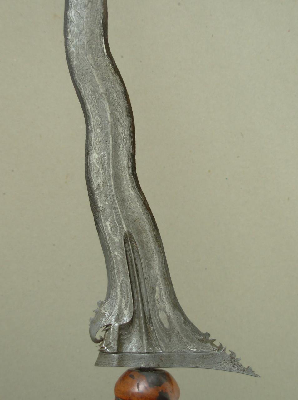

One last question. The Singapore keris. Is the Singapore keris the 7 luk blade with kinatah & an ivory hilt & Ngayogya pendok?
If so, why do you think it is a Javanese interpretation of a Balinese form? To me, this keris seems to be classifiable as condong campur, & tangguh PBX. The greneng is a variation, certainly, but a keris of this quality would have been produced to specific order & in such cases the client has the freedom to specify whatever he wants, & the higher up the pecking order, the greater that freedom was & still is.
This raises another question, a couple of these Jawa kekandikan have pendok fitted, those pendoks appear to be Ngyogya pendoks, the hilts also appear to be Ngyogya.Perhaps Ngyogya might be worth a closer look. But then it becomes a bit difficult to relate Ngayogyakarta to Sunda & the North Coast.

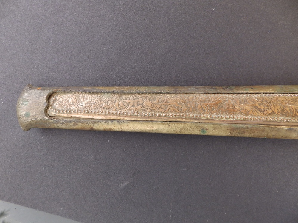

In respect of green kemalo (enamel) this does not indicate a high rank, it indicates a middle rank, that of mantri.
