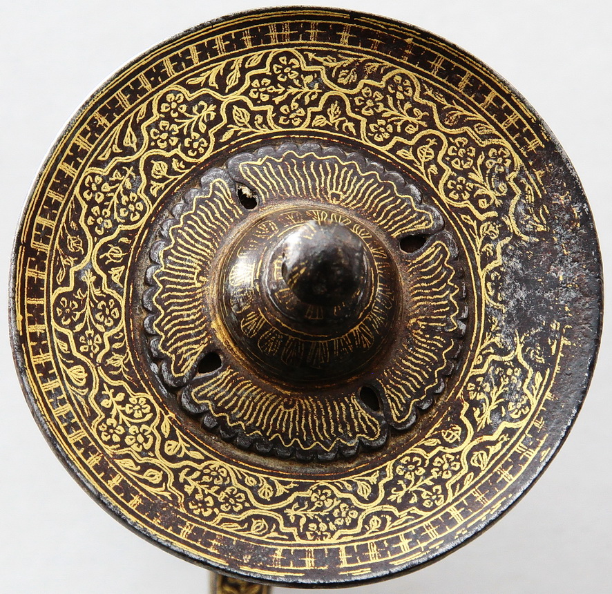

Default The floral decoration and hilt disc motif on tulwars
Could someone interested in researching, not help out a bit, and please start a research on the flowers on the tulwar hilts?
A lot of hilts/flowers are shown in my latest catalogue, so this could be a starter.
At the moment I cant do it myself, as I am wound up in researching some katar types, which I believe belong together, but I yet have to prove it.
What I know so far is, that they are from Rajasthan, ande the age seem to differ. They are shown in old catalogues, but the place of origin is avoided, and so is the age. So I will have to dig deeper to find an answer.
It would, however, help if someone will take the task to start looking into the flowers on the tulwar hilts - so we can move a bit farther than we are now.
Jens

Thank you so much for bringing up this topic Jens!
This is something we have talked about for years, that there seem to be far deeper purposes and meanings beyond pure aesthetics in the floral and vegetal motifs in these hilt decorations.
While many may disagree on hidden symbolisms in such decoration, I am inclined to think these must have been present. In "Hindu Arms and Ritual", Robert Elgood beautifully addressed the many ritual and symbolic aspects of all sorts of flora with respect to preparation for battle, insignia and auspicious representations.
I am hoping others will agree and join in revisiting this important topic, and share thoughts and ideas on floral symbolism in Indian arms.

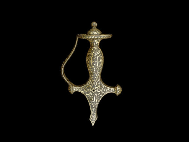

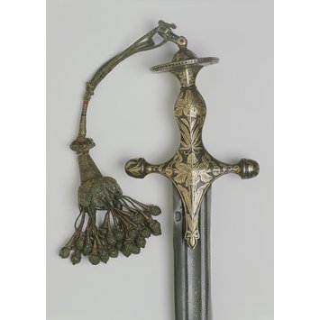

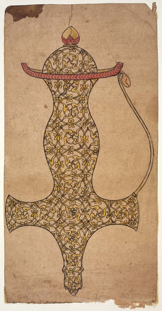

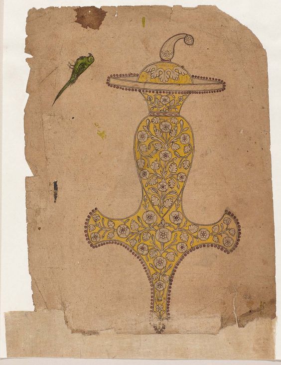

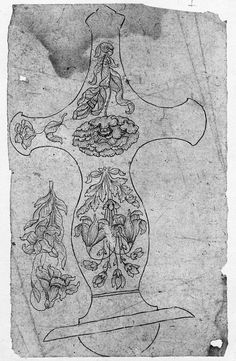

I have some sketches with flowers on...and pictures.

More...

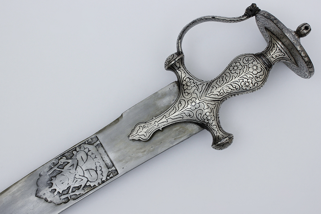

Ibrahiim,
The drawings/hilts you are showing are very interesting.
The dravings were often used by goldsmiths to show to customers, so they could choose a decoration for their hilt.
Illustration no 7, have a look at the middle hilt and compare it to the one I show in the catalogue pp. 303-306. These two hilts must have been made at the same workshop. Ibrahiim do you have a better picture of this hilt?
Jens
Jens
I dont have your catalogue reference so I dont know... I take it you mean the #4 sketch?... I am in the UK in a few days and will try to get your catalogue. ...

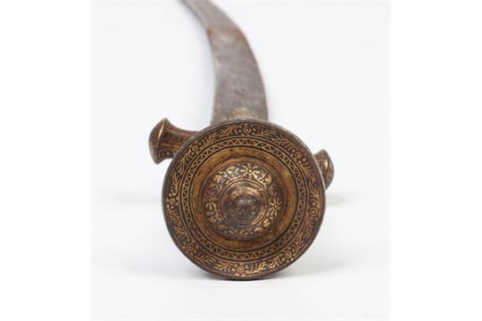

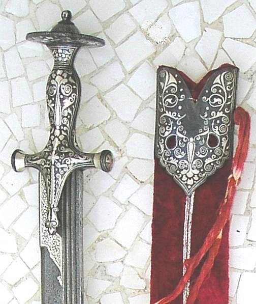

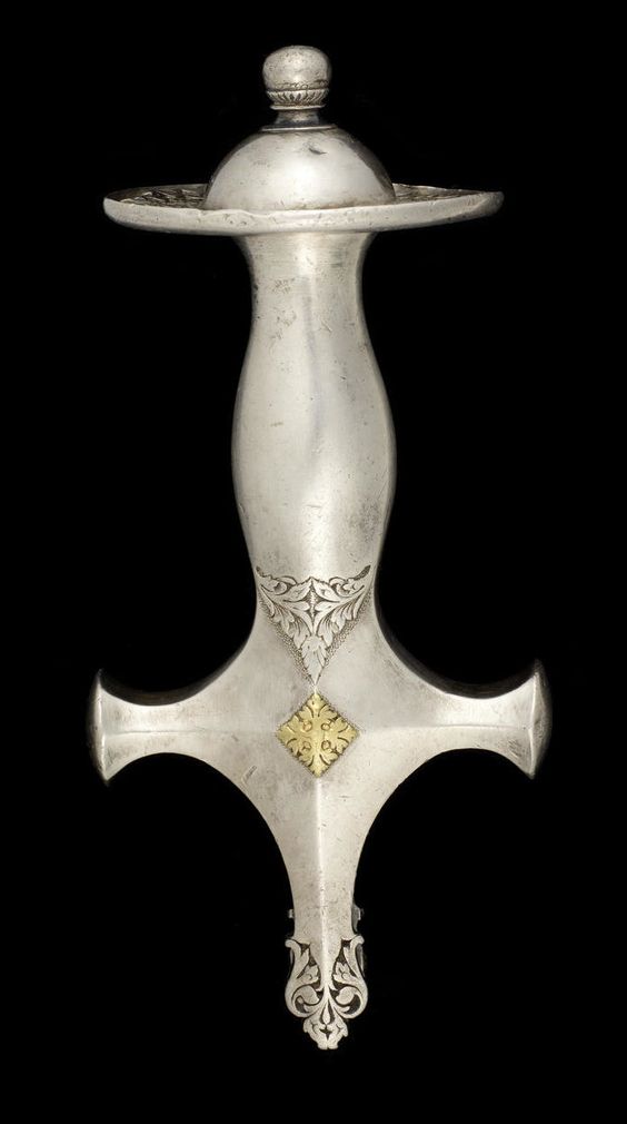

Ibrahiim,
I mean the hilt looking like the attached.
Old 30th October 2016, 03:25 PM   #10
Ibrahiim al Balooshi
Ibrahiim al Balooshi's Avatar
Join Date: Jul 2006
Posts: 4,408

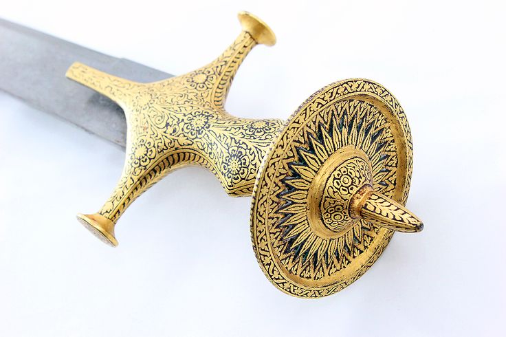

Ibrahiim,
Salaams, It is amazing that I have posted one so like yours except mine has a Knuckleguard... I will search to see if there is a better picture meanwhile a few more ...This Tegha has a Tulvar hilt and interesting floral decor whilst on a black background; a Tulvar hilt covered in Script except for a single small flower between the Guard.
The name Tul(var) means flower...and the Afghanistan version is Pul(ouar) . Does this refer to the abundance of floral decoration or give rise to it? On the other hand may the design of the flower shaped pommel have any relation to the hilt/sword name?
Ibrahiim al Balooshi.

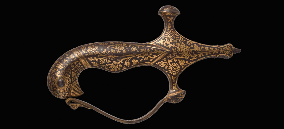

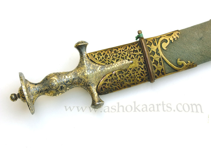

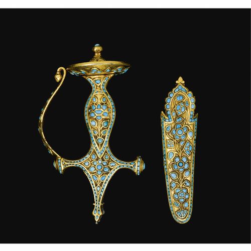

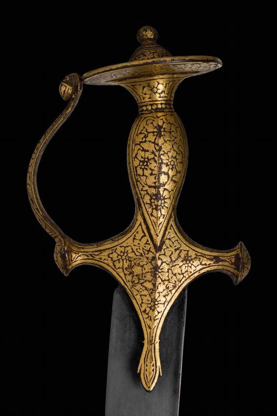

Some more...The black background from the Caravanna Collection:
Quote"17th Century
Western India - Gujarat, Mughal period (1526-1858)
Steel, gold
Height 18 cm
Tulwar hilt dated to the 17th century, shaped as a bird dated from the 17th century with a hand guard forming the profile of a swan. The entire surface is covered with floral motifs, engraved and inlayed in gold, in the koftgari technique.
Bibl.: Jawaant, 2005, p. 83; Nath Pant, 1978, vol. 3, est. CXX." Unquote.
I note that the swan neck finial of the knuckleguard is almost exactly that of the Afghanistan swan neck...

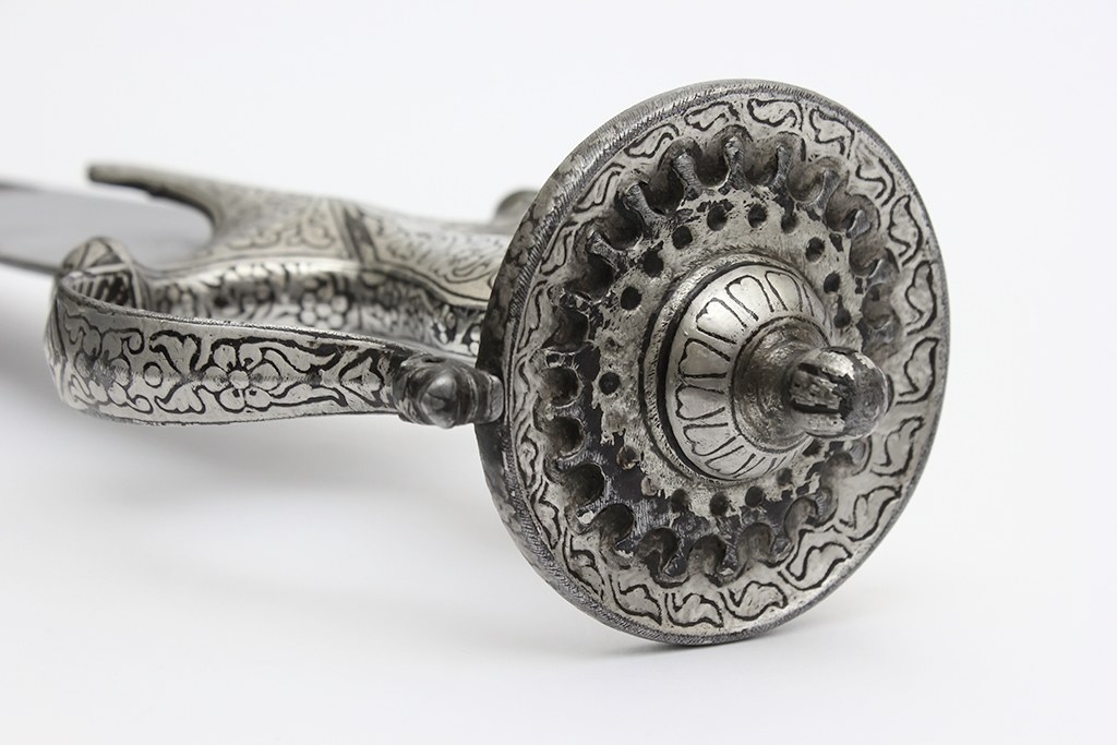

Yes the decoration of the hilts is interesting, and varies from place to place and from time to time according to fashion.
However, what I was thinking of was the flower on top of the disc. Either it is a flower or a sun, or missing all together. I think this is a better pointer than the floral decoration of the hilt.

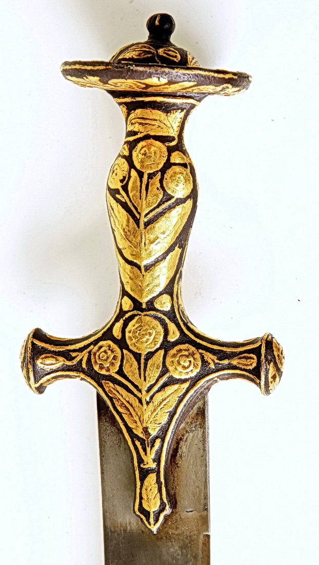

Sorry Richard, I overlooked you mail at first.
Having the head filled with flowers - the right side with roses, and the left side with tulips - I am sure Ariel will understand my stress:-).
You you are right, we did discuss the flowers on top of the disc, but although I find this very interesting, and research should be done, someone else must do it, as I have only one head and two hands, and I have started to research some katar types, which I have wanted to research for a long time. The research is slow, as not much is found about them, and the informations to have, seems to differe quite a bit of for how long time this katar group was used.

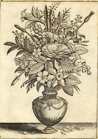

After posting the notes from the article by Stephen Markel, and seeing that apparently in degree, floral motif was used as a dynastic leitmotif by the Mughals, from the time of Shah Jahan onward, it seems that aesthetics also were largely in play.
While Persian poetry and art as well as of course many cultural factors were prevalent in Mughal courts, it seems well established that European influence was also well known and apparently from the 'herbals' of 16thc among such influences. In the attached article from the British Museum,
"Mughal Flower Studies and Their European Inspiration" by J.P.Losty, these cases are discussed, providing insight into aspects of these influences.
It is noted that while the herbals from Europe were primarily from a botanical, rather than aesthetic point of view, it does seem that a certain degree of the character of the illustrations did become notable in Mughal art.
One reference is to the "DARA SHIKOH ALBUM" which is cited as one of the most important artifacts in the museum library.
Dara Shikoh was Shah Jahan's eldest and favorite son (1615-58) who compiled these floral references.
Included is an illustration (attached) of a prince in Persian costume by the 'mysterious' artist Muhammed Khan noted as possibly from the Deccan and engaged by Dara Shikoh when the Emperors court was in Burhanpur in 1630-32.
The arrangement in the vase appears taken somewhat from an Antwerp publication of c1590 (attached) reflecting this influence.
While these references pertain the art in paintings, they were of course the source for floral images which would occur on the hilts of weapons. In the case of the Mughal interpretation, the mix and match assortment of such floral arrangements were not suitable for such motif, however individual flower images were selected and became studies for decoration.
Again, the focus here is on the Mughal decorative motif may be regarded as prevalent on tulwars as they are of course known mostly in that context, it is more difficult to relegate such motifs to Rajput, Sikh and other situations.
I hope this will offer some insight and ideas toward further research on this topic. Please see the attached link below to the full article I noted by Mr. Losty.
File Type: pdf Mughal flower studies and their European inspiration.pdf (698.2 KB, 6770 views)

I suggest that since this excellent thread is nowhere near complete that it be given the traditional Forum Bump ! bringing it into focus for further research and comments.
In particular the mystic nature of this hilt artwork and its importance across the entire range of Indian weapons. In fact I would have preferred its tittle to have been all encompassing perhaps netting in the entire conundrum as Talismanic and Mystical Artwork of Indian Weapons; down the ages, or Indian Bladed Weapons; Mystical and Talismanic artwork. Or something similar so that the subject can have a full airing.

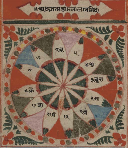

Please see; http://www.columbia.edu/itc/mealac/p...talismans.html
I have selected this North Indian design as it struck me that its circular pattern was reminiscent of the large disc atop Tulvar Pommels ..It is typically in Indian script and follows the geometry of such weapons ...whilst conveniently it is part of a treatise on Talismanic detail.

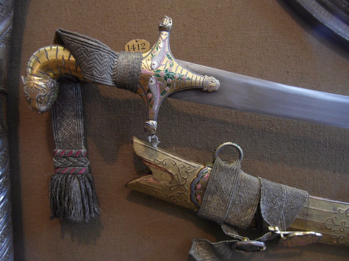

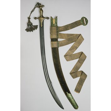

Here is an interesting sword! Of particular interest is the floral decoration which may be relevant to the thread..
Do these floral designs have a Talismanic/ secret meaning?
Please see http://collections.vam.ac.uk/item/O1...-shikoh-sword/
Quote"The very fine watered steel blade of this sword is inscribed on the back of the blade with a Persian inscription inlaid in gold stating that it belonged to the Mughal prince Dara Shokuh (1615-1659), the son and preferred successor of the emperor Shah Jahan (r. 1628-1658). The verses may be translated as: 'This sword (tigh) of the princed called Dara Shokuh/Takes care of a thousand enemies at one go'. When Shah Jahan fell ill in 1658, another son, Aurangzeb, usurped the throne, had Dara Shokuh killed during a fierce war of succession and declared himself emperor with the title 'Alamgir.
The blade is also inlaid on one side with a gold parasol signifying its royal ownership. The sword must have been made in a court workshop, perhaps in Lahore which was a traditional centre of weapons production. A date is stamped on one side of the blade near a forte. The third digit is indistinct, but is probably '5', making the date 1050 AH, or 1640-41".Unquote.

In addition please see http://blogs.bl.uk/asian-and-african...spiration.html alluded to by Jim McDougall in an earlier post...
