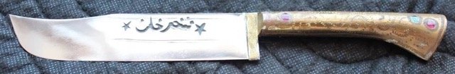

Any central Asian knife fans here? I have a small collection of Uighur, Uzbekistan and Kazakhstan knives that I am rather fond of. The Uighur knives especially. I’ve attached a few photos. I got hooked after buying a large knife (the one with "Otkur" on the blade) that almost looked like a Bowie knife. There were differences though and the most troubling was that it had both Chinese and Arabic on the blade. I had to find out more. A web search turned up this trip report, which really got me hooked:
http://www.bladeforums.com/forums/sh...93-trip-report
I am amazed at how few collectors have even heard of the Uighur people, much less own one of their amazing knives. I have come to the conclusion that they are the knife world’s best kept secret. Comments welcome and appreciated.

There is a burgeoning knife industry in Xinjang, especially in Yengisar. Chinese authorities don't like it very much, because of several recent incidents whereby Muslim Uyghur separatists, armed with knives only, conducted mass attacks on Chinese civilians, police and even soldiers. However, souvenir industry is flourishing there. All of your knives are from that area, and are mostly souvenirs: the chain attached to the blade is the best proof. Most of the examples are "fantasy" items, and have very little to do with the traditional weapons, whereas some follow old ethnic examples, but add modern features.

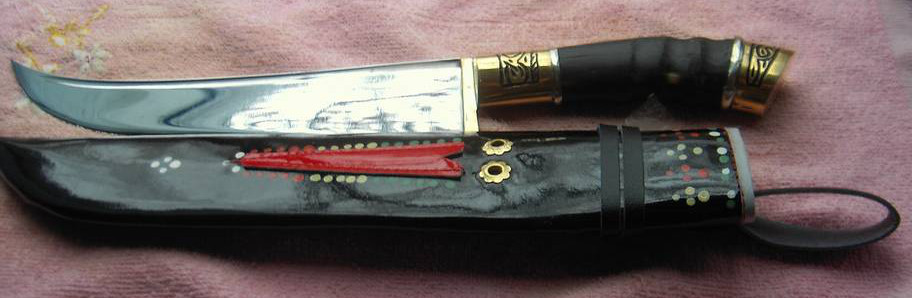

Here's my pichok from Uzbekistan. It's completely brand new. Two stories to share about it.
1: I was showing a Central Asian fellow my sword/knife collection. He didn't speak much English but he seemed to know a thing or two and enjoyed seeing my collection. I showed him this Pichok, he glanced it at and said "junk" and went back to playing with my other sword. I asked him why, and he pointed to the back of the blade where it met the bolster. he seemed to indicate that it should be curved, like yours, rather than straight like mine. The fact that it wasn't indicated it was no good.
2: I struck up a conversation with an Uzbek man at a bar and mentioned I had a pichok. Long story short, he said they were made of junk metal and he'd never use one.

Generally, he was correct: anything made by a multitude of mom-and-pop outfits for souvenir purposes is likely to be junky.
There still are real and acknowledged masters in that part of the world, who make first class examples, but they are few and far between.
That being said, I am wondering whether your bar acquaintance used the same criteria as the old native users: yes, the blades are soft and the edges turn relatively easily, but that was local preference. Soft blades did not break easily, and that was what the shepherds wanted. And there was no lack of ceramic pialas around:-)

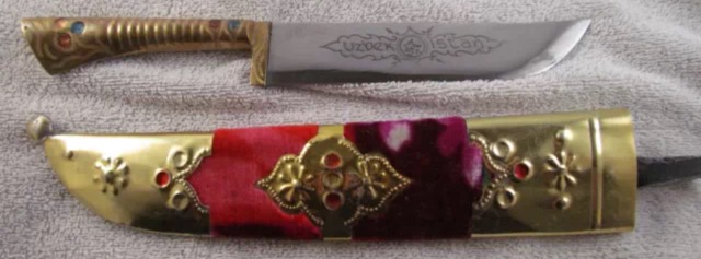

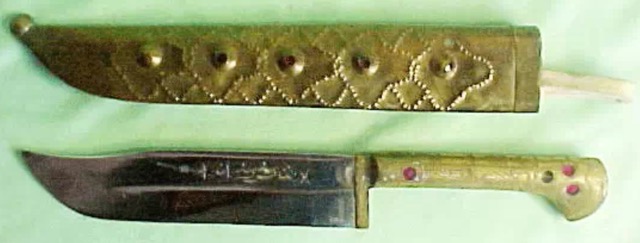

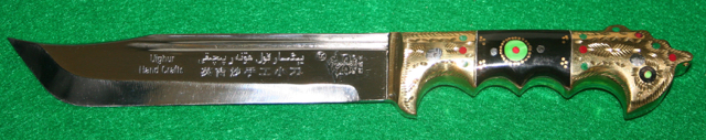

No doubt. There is a huge difference in 'stan' knives and Uighur knives, and even an amateur like myself can easily tell them apart. The Uighurs knives often come with a sheath, a hand-tooled leather sheath that was custom made for that knife. The 'stan' knives are hilarious. Campy and fun, but not worth a second look. And the Uighurs finish both sides of the knife. Typically the 'stan' knife makers follow the time honored Islamic knife making habit of only decorating the 'seen' side. Don't get me wrong - I don't mean to pick on the 'stan' knife makers. I have a few of those and I am quite fond of them. Some are quite nice, some just campy enough to be fun. Photos attached.

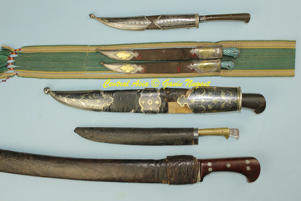

A Central Asian knife fan here.
Here are some of my antique examples for viewing...others are hidden away here too, more on those when I locate them.

Nice scabbards:-)
How about baring the blades?

I'll save further naked images for individual threads when time permits.
