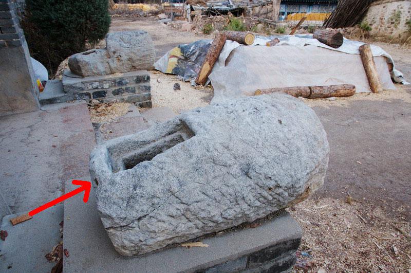

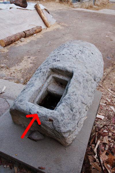

A curiosity from ancient China: A stone cannon of the Ming Dynasty at Shanhaiguan Great Wall Museum

Curious it is, no doubt; fantastic? Possibly ...
How would it have worked, with two touch holes?!
I'm afraid what really puzzles us is the fact that that piece of cannon must have been crudely altered some later time.

Hi 'Nando,
This one I completely understand: a breechloader with the interchangeable breech missing.
But two touch holes in line??!!
Michl

I would surmise that the orifice on the back has a different purpose

Matchlock, you are right i noticed this too. But when looking better, i wonder if the other side might have a same hole (the picture is taken from the left, but i notice a similiar chisseling at the right side).
Maybe these aren't touch holes but some kind of carrier holes (maybe with sticks to move the barrel around or up and down?)
just trowing something into the discussion.

I think these cannot be aything else than touch holes because
1. they are drilled vertically while carrying loops for bars etc. would only have worked horizontally.
2. there are small raised recesses cut out behind each of them to act as fireshields for the gunners.
Quod erat demonstrandum: there is one two many touch holes.

The one in the back to lock the breech block?

To my unexperienced eye, the hole in the back seems to be horizontal.
I reckon i see various holes but only one touch hole.
Also the breech cavity doesn't seem to accomodate a classic rotating cilindrical re(chamber), but rather a squared frame for a lid.
There ought to be an explanation for such an atypical system.

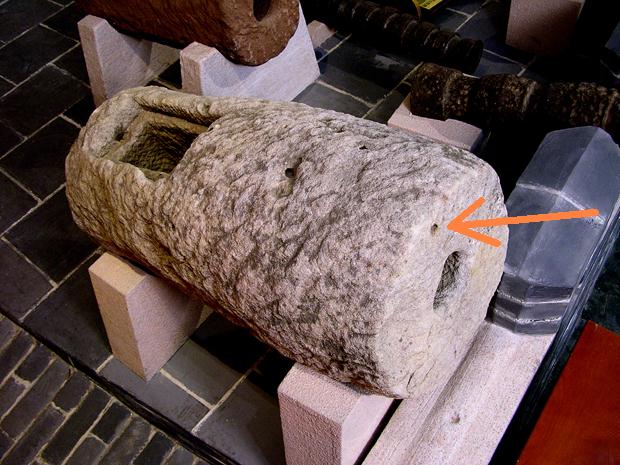

The hole in the muzzle plate/flat is highly unusual and dangerous, and the lateral damages seem to be rests of former integral stone trunnions, which would make much more sense than drilling a horizontal hole for a transversal bar into granite ...

With a lot of things said, I'm still facing two severe problems with three seeming recesses in line on the surface; wish I could mark them in red as 'Nando managed to do ...

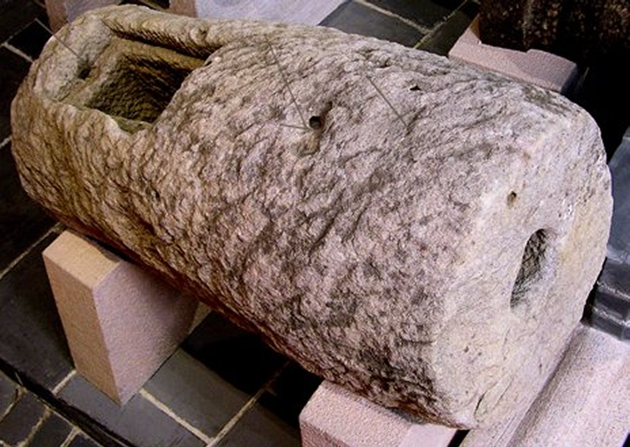

I don't really see the problem with the holes in this cannon.
The breechblock, which is sadly missing, would have had a touch hole. Whih also solves the problem of wear since you just could use a new breechblock.
>1 is behind the actually breech and could never act as a touch hole.
>2 looks to be drilled horizontally or at least at such a shallow slope that it would have emereged at the far end of china before reaching the bore (because once again, the breechblock is missing and can't possibly be connected by drilling a hole at least 20cm in front of the breech).
>3 is the mystery hole i was guessing at. If there is a hole there it would be likely a hole to move this cannon. We don't have measurements, but anyone with a bit of life experience knows that a piece of granit (one of the heaviest of stones) weighs a few "pounds". So logically there should be some way to move the cannon without having a 100 chinees man stampeding against one cannon while the enemy is raining arrows on them. There might have been a lot of chinees in that era as well, but i doubt that they where put to work in such a in effective way.
>Remains hole number 4 which again would come in handy to move a cannon (with a iron bar stuck into it? )
My question is how the breechblock would have been secured? In newer breechloading cannons the breechblock was secured by a bar which was put behind it or just by using wedges which would be pounded behind it.
Pounding near a stone cannon wouldn't be my idea of save working, seeing as a stone cannon is much like a handgrenate and even a small crack in this thing would have caused chinees new year to come earlier than normal (force always seeks the way of lowest resistance).

I think Marcus may be on the right track. Look at all the lugs on the bronze example. Attachments would have been needed for ropes or bars to locate, aim and absorb recoil on the stone cannon as well.
The breech touch hole makes sense also, instead of having a larger amount of powder which may explode as well as ignite the main charge.
I am sure I have seen pictures of an experimental double firing flintlock somewhere, with two inline locks one in front of the other - hence two in line touch holes - carrying two loads. Really advisable to fire the front one first! Not enough room in this cannon though.
