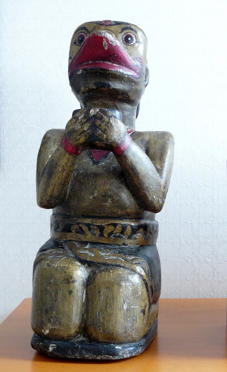

Gentlemen, although my knowledge of Keris is almost nothing, I was given the opportunity to select several interesting Keris and holders from a large and established old collection.
As I say, my knowledge is next to nil, so I won't be offended if you explain in simple newbie terms
Here is one of the holders, he is 55cm tall:

He's 55cm tall and weighs around 2.6kg, quite heavy?
He has an open gripping hand as is usual, but it's quite a small diameter hole. Are these used to hold other weapons apart from Keris?
I've not seen one like him before, do you recognise him or know who he represents?

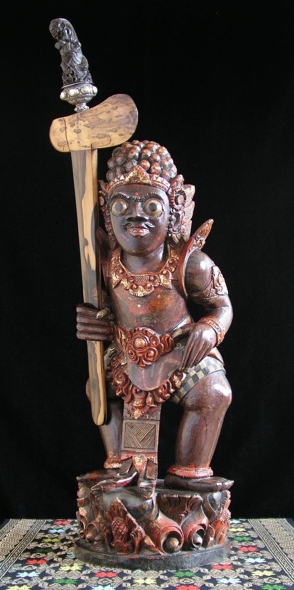

Hi Gene,

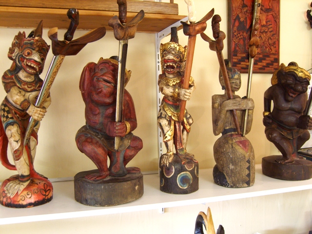

Attached is the picture of a similar Balinese holder made from hard wood, it is 60 cm tall and weights 4.5 kg. It is said to depict Bima (moustache, fierce look, long thumbnails). It has a large grip opening and is probably older than yours.
I also attach the pictures of 2 smaller holders which are Javanese I think.

Jean

Originally Posted by Jean
Hi Gene,
Best regards
Jean
Excellent thank you Jean.
I think that settles it, he is Bhima

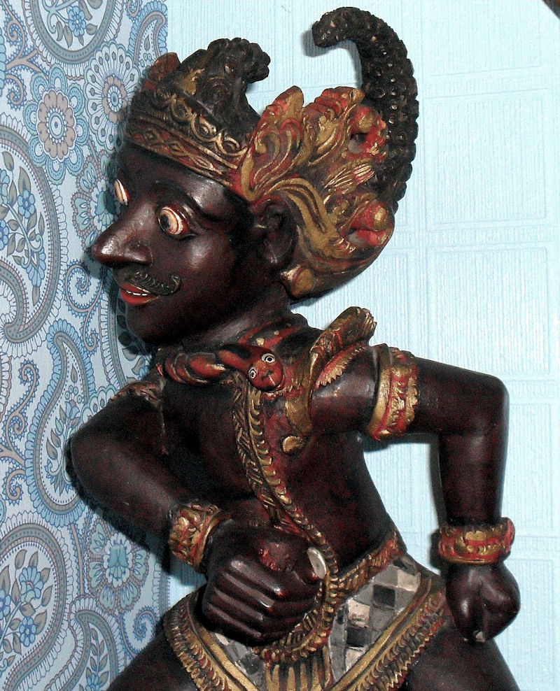

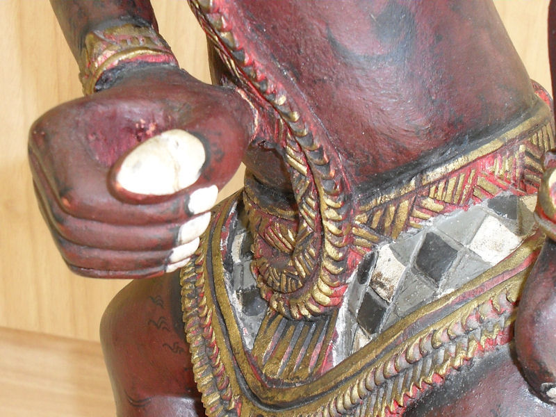

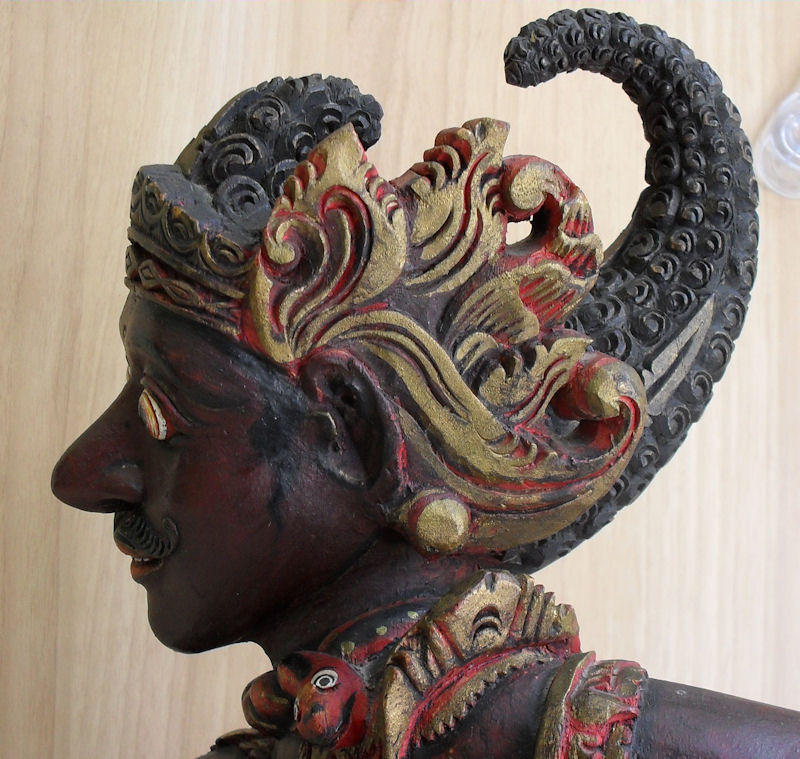

Hi Alan,
He has a 'wrestlers' build
Here's his thumbnail and some head shots to show his other attributes.

I don't think there is any doubt at all that my figure is the same person shown in your examples.
All the attributes seeem to be identical. Thumbnail, moustache, skin colour, hairstyle, costume, fierce expression, snake garland, even the black and white chequered sarong. So if those are Bima, then so is mine.

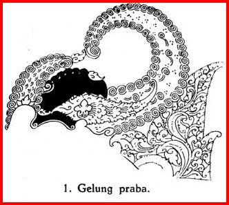

No, I'm not a hairdresser. I knew that "gelung" was for women, and when I checked my memory before I posted I found all these other hairstyles.

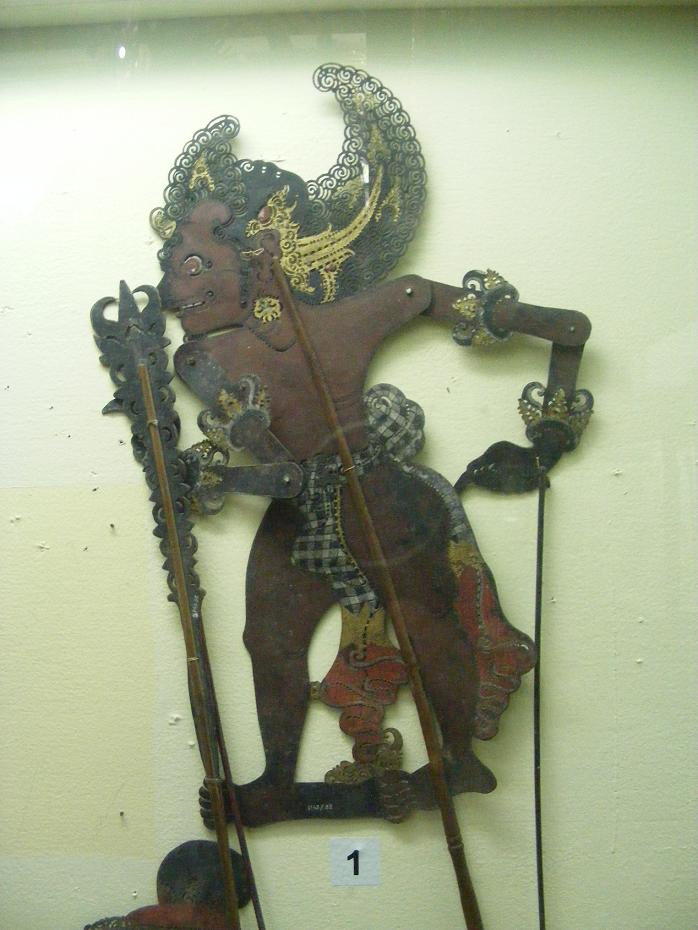

Thanks for the close ups. Yes, definite tendency towards Bhima, I agree that this character was probably intended, Bhima Bratasena.
Additionally, your close ups show the paint work better, and I tend to think it could be a little older than my first estimate, however, that light wood is a dead give away, it cannot be other than a souvenir with wood like that.
