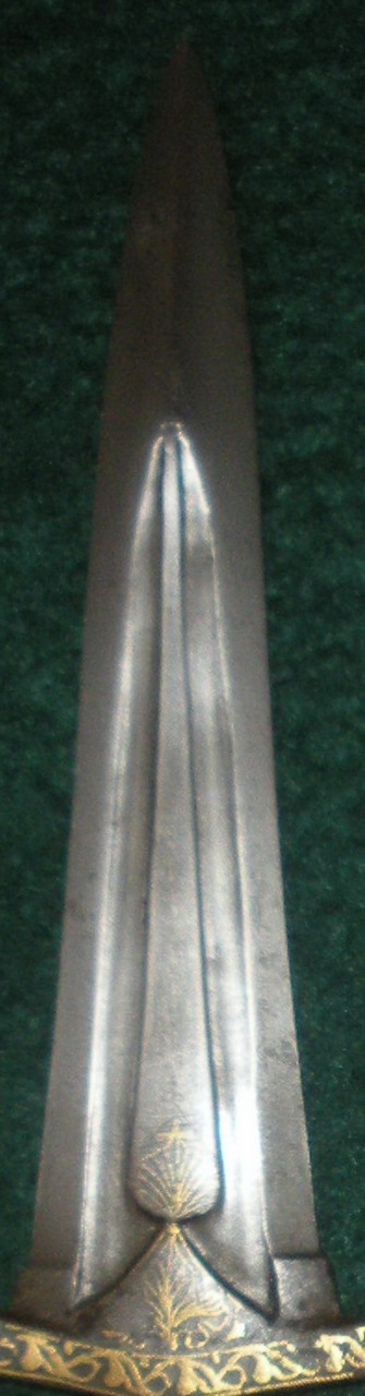

The persian blade might be wootz too. Most of them with such sculpted handle are.
The katar koftagi seems a bit unusual. Would it be possible for you to show a closer view ?

The katar handle is very ... narrow. I don't see how an adult could grab it effectively. Is that copper or brass inlaid into the handle?

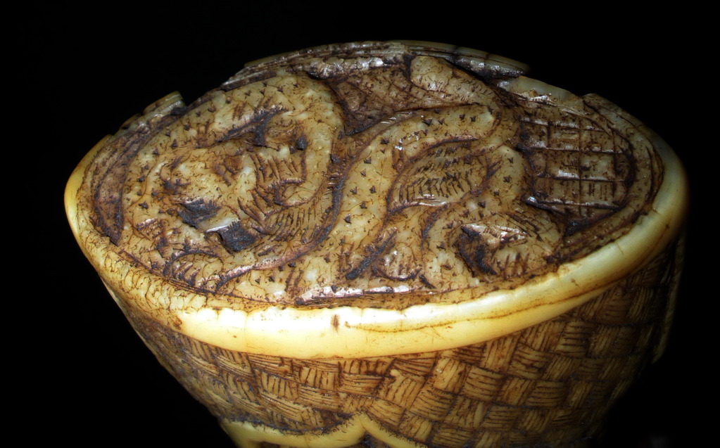

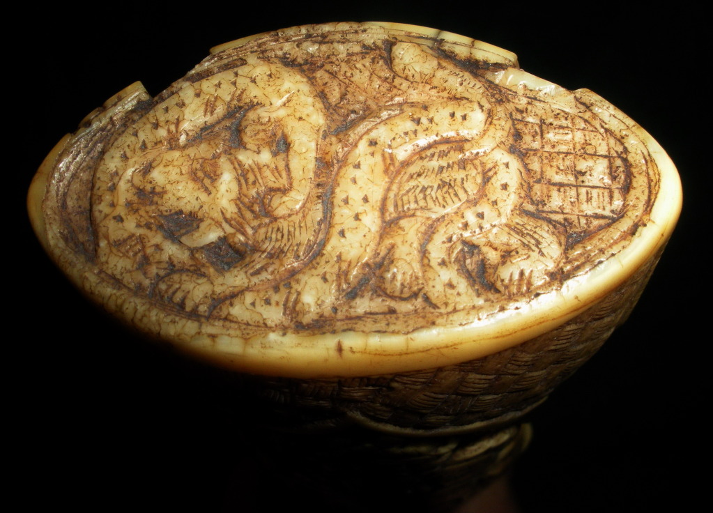

The human effigies are typical of Persian art. I am not sure if it has anything to do with the Shia affiliation of the large majority in Persia, but it appears that living creatures depictions were not a tabu there, as opposed for example to the Sunni Ottoman Empire. I am not sure what material the hilt is made from, but it looks like bone from the picture - a pic of the pommel might help determine whether it is bone or ivory. Certainly does not look like bufalo horn.

celtan
celtan's Avatar
Join Date: Sep 2008
Location: PR, USA
Posts: 679
Thanks T.,
Pics included
What's the big deal w this wootz steel? Is it a premium kind? All I know is that the vikings and celts in Spain used it.

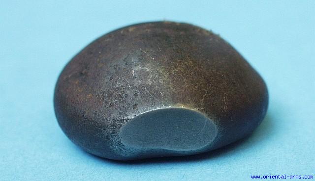

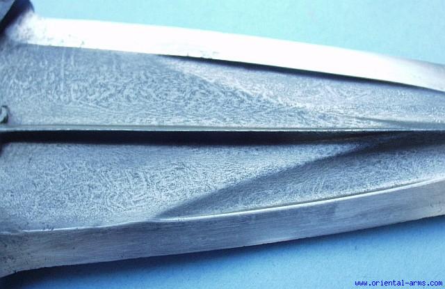

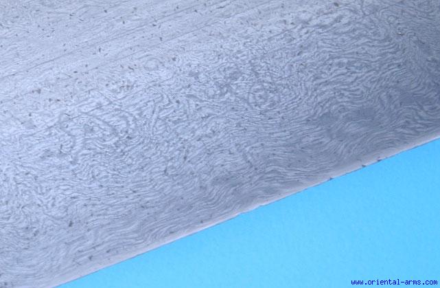

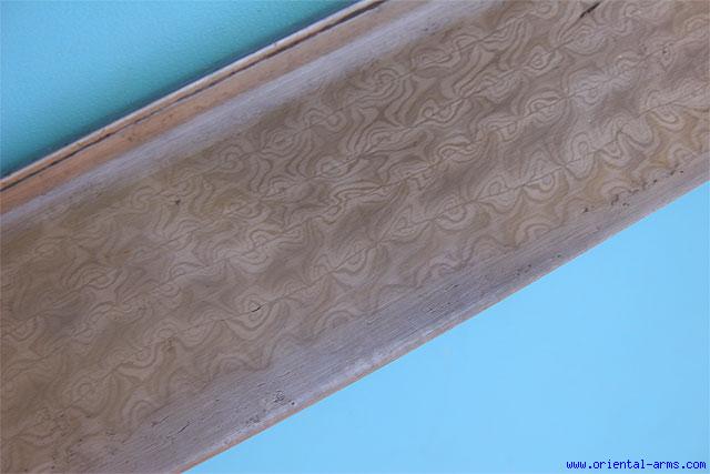

About wootz, while there may be evidence of its use by Vikings this was very limited and through trade. Perhaps you are confusing with pattern-welded "damascus". Damascus is often used as an umbrella term for most any metal with a strong pattern. It can be mechanical or chemical. The first consists of forge welding steels with different carbon contents, twisting and folding them in order to produce a more or less homogeneous bar of steel with the same carbon content all the way through. When etched, the different types of steel show a different shade, depending on carbon content. This technology was indeed used by Celts, Vikings, and almost every other steel using culture on the planet.
The second, wootz, is "crucible steel" or essentially cast steel first produced in India ~2000 years ago. The cooling cycle of molten steel was controlled to produce a very specific crystalline structure in the steel. The pattern comes from this chemical structure, not from the mechanical welding of different metals. It was completely homogeneous and very hard.
Hope this helps, all of these points have been discussed many times on the forum and there are lots of threads on wootz and Indian weapons.
Emanuel
- Some pics from Oriental Arms -
The top one is a wootz ingot
The next two pictures are of wootz katar (jamadhar) and shamshir blades
The bottom is of a pattern-welded yataghan blade with the "Turkish ribbon" pattern
