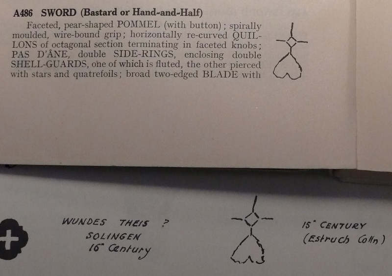

Naturally these 'latten' (filled brass) inlays are seen in good number on the early Germanic blades and well into the period you mention.
In "The Wallace Collection" (486a; p.251; p.688) a hand and a half sword is shown and described as with 16th century hilt....the blade earlier.
The marking on the blade is of an inverted heart with cross mounted at the tip of the heart...the cross with open disc at center.
This is almost a composite of these two markings you show here. The strange geometric figure under the cross seems a crudely fashioned heart type shape, using straight lines rather than the typical heart shape.
It seems that these cross oriented inlays may have been associated with these earlier times when forging blades and warring materials were one of the functions of the bishopry. Markings such as these with religiously oriented talismanic properties were believed to imbue the blades and thereby the warrior with the power needed to succeed in battle. These early uses of the cross and orb representing these type symbolisms are seen later in the well established 'merchants marks' in format using the mark of 4 atop the chosen symbol or 'logo'/initials etc.
While certainly certain makers in later times had marks of thier own, these seem more generally applied with perhaps certain abbeys favoring one or the other. One side of the blade typically had one symbolic mark while the other was often of different marking. Often the crozier symbol occurred opposite
markings of this type.
I'm sure those here with more access to plates of markings or examples of other medieval period swords will be able to add more concise comparisons, but these are just notes on the concept of the marks from my opinions.

Hello Jim,
thank you very much for your expert comments
thanks for the link to Wallace A486, I also found a similar in the estruch collection. Iam still not sure if this mark is a splitted cross (like missaglias)
or a early ORB representing a church or a crossed heart
The cross mark with a square at the center are found on 9th and 10thC Viking swords in Finland.
So my search did not make any sense at all
