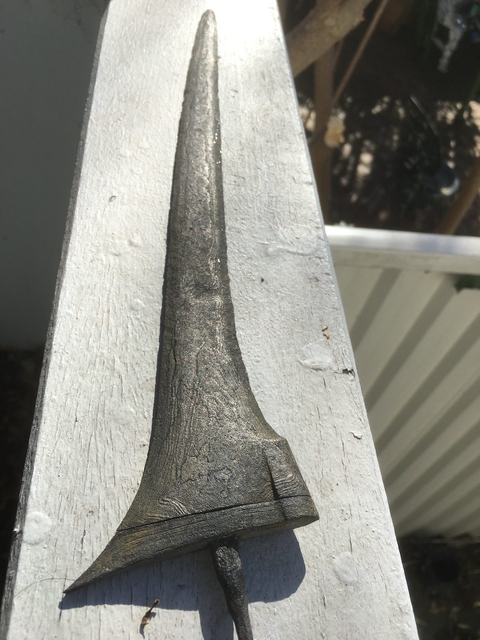

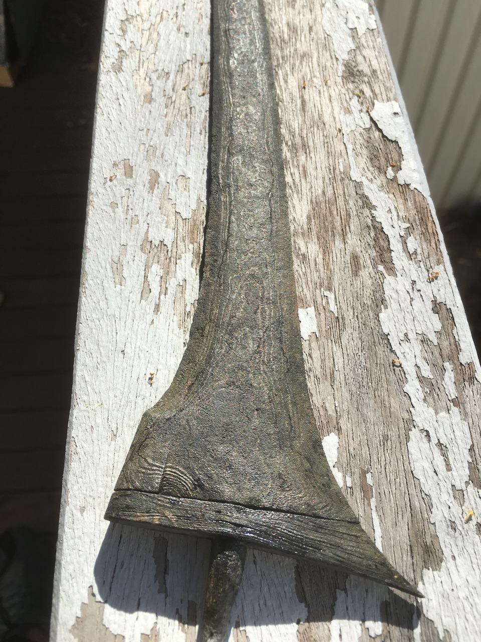

I hear that, Alan. I did not intend for my note to be a discouragement to try others, only to share my experience with citric acid.
Not sure if I'm glad I made the mistake, but I'm glad I learned from it.
I have a tendency to be quite conservative and unwilling to try other things after I make a regrettable mistake, so thank you for the reminder to keep trying other stuff I come across.
Apolaki, I've seen black stains like those when I was cleaning my Tuban-style pamor sanak keris - especially what is seen on the cleaner side of the blade. I just put it back in the cleaning solution (vinegar) and took it out to brush with a soft toothbrush more often. Eventually it came good. It's still quite clean.
I wouldn't worry too much, as Alan said just try to clean it again because there is rust on it.

Originally Posted by apolaki
The black stain has spread throughout the blade, it is like infected the blade.
Ouch, I can clearly see the coronavirus effect indeed, beware!

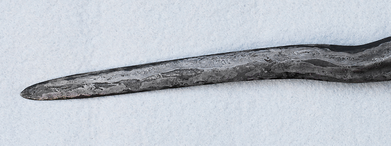

Originally Posted by David
Any photos of this Jaga?
Here you go.
It's since been cleaned down to a bare white blade because I wasn't happy with it. But it was a promising result.
When I try it again I'll leave it for longer.
Recipe:
Rice water - I soaked 1 part jasmine rice in 2 parts water, and agitated it so that it became cloudy. I ended up with around half a cup.
Salt - I used regular cooking salt. Don't remember how much. Maybe half a teaspoon.
Sulphur - In the form of yellow powder off ebay. I think I used 2 teaspoons.
jagabuwana is offline   Reply With Quote

My own appreciation: Quite good cleaning results, some faint traces of rust visible on the sorsoran and ganja, about equivalent of what I get with vinegar but with slightly better pamor contrast.
For me, it didn't go nearly as dark just using vinegar. Though if I could retain the slight contrasts that vinegar gives the blade, I would. I quite like it.

I reckon that for the type of material it is, it is a pretty good job.
Long time since I used the rice water method, but I'm pretty certain that my rice water was produced by boiling rice in too much water, then draining the water off. Also, I left the blade in the slurry of sulphur + salt + rice water for (I think) about a week, it was wrapped in plastic, the original recipe called for wrapping in a palm leaf.
The sulphur would have been bought in a hardware or garden supplier, the salt would have been from the kitchen.
This was the result.
Incidentally, this blade was stained more than 60 years ago, it has been maintained by infrequent oiling during that time, and for the last +/- 50 years by oiling + a plastic sleeve.
