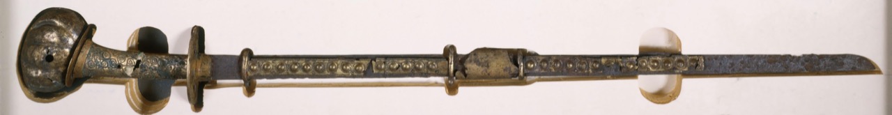

Good point Ariel. I currently have two sabers here with Mamluk inspired blade decor, chiseled in relief from the forte. Both have a long inscription on the longer, upper part.
As for the habaki (鎺) / tunkou (吞口, literally "swallowing mouth"), I agree with Philip that they are most likely of different origin. They are both solutions to the same problem but were developed independently.
The earliest form of habaki I've been able to find so far is on a Japananese sword now held in the Metropolitan Museum, accession number 32.13.2a, b. It is attributed by the museum to the 6th century A.D., however Japanese sources don't mention this type, called kabutsuchi until the early 8th century. (See Markus Sesko; Koshirae) Either way, it seems to far predate the tunkou and there has been no instance in Japan that the shape of this piece had any protrusion going up the blade.
The antique record hasn't left much for us from China, and those pieces that are found are hard to access and often not cataloged well. But, such tunkou are also seen on Chinese statues of the 8th century, suggesting that like the art of forging swords, this particular piece also originated in China and reached Japan directly or through Korea.
See picture for the Met's example.

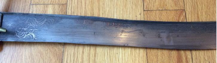

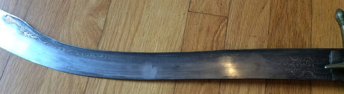

Ariel, your train of thought is quite plausible, it makes perfect sense in light of the aesthetic requirement of making room for long inscriptions. But when I look at the image, I think of something else. The long panel at the spine is not really joined to the element at the base of the blade. Well, they may be touching at a corner of each element, but if we were trying to look at this as a subsequent adaptation of the "traditional" tunkou shape (i.e. in its original, functional guise), the theory loses some steam because an actual tunkou would have to be of unitary construction in order to serve its purpose. The confluence of shapes defined by the inscription panels on the shamshir blade does not seem to be a realistic carry-over from an actual fabrication made of metal sheet and attached via a friction fit around the base of the blade.
Rather, what I see on this Persian example is the traditional tunkou outline (with tongue extending forward on the edge side) SUPPLEMENTED BY an elongated panel ahead of it, along the spine, serving as a border for the extended inscription. You could even think of the space for the dorsal inscription as the visual equivalent of those chiseled elongated panels containing animals that you see on the Seljuk blade whose image I posted on this thread previously. Just that in the case of your shamshir, the two areas are scrunched very close together with no significant empty space in between them.
Old 27th October 2018, 07:15 PM   #35
Well, it depends how one looks at it:-)
As you say, the 2 panels may be a "clasical" tunkou with a separate inscription panel, or an analogy of a "Chinese" tunkou with a slit in the middle.
But how about my own example? It is dated 1217, the koftgari is worn and partially lost, but the base-located wall-to-wall decoration and the " upside-down" orientation of a very long inscription at the top is obvious.
And, of course, one should not forget the tunkou on the great majority of Persian khanjars and the yataghans from Turkey: they all have the "upside-down" pattern. In the latter case, tunkou became just a triangular element with the long side along the spine , including just the cheap crude incision of the outlines.
My point is that with time the orientation of tunkou flipped over from the edge-located to the spine-located. What was the reason I have no idea, but a placement of long inscriptions along the spine fits nicely with the general idea.

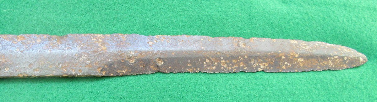

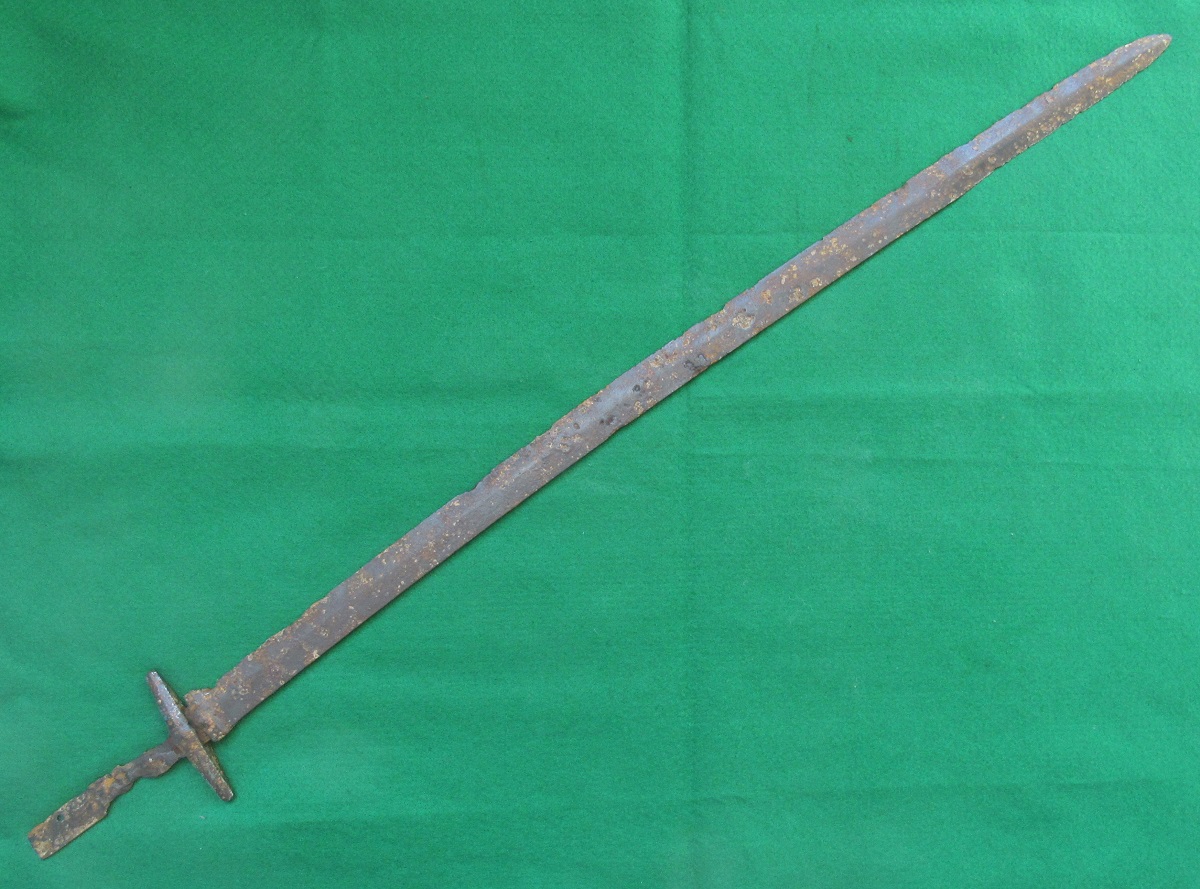

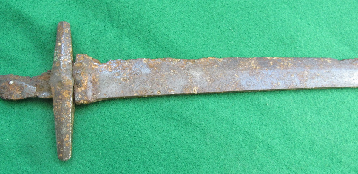

Here is another typical late Khazar period sword, 8th-9th c. AD. The double edged pointy tip is clearly visible.

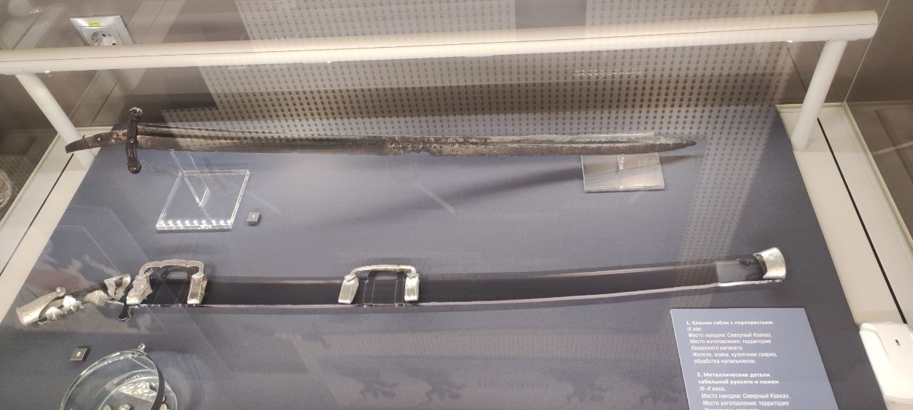

Nicely preserved sabre. https://tula.bezformata.com/listnews...vka/112552478/

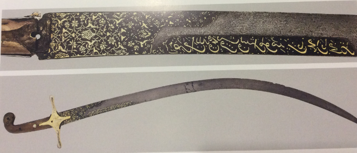

Originally Posted by Philip View Post
Ariel,
'Thought you might like to compare the tunkou (sleeve at the forte of the blade) on your Qipchaq saber with a couple examples from later in history. The concept had a long shelf-life. The upper image is a saber blade, probably Seljuk, ca 1200 (image and historical identification from Haase, et al, Oriental Splendour: Islamic Art from German Pvt. Collections, 1993.) The lower one is an early 18th cent. Qing liuyedao (willow leaf saber) formerly in my collection. As on your blade, the tunkou on both examples is fashioned from iron sheet and is a friction-fit onto the blade. On other examples from the Mamluk/Ottoman sphere, and Ming/Qing China, it is chiseled in relief from the steel of the blade and there serves more as a decorative motif, but that is another topic for discussion.
