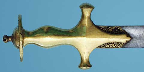

I think the style of hilt is Dungarpuri as seen at http://www.vikingsword.com/vb/showthread.php?t=17903 which is worth looking at.

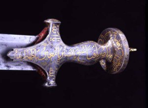

It is not often that Chivalry is mentioned in terms of Indian sword however I note; For the Delhi Durbar of 1877 Maharaja Nihal Singh was granted an achievement western style:

Firstly I must thank you for the time you have spent researching this Tulwar hilt, it is amazing there are so many designs and variations, your input has been much appreciated not only by me I should not wonder. I think that you may have cracked it as the Dungarpuri hilt certainly looks to be the same design. My only reservation is the length and design of the stem emanating from the top of the disc and the flower pattern inside the disc, which I suppose, could vary with the various tribes Thank you again for your input.

Thank you Miguel; Purely accidentally I stumbled on the hilt form Dungarpuri...
