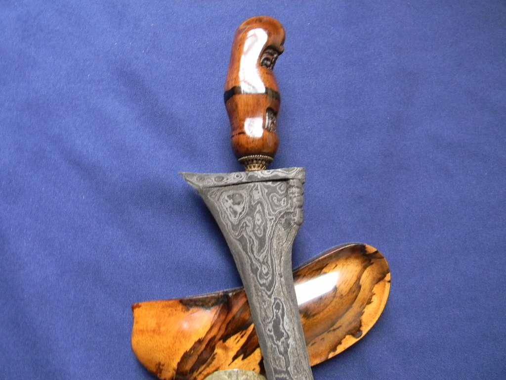

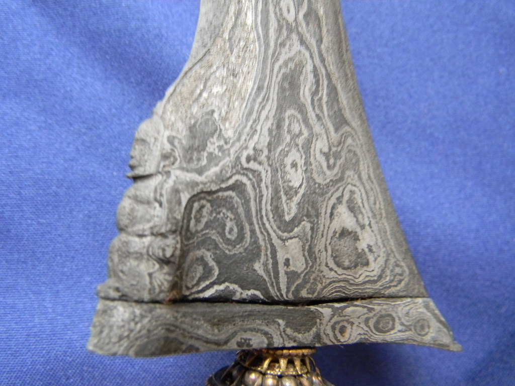

This "bringback" soldier keris, brouht to Netherlands by KNIL soldier begin '50. which i bought last week , is imo ans east Java keris (Balambangan). I have to wait for some better weather to bring the pamor out.

Yes, Madura soldier keris, and a 100% typical Madura blade:-
steeply inwards sloping gandhik, whispy kembang kacang remnant, gonjo lacks substance over the blumbangan, the distance from the final luk to the point is inclined to be longish.
This is definitely not able to be classified as Blambangan. Sorry.
Looks like we're going to get Madura whether we want it or not. Inevitable I suppose, and I guess we'll get other keris posted that will be queried as East Jawa or not. Probably not a bad thing, because it shows what is not East Jawa.

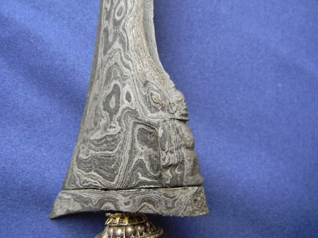

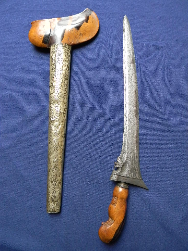

Default 3 luk lara sidua with raksasa hilt
Thanks for the feedback mr. Maisey. dont feel sorry to correct me ( i am here to learn) I did see the Maduran charasteristics, but i went on the wrong foot looking at the ukiran; the raksasa whith the crossed arms for his chest. I thought this is not very common in Madura.
What about this 3 luk keris, wilah ca 34 cm. ( without peksi). also ukiran raksasa, i have to mention, that the ukiran exsist of 2 parts, maybe not to see at the pictures . that te lowest part of the ukiran is a loose "ring".
longhaired at the backside; a little restauration at the head.
I bought it as it is. (mendak etc) the wilah lara sidua luk 3 ( according to Tammens) fits perfect. pamor beras wutah / bendo segodo
