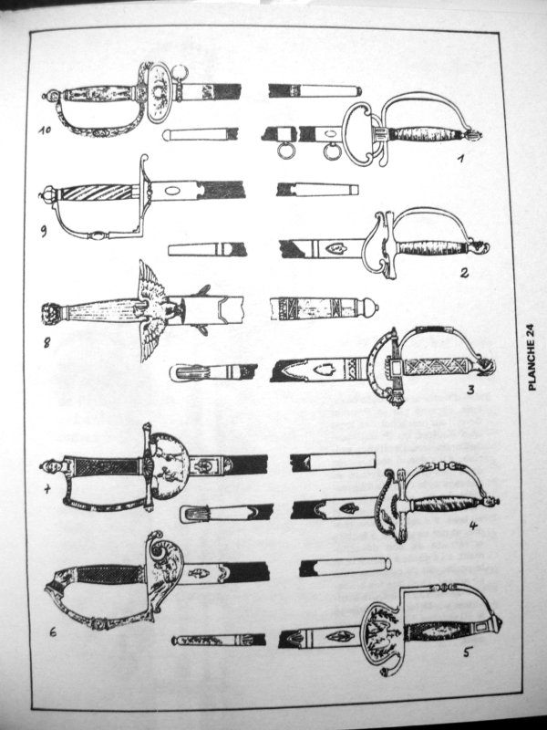

Michel Petard in Des Sabres et Des Epees States that the "5-ball" style was taken from the English in 1795.

Outstanding Jeff!!! and thank you for the excellent plate.

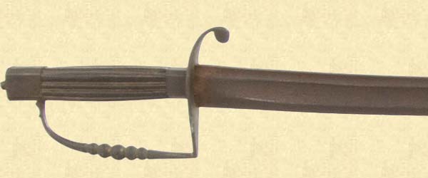

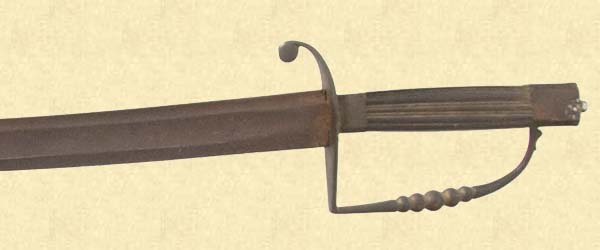

The 'spadroon' shown in the top picture I believe is British as the 'cigar band' affectation did not occur elsewhere, as I understand. Interesting image of Pegusus (?) in the guard, and I am wondering if this might have been special order (as I believe these were) possibly to a yeomanry officer? Returning to Masonic, and even perhaps heraldic symbolism, which such unusual image might have associations with, there were instances where the lodge sentinels, the Tiler, actually had swords made for thier duties. Again, the sword could certainly have been worn in regimental duty as well.
The second sabre seems profoundly French, the black ebony fluted vertically is an affectation seen in many French sabres of the turn of the century. Also the blade in cross section with fuller to centre point is the Montmorency cross section I believe, also of this period. Interestly James Wooley of Birmingham often used this style cross section in his blades, so there remains that possibility.

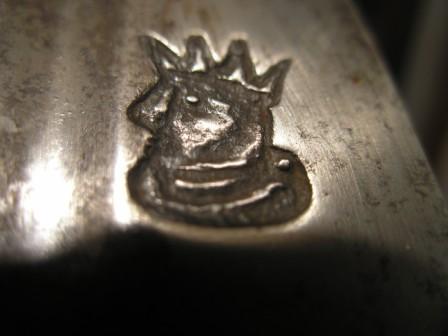

The figure in wonder is a hippocanthus (also written as campe and campus), or sea horse and very much a French sword "in the style of", as are others depicted above. I will try to find the first empire example of a ship's transom decoration but am still plowing through old and misplaced image libraries (although I did get my drive loaded to this one). I do have another plate that was shared with descriptions as well but I am shamed not to remember the book offered (if not ideed the same text another had put up).
It had been described by a dealer as an American artillery officer sword via his seeing the pommel type and as described in Peterson. I took it as a dragoon de ville epee before I had it in hand and then sea horses came into it.
The practice of three swords for an officer was not (apparentlY) singular to French practices but the one I pictured fits those descriptions exactly. A dress, or about town eppe. A highly decorated parade sword and duty sword of plainer nature also work in a trio of emsemble.

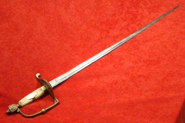

Here is a picture of a sword labeled as Swedish and about the 1780s. The odd paart about my coming across it today is that it wasb't the sword Iw as looking for, which may simply mean there are more associated 18th century clearly masonic decorated sword blades than we may think. It wa sa few years ago, so my mind may be misremembering as well but I'm pretty sure it was one as elaborate but with blue and gilt.

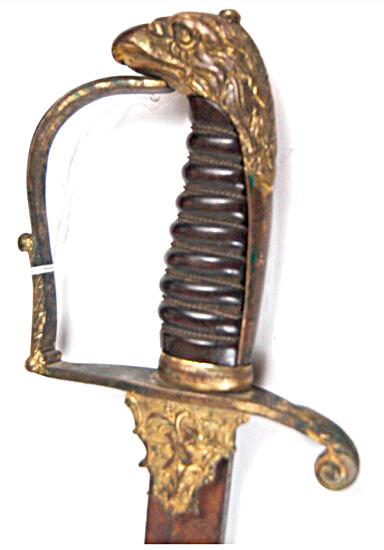

Well, yes, of course Mowbray does picture an example by Thurkle (it is on the front of his cloth bound) but I cannot associate some of the other examples I have shown this thread and elsewhere, simply because one blade is clearly labeled as Wooley and others simply not too Thurkle.
Cheers
Hotspur; I had recently acquired the Mowbray(the younger)/Flayderman Medicus title and really do need to spend quality time with it.

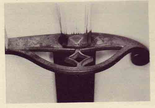

Hi Jim,
"Figure 1.A
Naval Officers' Sword ca. 1795 (Francis Thurkle)
One of the more commonly encountered Thurkle hiltings featuring a counter guard containing a pierced diamond- see detail."
Thats about it, Glen is correct he doesn't state that it is exclusive to Thurkle, just that it is common to them. Good eye on the square and compass motif. Actually look at the reflection off the ferrule, looks even closer .
