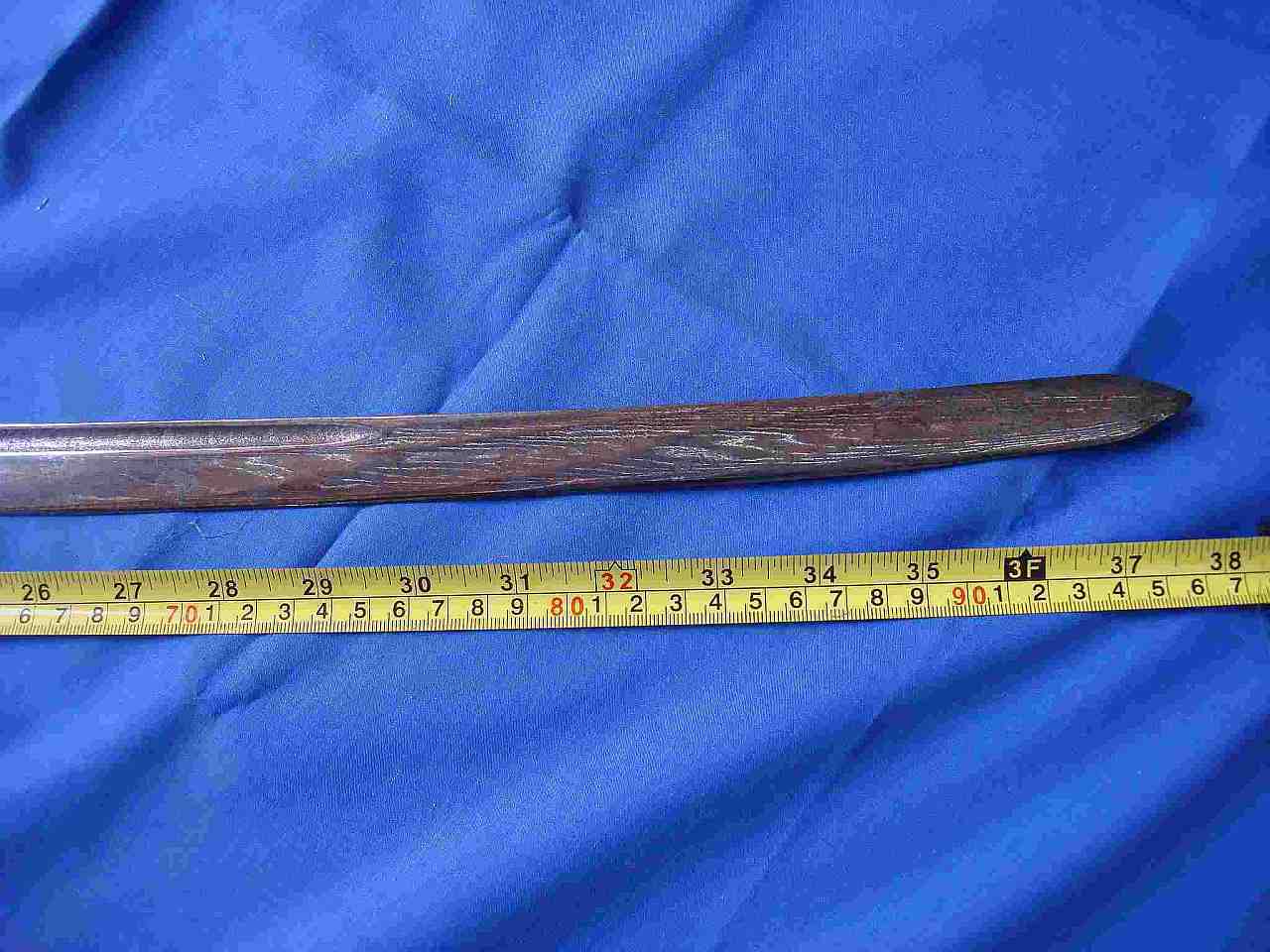

David, may i have the size of the blade only, the thickness of the back and if possible a close-up of the blade showing the fuller. The shape looks very near from one of mine.

1. the length of the blade from where it attaches to the hilt (correct term?)(along a straight line so not allowing for the curve is abour 80 cms
2. The fuller is (sort of) shown in pic called "sword13" attached. It ends about 8 cms from the tip of the sword
3. The best I can do on the 'back' of the sword is the attached photo "sword12"
4. I have added another photo of the 'butt' of the sword if of any help.
Many thanks to you and all of you who are helping me.....I cannot express properly my thanks and appreciation. I love how you are so passionate about this subject (mine are French & English antiques, golf and wine....different but as long as one has a passion for something then that is fullfilling )

Length of mine (see images 1 & 2) from guard to tip is 90cm.+/-, so it's longer, but a same blade's profile. I wonder about the black color of your hilt (seems painted...) What is it ? is that wood under this color?.
