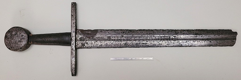

I suspect this sword is, at this point, one of the most closely examined and analyzed swords out there, with nothing yet denting my enthusiasm towards it.
Below are the remains of a sword of similar form bearing an +INNOMINIDOMINI+ iron inlay; the ruler is 4 inches:
Lee is online now   Reply With Quote

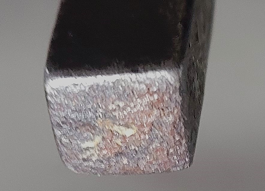

Thank you, Lee. I love the sword fragment you're showing. On the other side of the crossguard, it also has a deep chip, similar to mine.
I wonder if anyone has done a comparative study of corrosion layers, including fakes, and if there are any fakes that show a similarly complex layer structure.
Best regards
Andreas

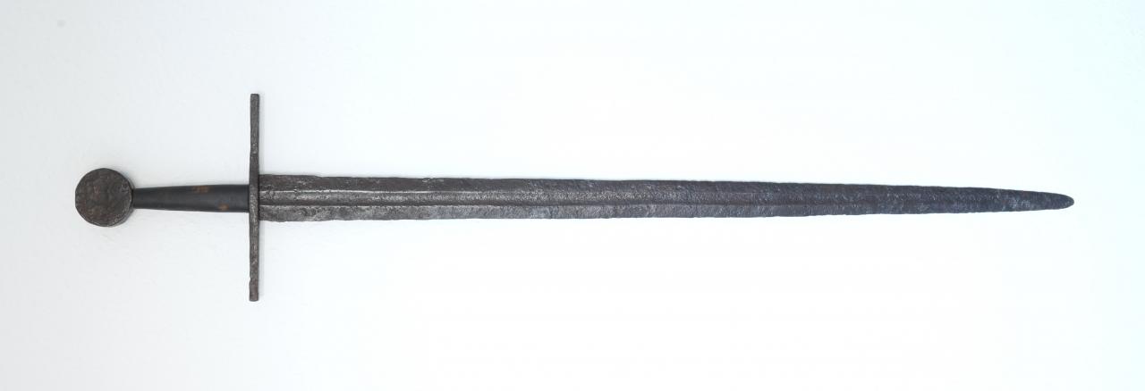

Inspired by Lee´s sword, I attached a (removable) grip to give it back a bit of its originally appearance. Atteched an image.
Best regards
Andreas

Ewart Oakeshott would surely have approved of your grip reconstruction! It looks nice and also lets you "feel" the sword in your hand as a sword.
Thank you for the link to the article and the photos of the statue; I had not seen these before.
