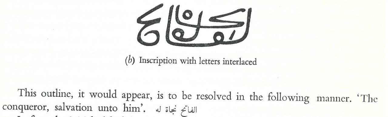

http://www.vikingsword.com/vb/showth...=sudan+bayonet
screan shot so it can stay regardless of photobucket. Last edited by Tim Simmons; 1st December 2025 at 05:09 PM. |

Posts: 5,949
The etching is a repeat of the image. Which is a distortion of Aribic acording to the auther of {Nigerian Panoply arms and armour of the Northern Region A.D.H Bivar, Department of Antiquities Fedral Republic of Nigeria 1964}
#11 |
Posts: 4,644
Thanks Tim. It seems that I have all the images upside down.
I'll try to restore them to their correct orientation. ![]() The reoriented images for my knife seem to be a fairly close approximation to the inscription that Tim has shown. Those on the kaskara are not as close. Last edited by Ian; 3rd December 2025 at 03:34 AM. |

Posts: 5,949
For comparison.
