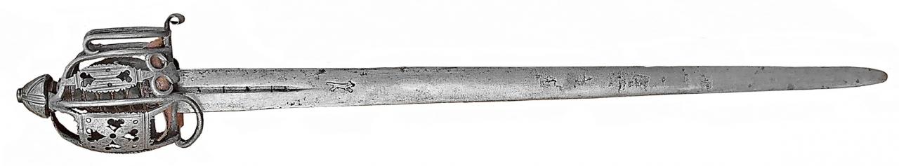

To take things further, after the Jacobite rebellions 1715,1745, many Scots were absorbed into British army units, and typically simplified versions of Scottish basket hilts were made in Scotland in 'garrison towns' for the British military...still using German blades (last example).
1 Ribbon hilt (beak nose) Highland c. 1650-80s pre Glasgow form ANDREA FERARA blade
2 Glasgow form, c1700 early 17th c Solingen blade Wirsberg.
3 Glasgow form c.1715, ANDREA FERARA blade
4 Glasgow form, British cavalry, poss. Scots Greys c. 1760
Note: English swords typically used German blades through 17th century, but the Hounslow enterprise 1630s and Shotley Bridge 1680s-1700 were using German makers relocated to England for production of blades. However, while a nominal number of blades were produced, there was still a large import of German blades.
