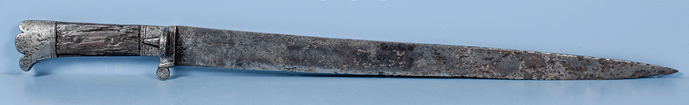

I just won this, in my opinion, very nice and also very old dagger by auction. It's 34 cm long and it's said that the blade is heavy. On one side is the blade marked.
I think that this dagger is very old, 18th century?
Any opinion about the age and exact origin? What do you think, it's a hunting or fighting dagger? Pictures from the mark will follow soon as I have received it.

Thank you for your comment! Your age guess surprised me a little bit, my careful guess was 1700's but you may know better. My hope is that someone could recognize the maker mark but we have to wait until I have it in my hands, the auction house only mentioned the mark but didn't provide a picture of it. A friend of mine thinks that it's a fighting dagger instead of a hunting knife.
Like you I also would like to read what others think about this knife!

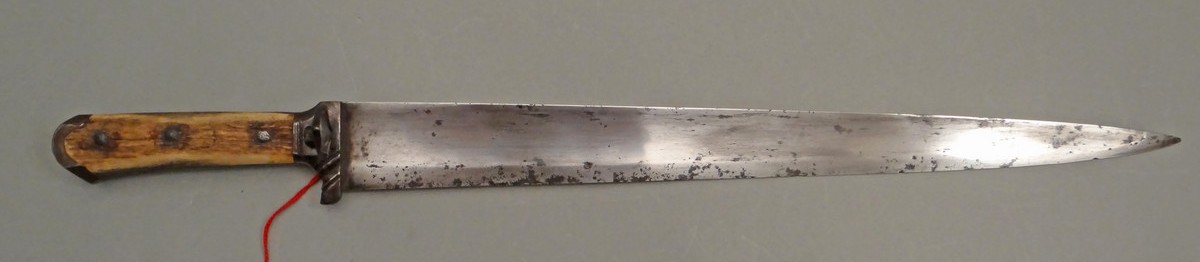

Here some pictures of hunting knives of the 16th century i took from the great book "Hirschfänger, Zur historischen Entwicklung jagdlicher Seitenwaffen " written by Mr.Westphal.I assume ,that your knife isn't a shortened hunting sword, because quillons are missing and have never been there.

Hauswehr, utility messer with nagel, also used for fighting in an emergency (in the hof brauhaus). Nice one.
(example Found on Google)

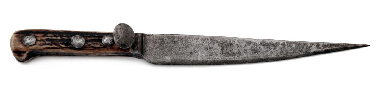

Just found a very similar example online, sadly without any further description, my search word was "bauernwehr"!
Found the source: https://www.bladesmithsforum.com/ind...19-bauernwehr/

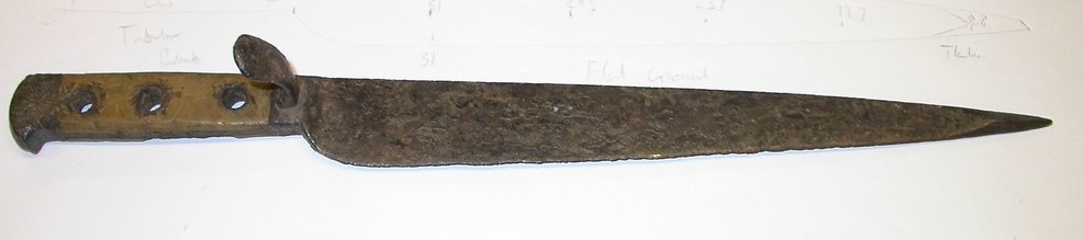

Figured I may as well add what I have, although I can assure you all this is from early 1700s - so not really relevant, but I like to contribute what I can. More likely a domestic knife I suspect but... that said, it seems unlikely, having that grip.

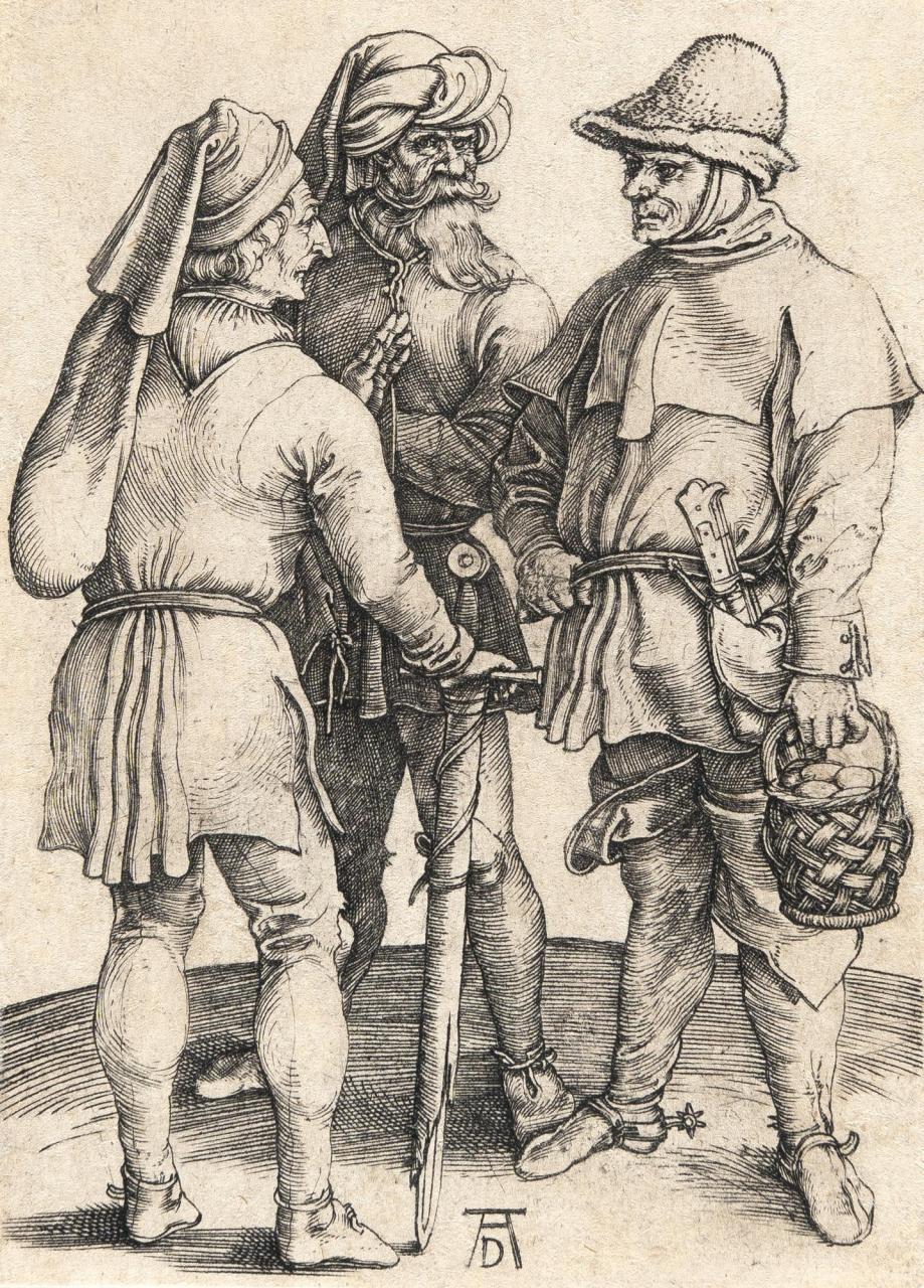

Two more antique examples and an old drawing from Albrecht Dürer, "Three farmers in conversation", one farmer wearing a "Bauernwehr".

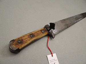

I have received the knife, it's a very massive knife in the hand. Attached a few pics, I hope that someone will be able to recognize the mark.
Last picture shows the knife in my wife's hand.
