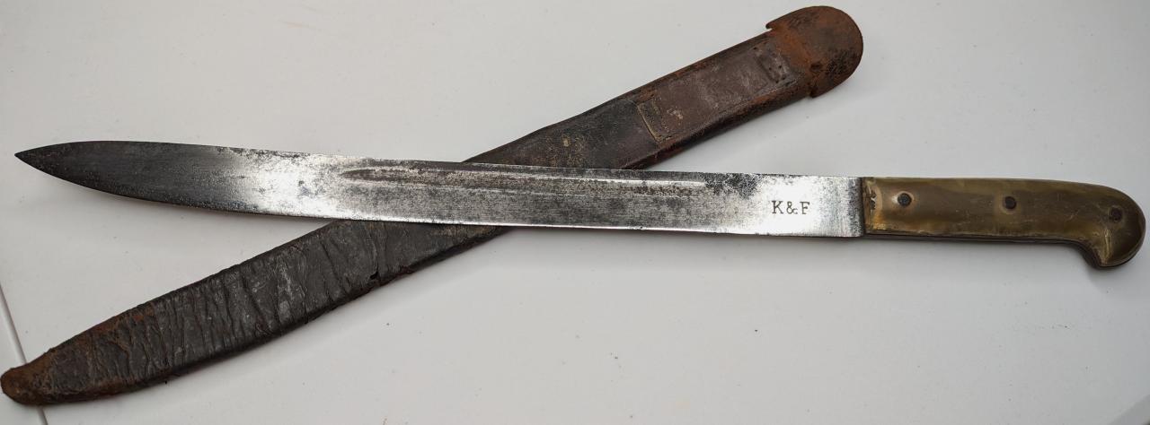

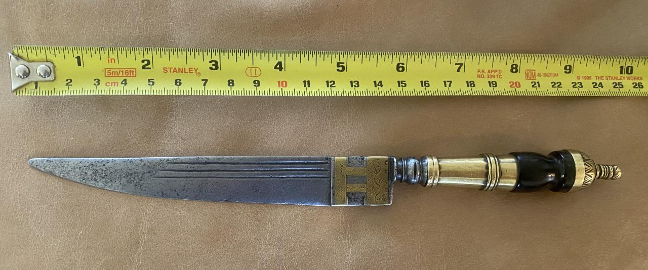

Good afternoon everyone,
For my first post here I'd like to offer up this interesting 19" (overall) machete type knife with horn grips and a fullered blade which becomes double edged. It's a quality piece with good steel and craftsmanship although its stitched leather sheath is not so reflective of that anymore!
Perhaps the most interesting quality is the stamped "K&F" trademark which is yet to be identified despite my efforts. Possibly a German blade on a Spanish Colonial Machete?
I have found similar examples here https://drouot.com/en/l/20070558
and here:
http://www.vikingsword.com/vb/showthread.php?t=23439
Any thoughts and opinions welcomed, and thank you!

Old 22nd October 2023, 07:23 AM   #2
Posts: 6,027
Has the look of a converted bayonet? Perhaps fashioned Ww1 East Africa by the look of the scabbard.
Old 22nd October 2023, 11:36 AM   #3
Posts: 4,748
Hi dandon809. Welcome to the Forum.
I agree with Tim. This does look like a refashioned bayonet. Can you provide the overall length, the length of the blade, and the length of the fuller? That might help identify it.
We don't generally get into modern militaria and bayonets on this forum, but this example is more of a "what'sit" so let's see where it goes.

Welcome dandon. What does the other side of the blade and scabbard look like? And the spine as well. Tim if this is a bayonet wouldn't there need to be a scarf weld, or the blade of the machete would need to be supper narrow to create a full tang grip with a beaked pommel?

Thank you for the welcome, and all the opinions so far I really appreciate it. Here are some measurements:
Overall 48cm
Blade - 36.5cm
Fuller - 17.5cm, closer to 17cm on the marked side (but possibly due to pitting)
Alongside ethnographic weapons I collect militaria and specifically cutdowns, and this doesn't strike me as one personally as there are none of the usual suspects I.E grind marks. If it is one it's a very clean example.
I will post some more photos of the tang and other side below. Thanks again!

Thank you. Here are some photos of the tang, the other side, and a closeup of the blade. Following up from my last reply it's worth noting that the grips are quite crudely pinned despite the blade being better quality.

It is difficult to be sure of anything with these pictures. The spine would help. The width of metal in the handle does seem to vary. Could be from a late ersatz version? Certainly has a bayonet look. Could the scabbard look like one of those Brazil / Argentine knives? It is far from a machete.

It seems the 'spear point' on this item is atypical for a machete, which needs a larger blade and with heavier distal end and broader radiused point for chopping. The type of hilt is the only factor that suggests machete.
The initials are unusual in position as noted, and could apply to any number of individual suppliers...the fuller does correspond to many forms of bayonet of the 'sword type' of latter 19th c into 20th, but may have been applied to other blade types.

Thanks RobT. I've just had a look at this myself and it seems the typestyle on the trademark is at least the same style. I think the one on Blackswan could be made from an old (but later than this piece) file just based off the general shape and grind marks.
One thing worth noting is that the company had files made in the K&F name in Mexico and Brazil. It could be possible that knives were also made there, or perhaps some old product repurposed? That would add to the Spanish theory. Of course it's still unclear if the stamp in my example is made by this company, so treat this as speculation!

A similar sheath is seen within this article on the forum, others readily seen on google images.
http://www.vikingsword.com/ethsword/facon/criollo.html
Is Chris about, he'll nail it down pretty quickly.
Edit; Found the name I was looking for, Sorocaban, as was mentioned above by AHite.
The etymology section is interesting.

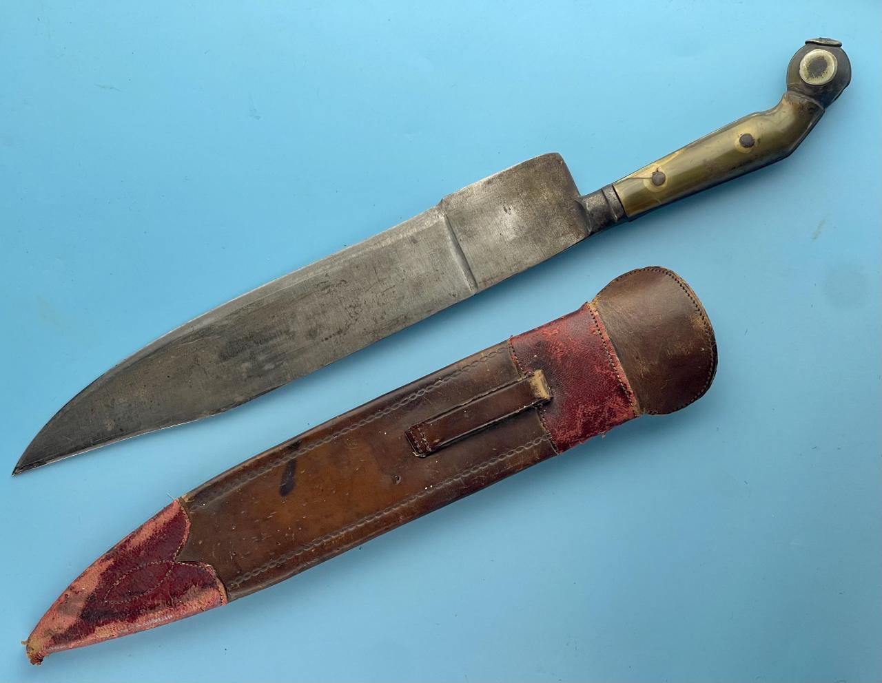

Good afternoon Gavin
Thank you very much for the info and references, after looking at them it does seem that this is most likely a Sorocaban or indeed a "Facon". Lots of Gaucho knives show up here in the UK so it does make sense.
It seems that my example is slightly unique with horn grips instead of the usual decorative silver. Alas the maker is still unidentified but I can at least start looking more confidently in the German direction.

Happy to offer some direction.
In the purest sense, what you have lacks the Sorocaban flair in what is essentially a unique pommel type. Yet when you read the etymology of the type, one can gain some direction.
This might be worth the read? It's a LOT to translate.
chrome-extension://efaidnbmnnnibpcajpcglclefindmkaj/http://www.cutelariaartesanal.com.br/downloads/Facas_Brasileiras_2a_Ed.pdf
Page 12, figure I-04 shows a cleaver with a similar grip.... way down on page 259 I think it is, you will see this image attached, being a newer version of what you have. I do not know where the photo credit lays for further insight.
Below that is from my collection, displaying the classic pommel type.

I am going out on a limb here disagreeing with someone with the extensive knowledge of Mr. Nugent based only on a thirty-year-old memory which can at best be very faulty, but I think this knife was European made, and possibly made for Central America. Thought the scabbard does look to be South American. Btw dandon we never did see the front of the scabbard. I am 80% sure I have seen a late 19th century catalog picture of machetes for sale made in Europe and that this was one of the models sold in a few different lengths. It stood out at the time because while I had used machetes of different types and ages extensively, I had never seen a fullered model. The facsimile was a black and white line drawing of many different types of machetes with an item number relating to a description and a price. I am still looking for the book. It was in my grandfather's collection that my father now has. Many people in the Ethno Forum have said before "weapons travel during their life." The scabbard may be Brazilian but that does not mean that it started there. Therefore as to it being Sorocaban are we saying made in Sorocaba or a facao enterçado? To me the OP example being discussed differs from the enterçado in three key features. 1. handle profile, the OP item just seems to have a standard machete handle to me rather than the ottoman style pattern. 2. It has a fuller not a unadorned flatgrind 3. It lacks the defining feature of a riveted enterço. Or once again, are we just thinking that it was produced in the city of Sorocaba? Either way outside of the sheath is their providence linking this knife to that city or style, even to Brazil? I could owe Gavin a "you were right" at the end of this discussion.
I have two questions arising out of this discussion. I. Is this type of sheath always a horseman's sheath? I.e. carried in the back of the body, edge up, on the dominate side? II. A. The enterço or riveted ricasso joining the blade and the tang. Once again relying on my faulty memory is used in some Indian weapons. Was it used in Iron age Celtic blades as well? Anywhere else? B. Is it related visually, aesthetically to this style of ricasso decoration pictured below?
Edit: In the Abel Domenech article's picture as well as in in the horseman picture in the previous post there is a folded leather flap on the outside of the top of the sheath to the hold the sheath and it is carried under the belt. In the original post example, the sheath has a belt loop on the back of the sheath, meaning that it is carried on the outside of the belt.

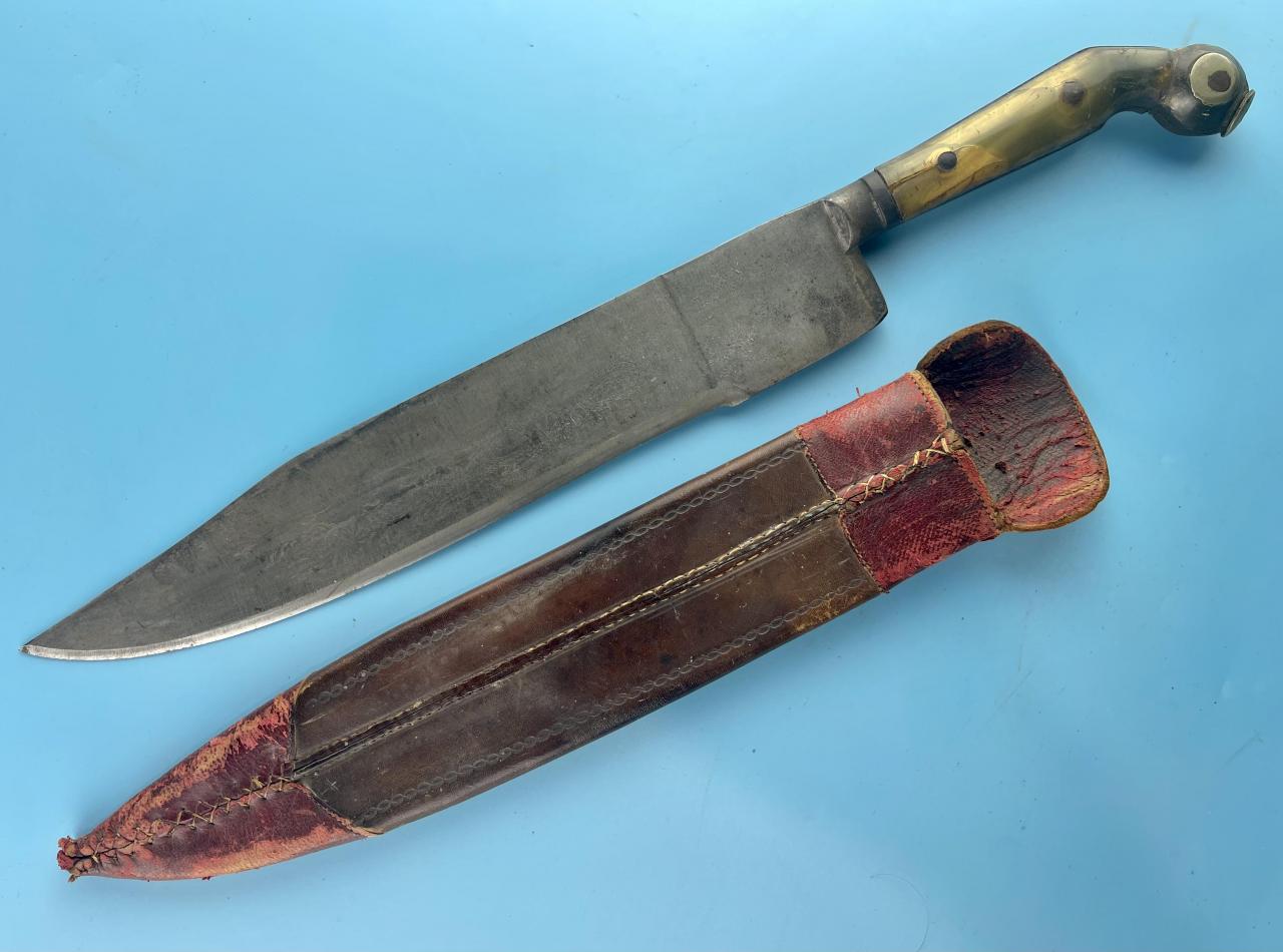

Here is the back of mine... same loop.... are they saddle mount perhaps... I've never seen any wear other than inside carry on person.

Sorry to disappoint, but I plead ignorance on this one as it could have come from anywehere, though it does have a Latino look about it, and your suggestion of it being a Sorocaban has merit!
Facons, large thrust oriented knives, were generally not tolerated on the cattle `estancias' as they were not working knives, and the size of this example, puts it loosely in the facon category.
Pampean gauchos were poor vagabonds, later itinerant station hands and gang-pressed troopers, and for knives and facons had to do with whatever came their way.
It could have belonged to a soldier from the many wars, improvised from a bayonet - or perhaps a `montonero', even a gaucho `matrero', in other words an irregular militia man or outlaw, but this is pure speculation on my part.

I found it finally it!!! The machete looks like a longer version of 7015 and could have been your Great grandfathers for only 25 marks.
Notice there are blade types for several different markets including a Sorocaban pattern for Brazil, Central American styles, a cane chopper, and Kenyan style pangas, but sadly not the old Mexican colima/panzon style with the humpback or panza depending on your perspective.
