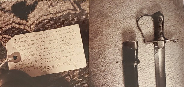

The stirrup-hilted swords such as used by the 13th Bengal and the 17th Bengal Lancers are not a 1796 pattern, and the greater majority of the blades marked J. Bourne & Son were produced by Mole for Bourne; whereby reference to certain pattern swords made for Bourne by Mole, are found in the Mole records. And these include stirrup--hilted swords (13th Lancers), those with an 1821 light cavalry type hilt, also those with an 1853 type (solid tang) hilt, and others.
Swords of the (1796 Pattern - EICo No.301) made by Mole were carried by Indian Officers and Sowars of the Governor -Generals Body Guard Bengal around the turn of the century, and actually appear in a photo circa 1897. The only marking on a surviving example recorded by me, has a Mole trade marking very lightly stamped on the back edge of the blade near the hilt.
