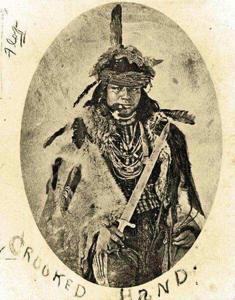

Default Crooked Hand's Sword (Pawnee)
Fascinating thread! I learned a lot (which is why I joined this forum).
I could use some help identifying the sword in this photograph of Crooked Hand, a Pawnee Indian. Someone suggested it was a Model 1832 Foot Artillery Sword, which seems plausible. I have another photograph of an Otoe Indian holding a similar sword. I am curious to when and how this model made its way to Nebraska.
The cavalry saber is more common among Plains Indians, which is why this particular model intrigues me. Any comments and help you can furnish me is greatly appreciated!!!
ParikiMark is offline   Reply With Quote
Old 1st March 2020, 08:29 AM   #38
The French, and by emulation, quite a few other admirers in Europe used a gladius style sword for their non-cavalry foot sloggers, They came in a variety of blade styles with different fullering schemes. I even have one with a double edged yataghan style blade of flattened diamond x-section and no fullers. anyhow, the USA model had rather distinct fullering and a tapering waist blade shape, unlike the Native American's photos which appear to have a straight sided unfullered flat blade profile, more in keeping with a French version. I don't recall the Brits using them tho*. the French settlers in Canada and the Louisiana territories the US aquired may have had french 'gladii' with them. the french used them from 1771 thru about 1870. (the 1771 was a rather nicer eagle shaped grip one.) they were not very practical as weapons as the gladius was designed for use with a shield in close formation. Even roman cavalry used a longer sword called a 'spatha' and so did many infantry after the 1st century a.d.
*- It appears the British Land Transport Corps carried them too, their model looks a lot like the ones in the photo too, and very French, who they likely copied. So, Canada remains a possible source of these Native American 'long knives'. Shame the pics are a bit degraded & do not show more details of the cast brass grips.
