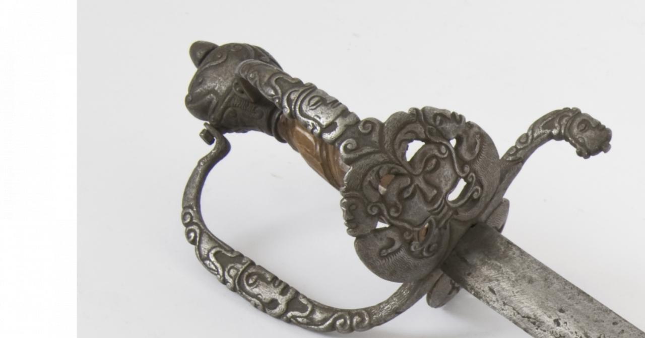

Hello Together,
Some month ago I got this interesting sword. It was covered by a thick patina (see first picture) which was easy to remove. Surprisingly the condition under the patina was quite good. It is 90cm long, the blade is 77cm. The Guard is cutted from iron, no iron casting. There was a thumb-ring on the shell-guard, removed in the old times and the blade is signed with the "passauer Wolf" and the "magical number" 1518. I found a similar piece (converning the lion-guard) at Hermann-Historica, Auction 62/63 -> a selection of collectibles -> Hunting Hangers Lot Nr. 2330c http://www.hermann-historica.de/db2_...ion-62-63.html
I got three different opinions on this piece:
- "maybe historism (19th cent.) while using a blade of the 17th."
- "Officers Felddegen, around 1660, the guard in the style of Gottfried Leygebe"
- "Guard around 1580, Northitalian, the blade marriaged with the guard around 1600"
My opinion: Due to searching a lot of catalogues etc. I think the second opinion (around 1660) is the most likely one. But I couldn´t find an identical or nearly identical piece. In my eyes evidence against historism is the removed thumb-ring and the deep nick/cut on one of the stirrups (sse picture), which seems to originate from another edge weapon, also as this potential hit bended the stirrup out of shape (see last pic).
I would be very interested in your opinion about this peace. Maybe you can also help me to find out about the geographical context of the sword.
Thanks and best regards,
Andi

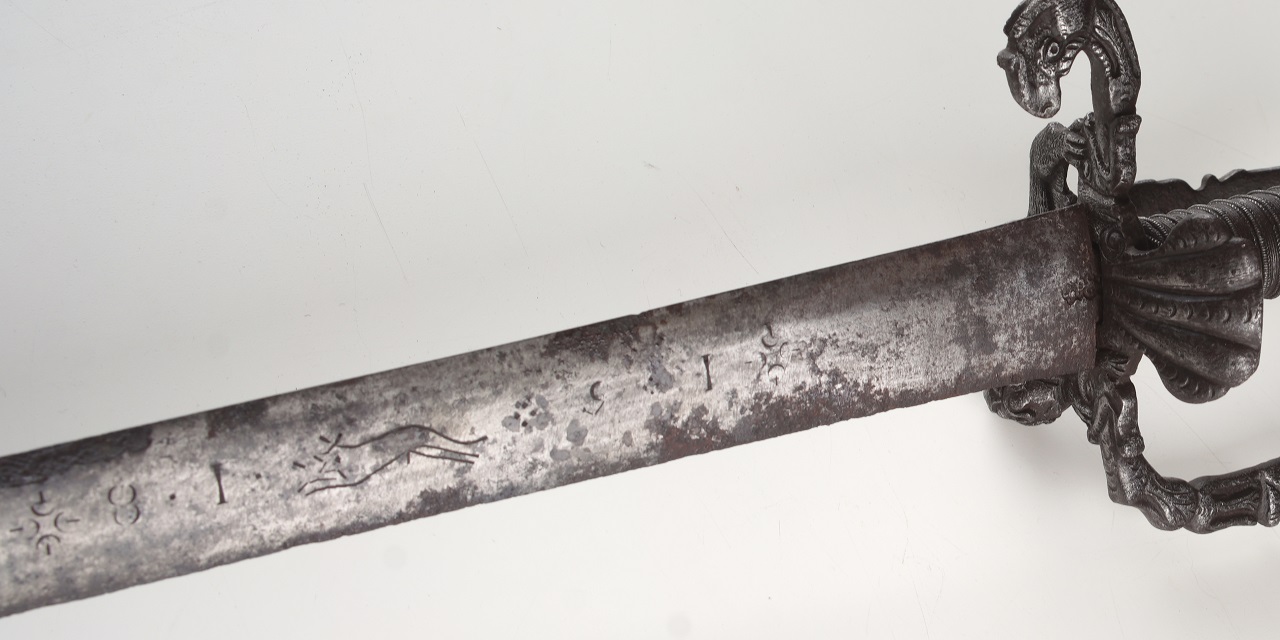

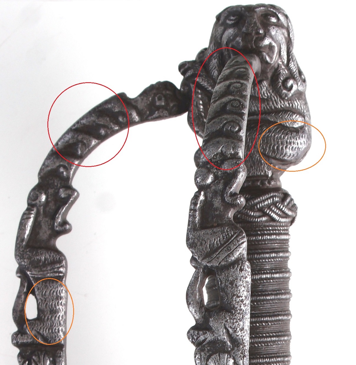

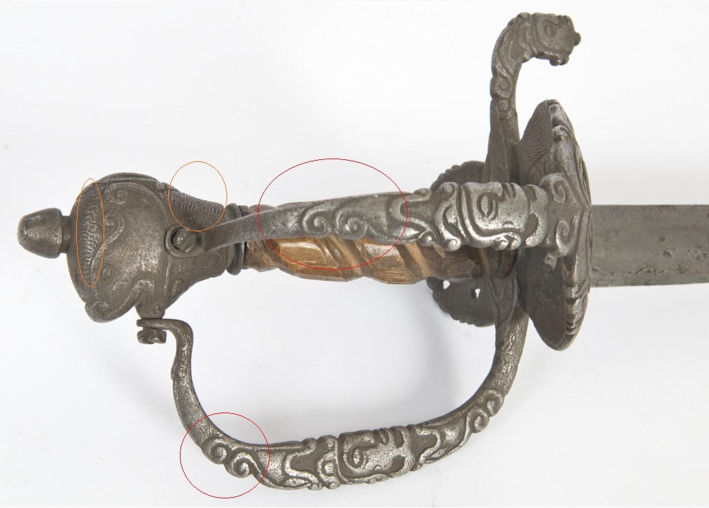

allow me to fetch up this old thread. It´s now nearly 10 Years I own this piece and it still won´t let me go. From time to time I do a bit of research on it and my biggest dream is to find a painting showing it´s owner with the sword I know it is very very unlikely, but I am sure such a painting once existed. The question is: did it survive and is it listed somewhere...
But anyway: I just stumbled over a picture I saved as a reference years ago with the comment "Sweden, 1660-90". I´ve found several swords with similar lion cross-guard, many of them indicates the Netherlands as origin but there are also pieces with other provenience. But this is the first time I found this wave-like decorations on the guards. Also the tool used to decorate the stylized head seems to be similar to the one used to form the lions coat. Maybe this can be a another hint to its origin.
Sadly I can´t remember where I saved it from, only that it was a (Swedish?) museums online gallery without more information.
Does anyone of you know similar examples?
Kind regards
Andreas
AHorsa is offline   Reply With Quote

Originally Posted by AHorsa View Post
Dear all,
Kind regards
Andreas
Not sure how ”Swedish” this piece could be. The lion as an animal was frequently used to represent the Kingdom of Sweden. Swords were mostly imported by Sweden from Netherlands and Germany until domestic manufacturing was established in Vira bruk, which had formal monopoly rights in military sword blade production 1635-1775. The smiths were imported from Germany like Caspar Kohl, Hans Danckwardt, Jurgen Ollich and Johan Bertram. There was also some sword production in Arboga, Norrköping, and Kvarnbacka-Wedevåg. These swords tended to be quite simple in design but functional. So if your sword was used in Sweden I guess it would have been made in Netherlands or Germany and imported.

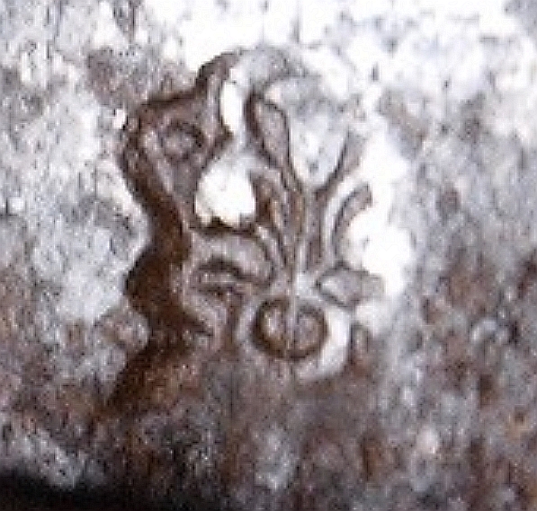

... But it underlines the good possibility to be Dutch. ...
The Blade, at least, looks Dutch from the two tulips stamp. The more I look, the more tulipy the flowers look.
Old 6th May 2022, 05:50 AM   #39
AHorsa
AHorsa's Avatar
Join Date: May 2014
Location: Rhineland
Posts: 385
That´s a pretty interesting point! I did never pay attention to the form of the flower. Just looked at it as a flower pot mark. It indeed looks pretty much like the flower pot is filled with tulips! On the other hand the running wolf mark is mostly attributed to Solingen...
Old 6th May 2022, 09:43 AM   #40
Posts: 4,281
A Photo of the wolf would be nice.

Posts: 385
Of course
Old 7th May 2022, 08:02 AM   #42
Posts: 4,281
Thanks, wolf & Tulips add a conundrum to the enigma.
