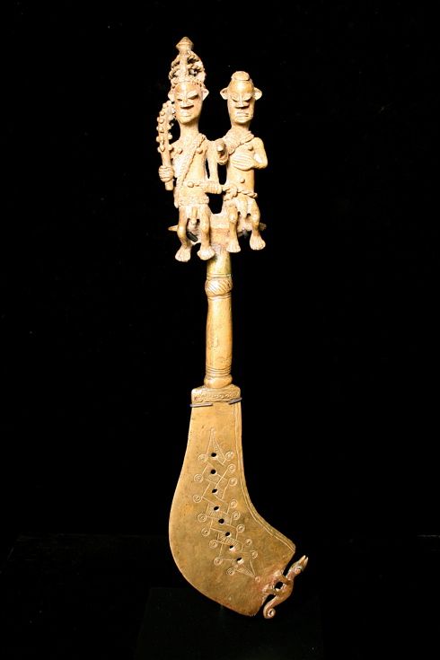

Whilst dabbling in African weapons I found this....see https://www.pinterest.com/pin/393009504964550873/
Old 27th August 2017, 08:56 PM   #10
Posts: 10,788
Great examples Ibrahiim!
One thing I have been wondering,
That distinct four armed cross pierced into the blade near distal end on many of these.....they seem to correspond to the cross piercing on the Portuguese 15th century+ 'navigator (or 'black') swords of crab claw type in that the qullon discs of these often have such crosses.
Could the Yoruba possibly have incorporated this symbol into their symbolic devices in their religion? The symbol is not necessarily consistant but seems to often occur on Yoruba ceremonial type weapons from areas from Togo, through Benin into Nigeria in variation.
Old 27th August 2017, 09:55 PM   #11

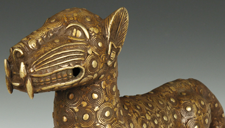

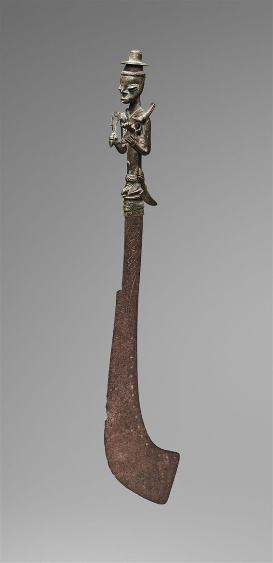

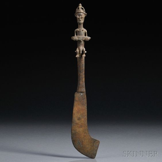

In selecting this line up below there are some I have various questions about which I think I can find answers in due course thus your comments are welcomed.
My immediate reaction is that west African weapons must be related inter tribally as borne out by the similarities in these golock styles...The tendency to call them ceremonial is always there but my thought is that ceremonial may extend at least to executions... which were a sort of ceremonial Indeed if they were only ceremonial why would they poison the blades..Thus I suggest these also were used in battle.
The depiction of a lion is interesting as being the big cat favoured by the tribal kings and not as once suggested as some sort of spin back from the Portuguese influence in the Indian Ocean and copied or taken from Kastane in Ceylon. The sword from http://www.vikingsword.com/vb/showth...8&page=2&pp=30 at #52 is shown below as fig 11 and is clearly a Lion Head but the accompanying literature assumes an Indian Ocean influence which of course it is CERTAINLY not.
In that case it is on a hilt and below it appears on hilts and on the blade in cut out form. It is suggested that in the case of West African designs this is a home grown device.
In looking at the cross geometry + cut into the blade; I include the Black Crab quillons device favoured by the Portuguese shown below but am unable to say if this is co-incidental or copied in regard to the tribal blade. Religion seems a far off indicator and knowing the several uses of the cross format I tend to rule that out; although black magic "as a religion" may rule this straight back in !!
So some artwork~

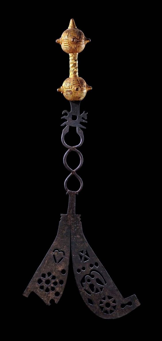

Of the Asante type shown below the British Museum says Quote"~...
Description.
A state sword (afena) with slightly curved cast iron blade, pierced along the lower cutting edge with two arrow-shaped voids and an equal-arm cross motif. These voids are surrounded by punched line and dot patterns. Near the hilt there are two incised grooves filled with a herringbone pattern and five circular punch marks. The wooden hilt is bar-bell-shaped and has distinctive rounded pommels either end of the grip. The hilt is decorated with a series of carved geometric designs which were originally covered with gold leaf secured by small gold-covered (?) staples but only a small amount remains in place.
Dimensions
Length: 34 centimetres
Width: 4.5 centimetres
Condition
Fair, extensive loss of gold leaf on carved hilt, with remianing traces in a fragile condition.
Curator's comments
It is not known when swords were introduced into area now known as Ghana but early examples probably derive from Islamic weapons that were passed down the trans-Saharan trade routes. The use of swords in Akan society was recorded by the end of the sixteenth century and they have continued to play a significant role in ritual and ceremonial contexts ever since. There are several distinct types of state swords normally found in the regalia of an important leader or paramount chief. By far the most important of the ceremonial swords are the keteanofena (literally; edge of the sleeping mat swords) which are revered and are passed from one ruler to his successor as a major portion of state regalia. This group is composed of two major sub-divisions the akrafena and the bosomfena. Akrafena, or ‘swords of the soul’ are used, as their name suggests, in fairly restricted, often private rituals for the purification of the ruler’s soul and the purification of the blackened state stools while swords in the second division the bosomfena play a more varied and public role.
These two groups of swords embody and represent two distinct spiritual elements; those on the Asantehene’s right (akrafena) represent his soul or life-force (kra), those on the left (bosomfena), his ego, spirit or personality (sunsum) that was inherited from his father. Elders also swear allegiance to their ruler on these swords and they may be carried as badges of office for a ruler’s messengers.
This small sword is the same shape as the larger state swords which suggests that it functioned in a similar way." Unquote.

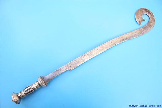

I noted an extraordinary sword example from this region with a standard hilt but zoo omorhic and geometric blade including a Cross already dealt with. The snake is particularly interesting.
Wikepedia notes Quote" In Africa the chief centre of serpent worship was Dahomey, but the cult of the python seems to have been of exotic origin, dating back to the first quarter of the 17th century. By the conquest of Whydah the Dahomeyans were brought in contact with a people of serpent worshippers, and ended by adopting from them the beliefs which they at first despised.
At Whydah, the chief centre, there is a serpent temple, tenanted by some fifty snakes. Every python of the danh-gbi kind must be treated with respect, and death is the penalty for killing one, even by accident. Danh-gbi has numerous wives, who until 1857 took part in a public procession from which the profane crowd was excluded; a python was carried round the town in a hammock, perhaps as a ceremony for the expulsion of evils.
The rainbow-god of the Ashanti was also conceived to have the form of a snake. His messenger was said to be a small variety of boa, but only certain individuals, not the whole species, were sacred.
In many parts of Africa the serpent is looked upon as the incarnation of deceased relatives. Among the Amazulu, as among the Betsileo of Madagascar, certain species are assigned as the abode of certain classes. The Maasai, on the other hand, regard each species as the habitat of a particular family of the tribe."Unquote.
Tortoise Note the Tortoise between the hilt and the snake. See http://www.allfolktales.com/folktales.php for some of the important West African Myths and stories concerning the Tortoise which was revered as being the cleverest animal and a legendary force ..

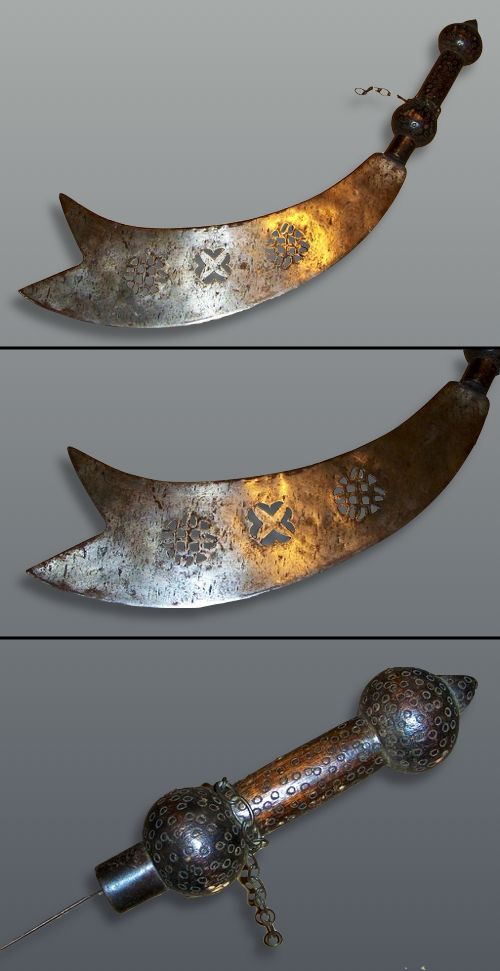

In reviewing much of the material researched and presented which concern the notable Portuguese influences which prevailed in these regions, it is of course interesting to consider the occurrence of this cross motif in many of these West African sword blades.
With the Portuguese swords known variously as 'crab claw'; 'navigator' and 'black swords' colloquially, it has been established that many of these medieval form swords have equilateral crosses pierced in their discoid quillon terminals. It has further appeared that these openwork crosses seem to occur notably on examples of these swords which appear to be of colonial workmanship, thus probably produced in these West African regions.
In Burton, "Book of the Sword" (1884, p.165) he describes one of these swords illustrated same page line drawing (but with simple apertures in the quillons, not crosses) , "...upon the glorious Congo river, I was shown a sword belonging to the Mijolos or Mijeres, a tribe inhabiting the upper valley. All declared it to be of native make, and used during the sword-dance in the presence of the prince. But it is an evident copy of some weapon of the 15th century; and the knightly model , like that of the mpangwe (fan) cross bow, had drifted into the African interior. The handle and pommel were of ivory, the guard was a thin bar of iron springing from the junction of the blade and grip, forming an open oval shape pas d'ane below and prolonged upwards and downwards in two quillons or branches, parallel with the hilt and protecting the hand. The blade, which had a tang for heftng, was straight, flexible and double edged".
This is footnoted as well citing "The Cataracts of the Congo", p.234.
Clearly the sword described is one of these Portuguese swords, and its diffusion eastward into the Congo is of course understandable. The absence of the crosses in the terminals is notable, and would certainly have been elaborated on if present, in the Victorian convention of drawing the connection to the crusades and occurrence of such weapons in native context at every opportunity.
Returning to the west, and the dilemma of whether the cross in the quillons of Portuguese colonial swords of this form influenced the native swords of these 'cutlasses' or vice versa, it is surely a quandary.
It is understandable that European observers would characterize the equilateral cross, if seen in native context, as a 'Greek' cross, well known in European heraldry and Christian symbolism. These were of course, the very cross of the crusades in many cases, so the previously mentioned conventions of course would likely be in place.
While we have determined that these and similar equilateral crosses are probably not of the ilk of the Vodun or Obo types which seem of course in use later and with cross diffusion to Caribbean, it does seem quite possible they were known in the earlier native religious contexts of these regions.
These simple crosses are well established into prehistoric times and quite universally, so much so that most scholars are inclined to consider them convergent and unlikely to be connected empirically.
Still, one can imagine that the appearance of such a cross symbol would have been construed dramatically by arriving Portuguese, and vice versa, the natives seeing such device with them equally construed. The orders, such as the Order of Calatrava, certainly potentially present, might have provided such basis.
I suppose the question is, just how often and in what character, were equilateral crosses used on Portuguese (or other) sword hilts, especially in pierced openwork in this fashion. It is intriguing to consider that the use of openwork designs, devices and profiling is profoundly the character of these native ceremonial 'cutlasses', and perhaps this application was carried into the colonial made swords of Portuguese form.
Which came first?

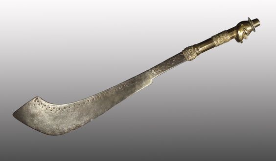

The Cross Part 4
Substantial evidence exists to support the agreed Christianity Conversion in West Africa...Reference A states that Quote"Missionary documents from the seventeenth century claimed that they had found a people who believed in a single god but did not know his name."Unquote. and clearly the Cross on Swords in the region comes from that situation. This process took an opposite view to the way the Spanish did it by force compelling them to convert in South America and the Portuguese suggested that the West Africans had already found God but simply had not realized it. All they actually needed to do was convince them that this was what they already believed in ...an entirely different approach and one which was highly successful...
What I have trouble with is the time line... Notwithstanding the discussion I admire very much the picture below of the Church being constructed in the early period of Portuguese presence in West Africa which I think is about 1491 although I cannot be certain.This is from #165 on http://www.vikingsword.com/vb/showth...1&page=6&pp=30
Please note the two chieftains at right with swords at the waist in typical West African machete style and consider the hilts in this finely engraved picture which so far as I can see is very accurate. Observe the Lion or big cat hilts.
Sri Lanka, however,was not discovered until 1505 by the Portuguese thus this hilt form must be local by definition. I add that big cats lived in the region of course... and that the regal and powerful symbol of the chieftains was seen as enhanced with hilts of this nature. Top class carvers were common in the African region and multiple group carved examples of a highly complex nature were in fact highly prized trade items for the Europeans even before the advent there of slavery.
The cross insignia was dominant across the spectrum and it is acknowledged that crosses on swords and crucifixes were worn by chiefs deliberating on tribal matters..Ivory carvings were made of Portuguese soldiers (in the traditional African style) adorned with Crosses.
Below the famous scene of the Church being built and another cross decorated weapon from the region is shown for interest.

Other finely carved Ivory items from West African Artisans~The figure with the spear also wearing a Cross. This proves the expertise in Ivory carving in Dahomey thus in addition no reason to seek lion heads from elsewhere particularly a foreign unknown species and style from Ceylon.

In considering the big cats... and which one... since all could be admired ...It is certain that the Lion is the fore runner in this regard. The Great King Ghezo was succeeded by King Glele who reigned from 1858 until 1889; He revered the lion as seen in the weapons of war and authority below.. and illustrating how the lion was further incorporated into weapons design...enhancing its known appearance on hilts.
Old 9th September 2017, 12:36 PM   #30
Ibrahiim al Balooshi
Ibrahiim al Balooshi's Avatar
Join Date: Jul 2006
Posts: 4,408
Default Big Cat ...Dahomey kings preferred....?
Well which was it? Lions or Leopards....This reference indicates a strong preference for Leopards...
http://www.beprimitive.com/stories-d...-royal-leopard
On the other hand ...The lion was the personal symbol of King Glele, ruler of Dahomey (now the Republic of Benin) who reigned from 1858 to 1889. It was also used in a variety of objects to link relatives and would-be allies to the royal power.
Below two masks One Leopard the other Lion.
