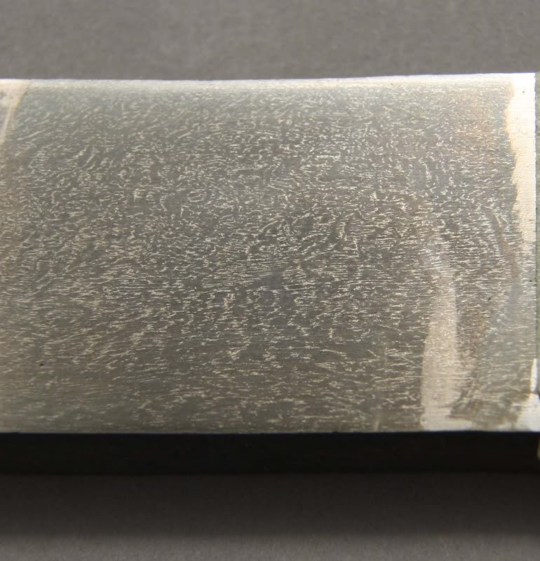

Originally Posted by Emanuel
If you polish and etch an old wootz cake/ingot you see the pattern. No forging required.

No Eric, of course I am not suggesting that.
My apologies as I am no smith and all I write is based on what I've learned from others. What I have been saying again and again is that the fine watery pattern seen on wootz metal is a result of the initial smelting process. Yes the pattern can be modified mechanically through forging of the cake/ingot/billet into a bar or blade, or whatever at a later stage. The point is that if the smelting process was successful, the basic pattern will be there in the cake as soon as you remove it from the crucible. Temperature control and correct charging of the crucible seem to be the critical factors to getting a good quality steel with a pattern.
The forging process is a separate thing altogether. Temperature control is again key to maintain small grain in the material. Large grain will make it brittle. The process for forging a wootz vs. non-wootz billet will be similar but the range of temperature a wootz billet will take is smaller since the pattern breaks down at higher temperatures. A bladesmith that does not know these temperature constraints will ruin the fine wootz pattern no matter what he does.

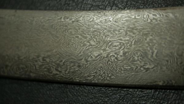

Jim,
Anosov shoud be honored for his re-discovery of the process of obtaining raw wootz material and his insight that it should be forged at low temperatures. However, he simply did not have access to the old "recipe" of forging complex patterns ( akin to Taban/Khorasan). In his defence, only one of the contemporary wootz smiths is capable of doing it, and doing it with long blades.
There is a lot of information on Anosov's blades in the new book by Kirill Rivkin. He also characterizes them as pretty simple .
AFAIK, his blades were never produced for mass use or export; he made only a few examples. I am unaware of his blades being used as fighting implements anywhere in the world.
He published his report in 1841, but was transferred as a governor to Tomsk in 1847, where he could not continue his work.
After his departure production of bulat in Zlatoust has stopped: his instructions about the process were deliberately brief and incomplete. A couple of workers in Zlatoust who actually did the job, produced a small number of blades, and then it was just like in India and Iran: skill transfer stopped and the secret was lost again.

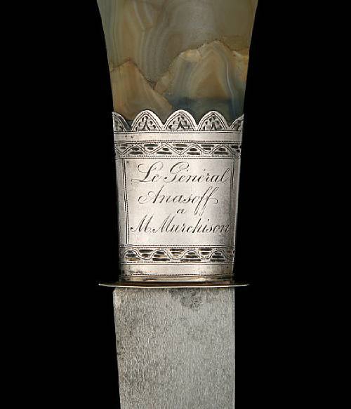

As an example of Anosov's bulat ( wootz) work, here is his famous hunting knife that he presented to British geologist Murchison who visited Zlatoust.
It was sold at Sothebys (?) for something like 50,000 GBP ( I might be wrong here, but the sum was obscenely high)
Another one is his shashka: look at the pattern, pretty coarse and simple.
It is bulat, no doubt, but in the best possible case it is Sham.

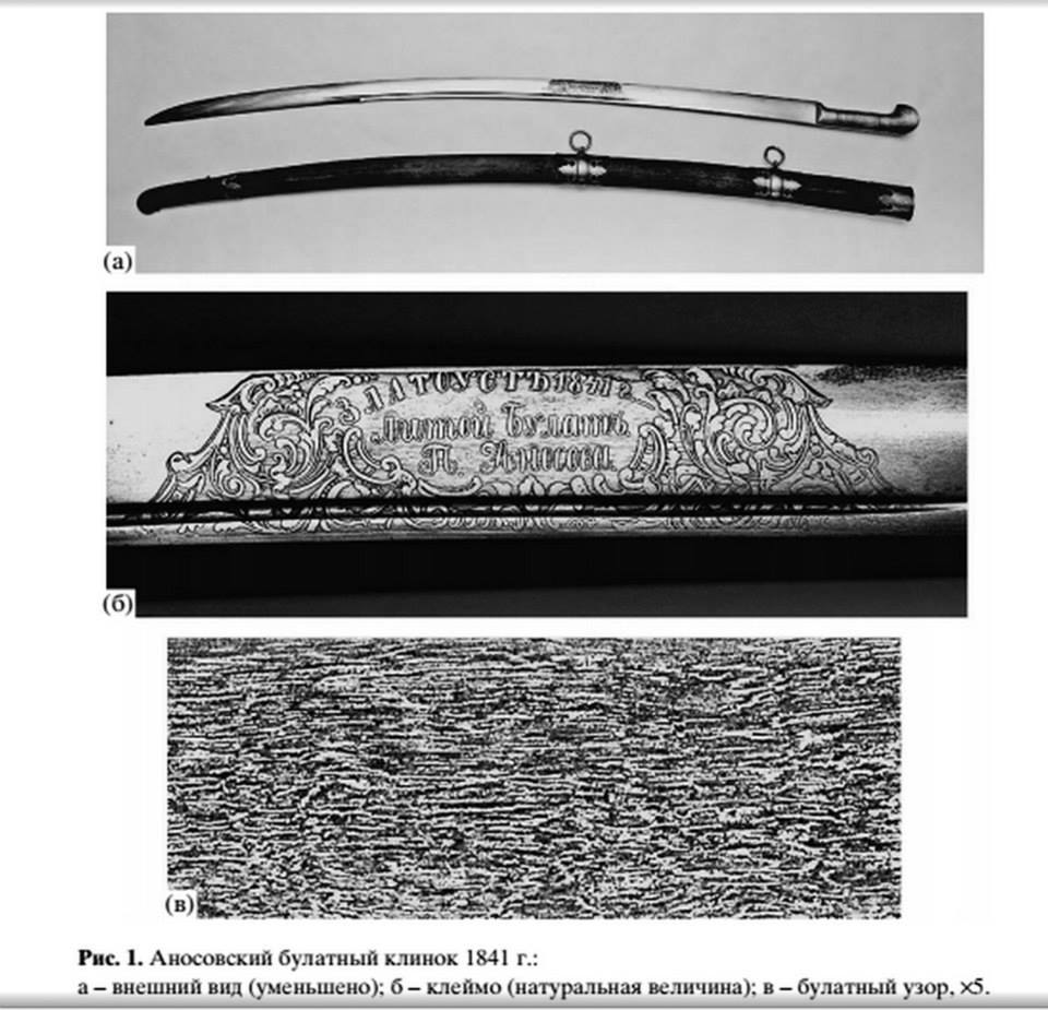

I would love to see a documented Anosov's blade with Taban or Khorasan pattern. In the absence of such, quotations from popular magazines carry very little value.
Not for nothing he presented his creations as "Russian bulat" instead of specific names. All of them that I know were of a simple Sham structure.
I do not support reading popular magazines and books published today. I prefer to read historical sources. So I read Anosov and what he wrote about his work. I think there is no doubt in the words Anosova?
I understand that many in the forum do not speak Russian, so I give the translation, the selected phrase:
1) etching on the plate (wootz) were large curls (tracery), "Kara-Khorasan". Another experiment was repeated with a simple iron. The same result was obtained. Resulting in a small plate wootz was also a "Kara-Khorasan".
2) Get the "Taban" (think about it, "Kara-Taban") with medium curls (tracery) and a dark background.

I have shown pictures of 2 Anosov's blades: both are Sham.
Any PICTURES of documented Anosov's blades with Taban or Khorasan?
Nothing less than that will suffice.

I showed pages of authentic books Anosov of wootz (1841). I hope no one will argue that Anosov - written with no errors? (He understood the wootz) At the same time, I did not say that did not Anosov damask blades of Wootz steel such as "Sham". There were more than other blades. But did Anosov and "Kara-Khorasan" and "Taban".
On one blade of the "Kara-Khorasan" had 10-20 blades from "Sham". Can someone show 10 blades Anosova? I think the analogy is clear? Blades Anosov save too little. But Hermitage has blade Anosov of wootz steel "Kara Khorasan". Anyone can go to St. Petersburg and look at this blade.

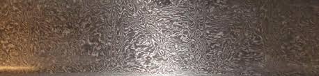

Old 22nd February 2016, 10:45 PM   #140

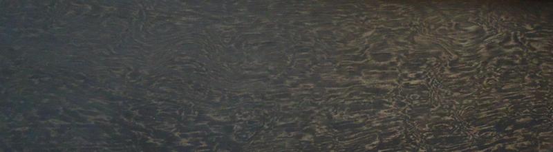

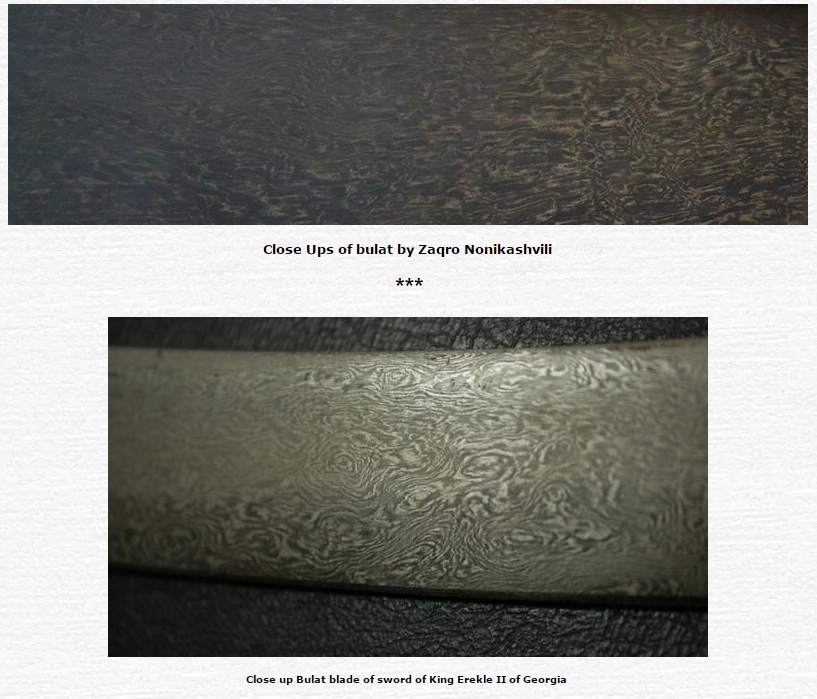

The REAL modern wootz!
I give you examples of bulat blades by a Georgian master Zaqro Nonikashvili.
Last edited by Jim McDougall; 23rd February 2016 at 12:02 AM. Reason: confrontational wording
Here is a link to an excellent article which explains Zaqro Nonikashvili's "Georgian crucible steel technique".
http://ceroart.revues.org/2557?lang=en
estcrh is offline
Old 23rd February 2016, 12:55 AM   #145
Emanuel
Emanuel's Avatar
Join Date: Jul 2005
Location: Toronto, Canada
Posts: 1,242
Mind you, my comment is specifically about the kirk narduban, not the kara khorasan.
Thank you Ariel and Eric! Magnificent stuff!
Emanuel is offline
Old 23rd February 2016, 01:18 AM   #146
Indeed, magnificent!
Just to think that the guy managed to reproduce the most difficult wootz patterns without having any theoretical ( written) or practical ( apprenticeship) help.
This is a work of a true genius. He is a Mozart of wootz.

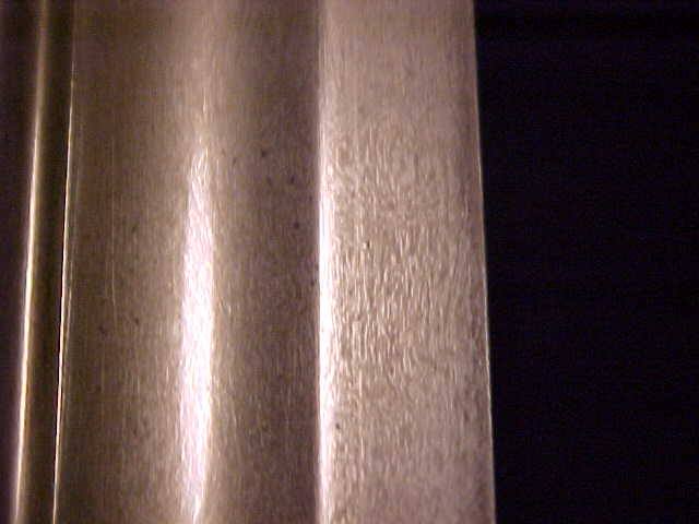

Ariel,
I do not believe the top 2 images shown in above Post#140 are modern production. The lower image is more like it. I think the 2 above are closeups of genuine antique blades added for marketing purposes, as to show what wootz/bulat looks like, casually adding Zaqro Nonikashvili name into association.
ALEX is offline
Old 23rd February 2016, 01:45 PM   #149
ALEX
ALEX's Avatar
Posts: 936
Originally Posted by ALEX
Ariel,
... just to be clear on who's who.
ALEX is offline

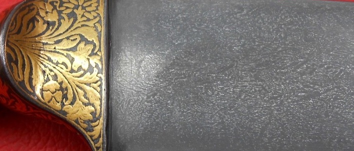

Old 23rd February 2016, 01:54 PM   #150
ALEX
ALEX's Avatar
Posts: 936
here's closeup of a modern Indian-made Kard that can be picked up for under $200, and not the best by far. There are wootz(?) ingots with better "structure" readily available for less than $100. I do not understand what is the big deal with Russian geniuses creating unimaginable bulat masterpieces? Are they any different or am I missing something?
ALEX is offline
