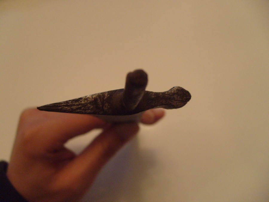

danny1976

Some more photo,s .
Sorry that the are so big.

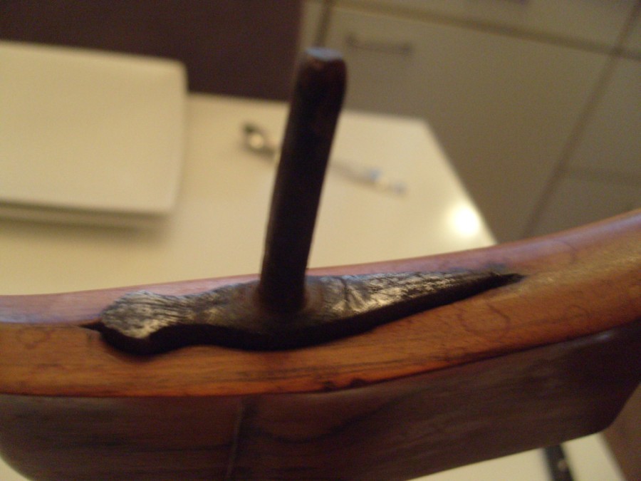

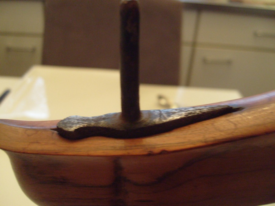

Posts: 245
Guys , here some photo,s of the peksi.
If the ganja is lost or removed it happend a long time ago , there is no diffrence in collor on the peksi and the peksi has the same collor tone as the blade.
Any body has a idea for the age from the blade.
danny1976 is offline   Reply With Quote
