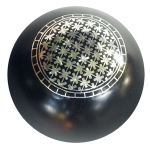

Smile Bidri ware hilt intact
Hello Guys,
this is a very interesting post.
Here's picture of an intact Tulwar hilt with bidri ware. Same decorations like Emanuel's. Blade has also same "eyelash"-mark, but also some cartridges. Maybe sanskrit? I don't know. I am a greenhorn with indian edged weapons.
The last finish for bidri ware is made with a special paste after the inlays are made. It makes the bidri ware smooth and black without harming the inlays. The paste contents a secret substance (acid), which is gained only on side (Bidar).True ?
You can find kinds of informations on homepages of dealers from modern bidri ware.
Hilt is not complete cleaned yet. There are no blemishes.
kind regards
and still a merry chrismas
Enibas
Sorry for bad english

Hi Enibas,
Interesting hilt you are showing. Please show the whole tulwar, and can you show a sharp close up of part of the hilt decoration, together with a picture of the top of the disc? Is the blade watered or pattern welded? Please show any decorations/markings on the blade in close ups.
We all try to learn something on this forum, so dont worry.
Jens

Hi Jens und all,
you are just kidding me... sharp close ups.... Camera hates me!
But I am gonna try my best next days, please a little bit endurance.
Blade: no pattern visible. I guess, it's forged by preindustrial iron,but I cannot be sure.
kind regards
me
