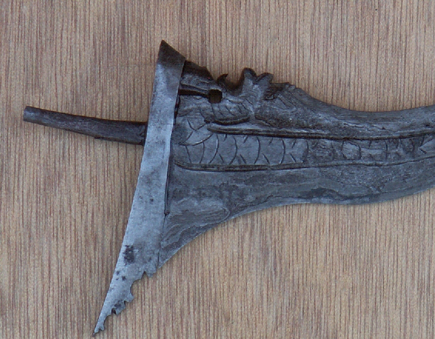

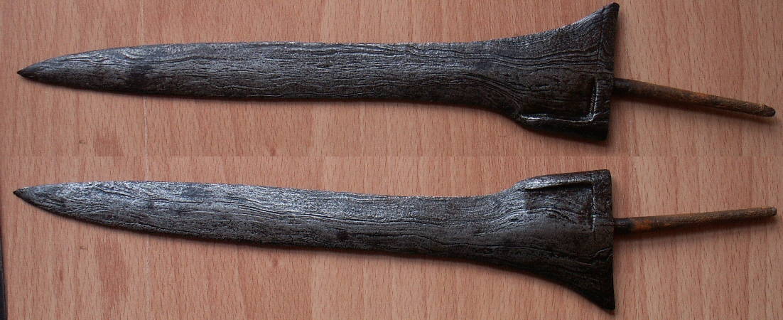

The other keris with naga at the blade is recent and from cheap quality. The third blade seems to be old and good. It is a iras blade where the ganja is not separate.

Third keris appears to be ganja iras .

The third keris looks like it is a kebo dhapur, meaning the the gandik is longer than on other keris. Such keris are often said to be good for those involved in agriculture. I would agree that the hilt doesn't seem a good fit (stylistically), though it is an interesting one. Was there a sheath for this one?

The first is a nice Bugis piece. The hilt is marine ivory. Probably not from Sulawesi but from other bugis-influenced regions such as Sumatra or Sumbawa, based on a few indicators. The second blade seems to be a crude Pattani naga form, Malay Peninsular.. can we have close-up pics of the gandik area of the blade (where the serpent's head is), and close-up of the hilt, from various angles, the front and side. Nice Coteng or Tajong form. The third is a ganja iras blade form with pamor adeg. Hilt is probably made from bone, based on the porous inner carved area. The hilt does not sit well, probably due to a missing mendak.

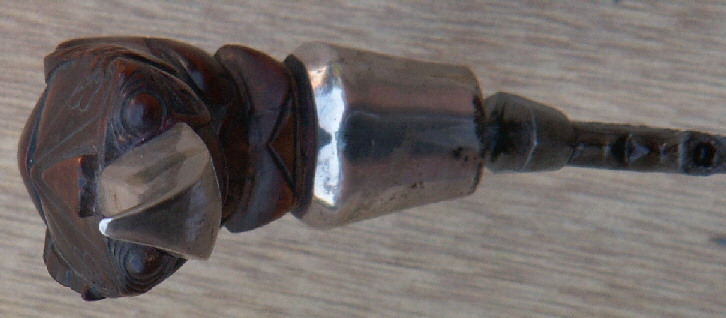

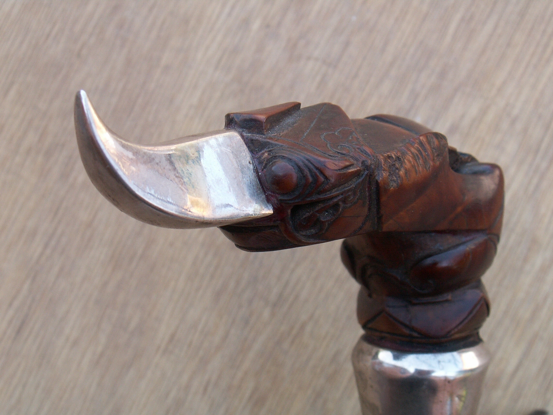

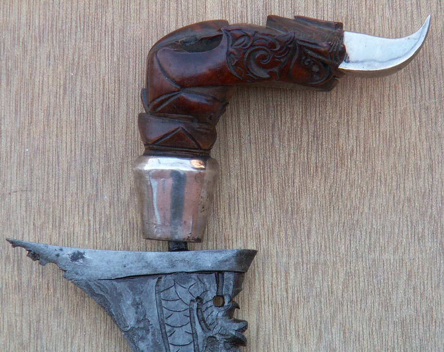

The kingfisher hilt was the reason I bought the second piece. I was told later by another collector that the fellow I bought it from once had a large collection of these but after retirement he has sold them all and I got the last one. No sheath I'm afraid. I've attached a few more pictures of this one.

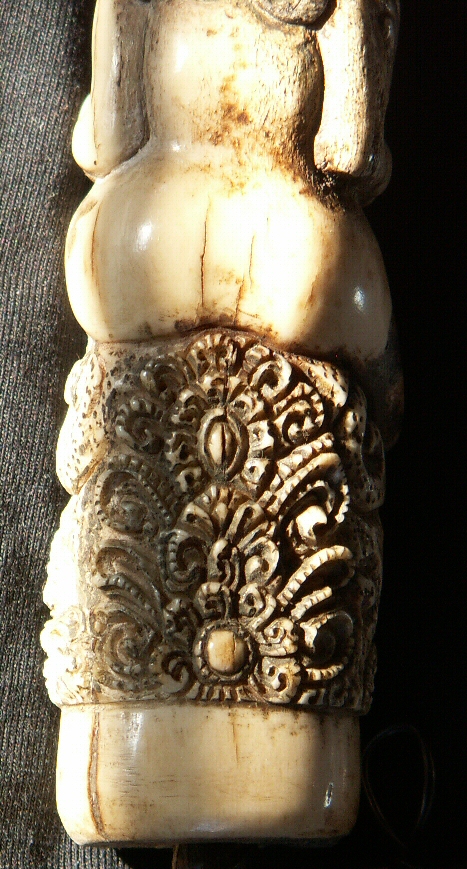

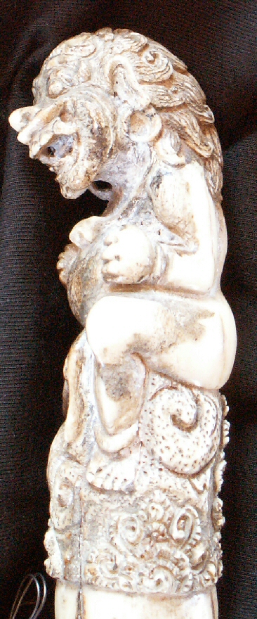

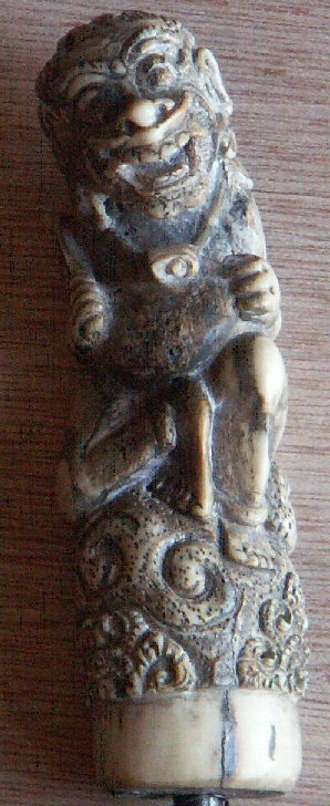

The third piece I was told was from Bali and about 300 years old (the bone hilt certainly gives the impression of some serious age). As far as I can find out the figure is a representation of agressive Shiva Bhairava sitting in Rajalilisana position.
Is it possible to determine whether the hilt and blade have the same origins, and if so figure out what type of sheath and mendak I would need to find to complete the piece? I can see some new ones for sale on the web so I guess they can also make replacement parts.

I thought so, too. It's a Tajong form, more info (( here )). The blade tang seems to have been shortened. The naga form is Pattanese, crude and is probably not too old.

The third piece is not Bali. The hilt is from North Java, Cirebon imho. The blade is gonjo iras indeed.

Can we have a few pics of the 3rd hilt, from the front and from the other side.. and a full pic of the blade, please.

in my first look I haven't seen the very nice and old Tajong hilt because I don't skroll the picture to the right.

Hi Alam Shah
here are a few more pictures of the third piece for you.
Thanks for the Tajong link. Looking at this suggests that mine is quite old, which I had not expected
Chris

A Kebo with ganja iras; nice blade . IMHO

I'm sorry, I was referring to the dapur of this blade; I should have said kebo lajer and completed the name ..

Sorry Chris, but i think i did describe that for you, though perhaps it need a bit more explanation. I believe that literally "kebo" refers to a water buffalo, but in the context keris dhapurs it refers to a category of keris that have an enlongated gandik, that area at the front base of your blade. This i believe would be classified a kebo lajer. If it had a sekar kacang (the sort of abstract "elephant head" you see on many keris) then it might be kebo teki. Here is a link to a diagram that names parts of the Javanese keris:

Does this information help narrow down the origin and/or age. Henk suggested Cirebon. The hilt is bone and is of Hindu design, so does that indicate a pre-muslim date?
Mefidk is offline   Reply With Quote
Old 11th May 2009, 08:31 PM   #19
Posts: 7,297
I think that the hilt was a more recent marriage with this blade. Usually not a good idea to judge the origin of the blade from the dress. I would say it is probably a Javanese blade, though i doubt it was pre-Islamic. I think you would need to post a lot more close-ups of details before anyone could nail it down to a specific part of Jawa like Cirebon. Even then it's beyond my skill set, though others here seem much more knowledgeable on such things. The pesi (tang) still looks very intact. While this blade certainly has some age i am not sure it extends much past the 19th century.

So taking the hilt separately I assume if it is from Java and if I have my history of islamic influence correct then it is probably suggests a 16C date for the hilt. Whereas if it came from Bali then it could be much later. Is it possible to determine whether this is the case from pictures? I'd imagine that styles of carving at least would be pretty regional, and perhaps the dates as in the case of the tajong. Or are these assumptions just too simplistic
What I'm also wondering is whether it is normal for a hilt to survive that long and to be attached to a newer blade. I would have imagined that the older examples came with older blades as trophies/trade items from long ago, and that a keris hilt in use was more likely to be damaged and replaced than the blade with all the blade's symbolic importance; hence old blade new hilt would be more normal. However, I suppose what you are saying is that it is most likely that both were collected separately and joined by an earlier collector.
Old 16th May 2009, 01:31 AM   #21
Posts: 6,436
Doubtful that the hilt is from 16C , but one never knows ..
This hilt seems almost a fusion of Balinese and N.Jawa styles; there seems to be no tumpal throne as I know it .
The decorative motifs seem N. Coast .
The surface the figure is sitting on is quite different also.
What does it represent ?
The Sea, the Firmament ?
