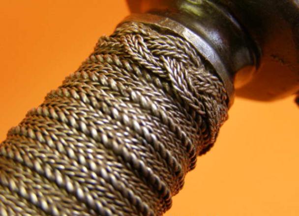

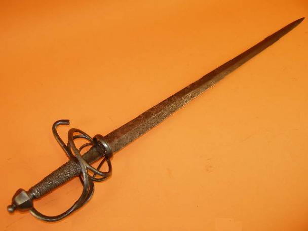

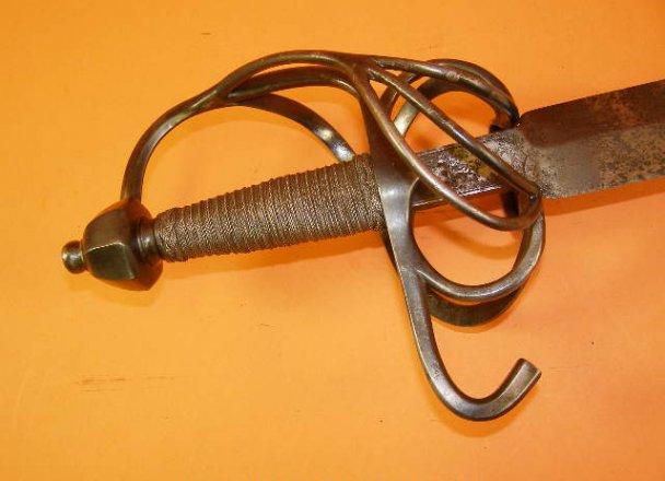

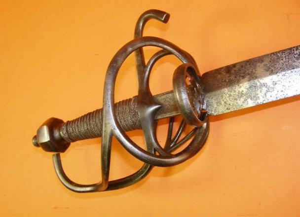

Here it is.
Is that the so called muenchen town watch sword?

100% a German Sword, those swords are also made in other German cities,
I think stantler initiated those type end of 16thC in Munich.
your sword is a (later) variation of the town watch sword.
the pommel is atypical for what you would expect at the Munich town watch sword and the sword can be dated a bit later 1625-1640.
(so difficult to proof but it can be made by Tesche Solingen as mentioned in my previous reply, .....................it also can be not)

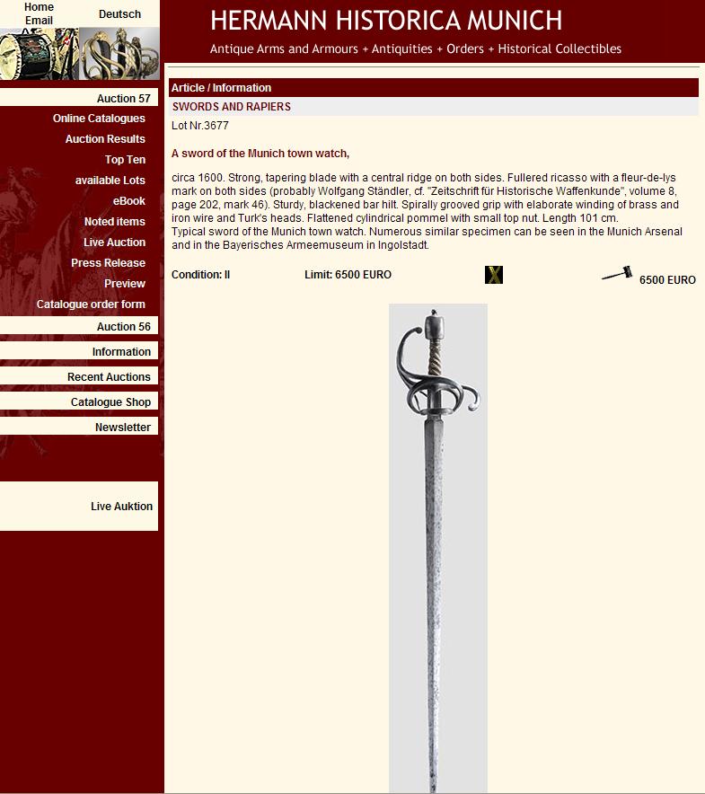

I understood the German Munich Town guards/watch were formed after a military model and were all provided with the same armour and a Stantler type town watch sword/rapier. Maybe Michael can tell us more about this.
for this sword type see the last auction of
http://www.hermann-historica.com/
lot 3677
best regards

6.500 + 23% buyers commision???
WTF???
I hadn't realise, that it has such a value! WOW!
Anybody interested?

Gents, many thanks to all of you, especially to cornelistromp, for your research and comments.
Having that gem in my collection, I've became somehow interested in that field. Can you advise with some literature?
Thank you!
Here are the rest of the pics:
