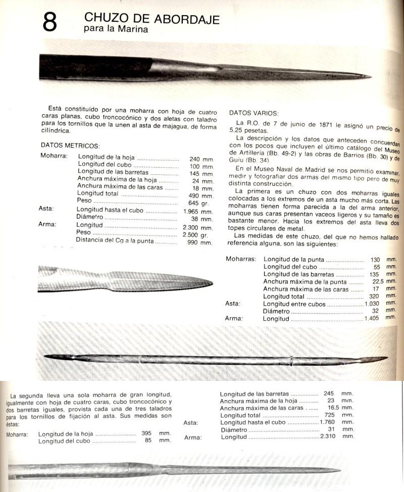

No chance you show us pictures of your pike?
I wouldn't know about Spanish colonial versions (or any other ), but i can see that 'homeland' versions had langets, if you mean by langets the side straps that fix the socket to the haft.
Here you have the Spanish boarding pike (chuzo) model from circa 1820, with description and measurements of blade but no mention to the haft, and a later model (1870's), followed by two other variations residing at the Naval museum of Madrid, being one with two heads. Haft lengths on the classic versions are 1,76 mt. and 1,96 mt. The double headed one is exceptionaly short, with 1 metre. no mention to what type of wood was used in any of them.
I hope this is usefull ... at all

Model 1820 is posted in a bizarre attachment; i hope you can open it. Otherwise, just tell.
Fernando

Thanks, Fernando, for posting these important pics. Material on boarding pikes, much like other naval weapons, is hard to find. My piece is much more primitive, not like those made for the Sapnish naval vessels, but more like what you might see on a privateer or merchant ship in the New World. It's blade is more leaf-shaped, placing it in the pre-1800 time frame. I will attempt to post a pic soon, as I do wish to get others input on it. Thanks again for posting those pics. I've heard of, but never seen the double-headed pikes (chuzo). You'd have to be pretty daring to have to face one of them while clambering over the rail of a ship!!

Chuzos are simply metal spikes attached to poles, not necessarily a double headed lance. Often times, a bayonet attached to a pole would be called a chuzo.
They made poor weapon choices against a bayonetted musket, and were mostly used by irregulars guarding supply depots, or within cities and towns by "Urban Guards"...

Please notice the "chuzo" presented here is of 19th C make, and measures almost seven feet, which is too short for a "true" pike, like those used by the Tercios. OTOH, just like pikes, chuzos were not designed to be thrown, like a true lance or Roman pilum would.
Then, many "lances" were never meant to be thrown, like the ones used in jousting.
This type of weapon is designed to be held, and for stabbing, like a japanese yari.
In Spain, often times the terms pikes and lances are used interchangeably, although if it has a hatchet or hook at its end, it's invariably called a "Pica"(Pike).
I'd like to point out that "chuzo" is a word with negative connotations in regards to quality, sugesting something cheaply made. I fact, any piece of wood may be called a chuzo...
