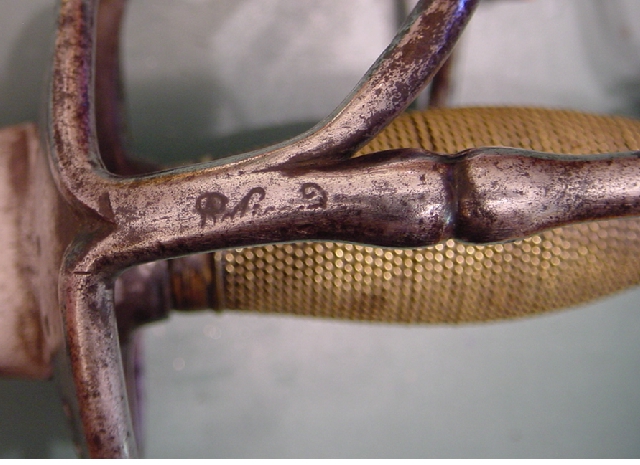

You will notice that, it has been almost two years since i posted this sword. In the meantime i have learned a bit more about it, namely on the typology side. It seems as the Walloon term has been used (and abused) to define the swords within a detemined area of characteristics. Such is the case of my example; having bought it as being a Wallon sword, i later learned that it is in fact, as you well alert, a Dragoon sword ... although, i repeat, it falls within the Walloon range in several sources.
As for its country of origin, that is indeed my actual concern. Certainly the (regimental) marks in the pommel would bring some light to it but, so far, no one has yet identified them.
Worthy of note is what seems to be the signature of its ownner/user in one of its guard branches.

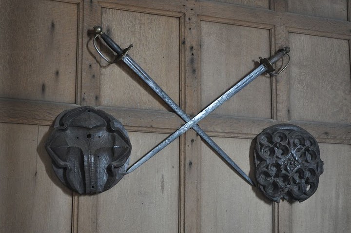

Green plus three here to see these in other hands. I am wondering about this pair attached below. Obviously later than the Walloons but seem in kind to some other early 18th century pallasch. The swords were espied in the Haddon Hall in Derbyshire. A bit of looking about shows Haddon Hall pretty much redone and any association might be pretty vague but one thought was that they were late 18th century heavy cavalry dress swords. While the 1796 dress might somewhat resemble these, I couldn't agree and was figuring they must be a good bit earlier.
I am afraid I am probably and terminally stuck pursuing early Americana but the Walloons and later pallasch somehow seem to be part of the natural progressions of straight cavalry swords.
Cheers
GC
