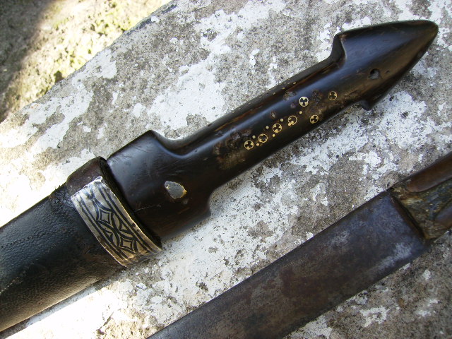

Here is an interesting hilt. The qama on the picture is currently in Bulgaria, but I have been told that it was initially acquired in Istanbul recently. I think it safe to characterize the qama as Turkish.
If Chalres's sword was indeed exported initially to Southern Arabia, what are the chances it made it to Northern Arabia? To me it seems that the hilt inserts are Turkish or Turkish influenced.
