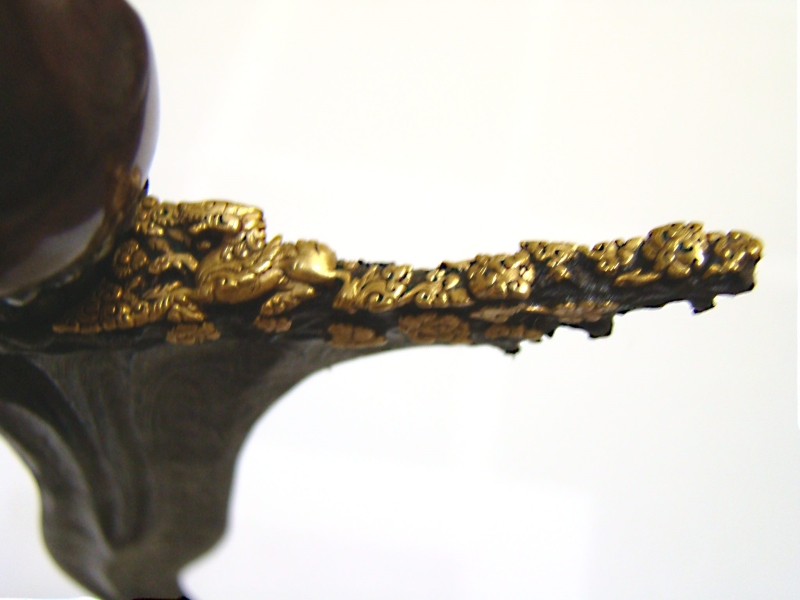

It has been noted that the Javanese gold work is recognized as the best in that the blade is carved and heavily prepared to accept lumps of gold which are hammered on to the prepared surfaces. This gold is then carved to provide the final effect the goldsmith wishes. This work was thought so highly of that people who could afford it sent pieces from the other islands to Java to have this work done and possibly provided for Javanese goldsmiths to reside on their islands while they accomplished this type of work.
The first piece that is used to illustrate this technique follows. Note that the gold has been dislodged and lost in portions of this piece which allows you to see how the iron was prepared. This happens over time no matter how careful the owner is. Of course sometimes an owner strips the gold off of a piece and sells it for its raw material value if he falls upon hard times.
Note the missing gold on the hip of the Singa and some of the missing stems and flowers on the ganja.

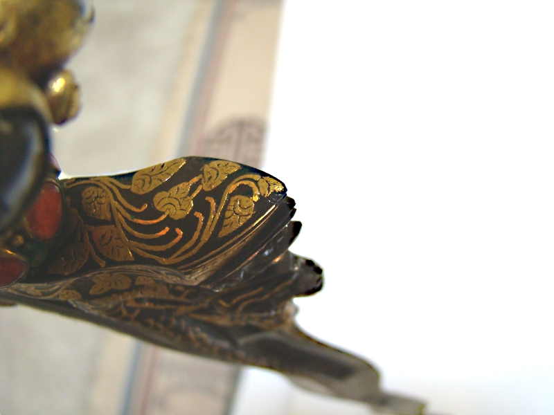

The next example is one of the famous pieces that (I think) have appeared in greater numbers than could be explained by the story of their creation. Their quality ranges from exquisite to horrible. The Solyoms illustrate one of the highest quality pieces in their catalog for their exhibition at the East West Center in Hawaii. This piece is not as good as that one, but it is one of the better ones around and with another identifying mark could possibly be one of the original ones or an official copy prepared for the same type of award.

This piece is a standard of the type of work done in Sumatra. This piece illustrates the type of preparation work done on the iron to help affix to gold to the blade. It is done similar to the Javanese work, but not as well. This allows for the entire gold cap to peel off easily once it starts to come loose so many of the old pieces are missing at least a part of the gold as this one. (It also allows the owner to easily strip off the gold if he comes on hard times which would explain some of the pieces that have had all of the gold removed.) Javanese work is applied as separate pieces which do not lend themselves to be as easily removal by accident.

This piece illustrates the work done on Bali. Note the flatness of the gold application. There does not seem to be any heavy preparation work on the iron for the attachment of the gold in the larger areas. In fact, it seems to be installed similar to Indian Koftgari work, but not as well.
