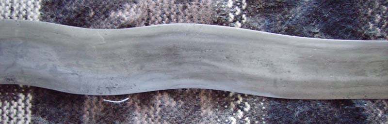

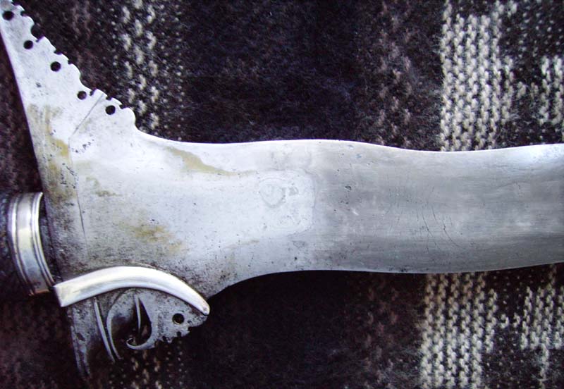

Here is a nice kris that maybe someone already knows I have etched the blade but there is something strange: the area near the gangya shows a clear lamination, but the rest of the blade is black!!! Anyway, even if the pictures are quite bad, you can see a nice lamination. Maybe this is due to many and many deep polishings of the blade that have removed the "superficial" steel, and so the original lamination that is something like you see near the ganya???? Any comment is welcome and appreciated

That is an unexpected occurrence. Is it possible that there are two parts to this blade. ? In the motor trade it might be known as a cut and shut.
I suspect you may have a real winner here... Could you please email larger close-ups of the blade?
The original sandwich construction is certainly still intact: I do see blurry laminations towards the tip of the blade. I think you're just in for some more rounds of polishing and etching to get a very pleasing result - go for it!

Well, since I will not have the time in the next few days to re-polish and re etch the blade I have a more close look at the blade: in on side there are three (maybe four) clear rows that comes from the gangya area untill the point in the middle portion of the blade (the center). On the other side these rows are clear but I can see also some other thinner lines (the others in the center of the blade are 0.6 mm circa of width). In the pictures you can see a photo taken before of the etching: there are some strange, how can I say, "cracks" on the blade....

Hi all!! Well I was so curoius that I can't wait: I have tried but don't seems to be twisted core..... I'm so sorry, I was hoping.... Anyway I haven't taken pictures because it wasn't worth. I have polished and etched twice one side of the blade, one time with cloruric ferric and than with lemon, but nothing. Anyway I will try again on the whole blade with vinegar.... The last chance
Old 26th July 2007, 08:22 AM   #15
Hello Flavio,
Hmm, weird - don't give up unless you get clear evidence for some other pattern!
Please do take close-ups of the blade at each step! Even it may not look pretty there may be more hints on this blade. If these suggest twist core and the blade is just difficult to stain, this may be worth handing over to Philip Tom.

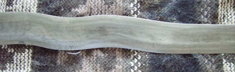

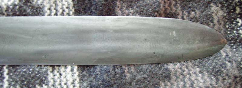

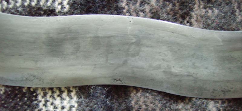

Well, guys, I need all you help here: attached are many (maybe too much ) pictures of the result.... If in some parts seems that the blade could be twisted core, in other no at all!! So please, be so kind to be clear : it's me (i'm not an expert and this is not my field, so no offens) or it's the blade??? Thanks a lot

others

two more

Keep re-etching it - something is coming out, though may be a lamination instead of twistcore.....

I know nothing about these things really but to me it looks like two billets are worked into one here. At what stage the smith decided more metal was needed one cannot tell. It seems clear more material has been added in the forging of this blade, a confluence at the forte is evident. I could be completely barking.

Hi Jose, maybe from pictures it's not so clear, but for sure the blade is laminated (parallel lamination alongs the blade). I have etched the blade for an hour or so with some stops to clear the vinegar with cold water and this is the result. All other weapons that I have etched didn't take so long time to shows the pattern
