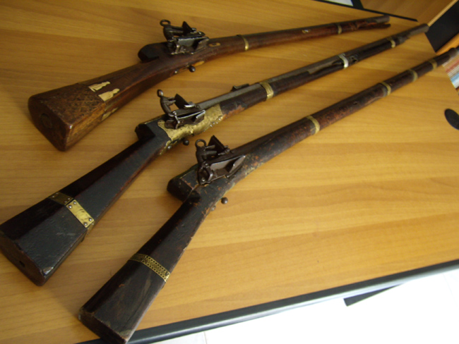

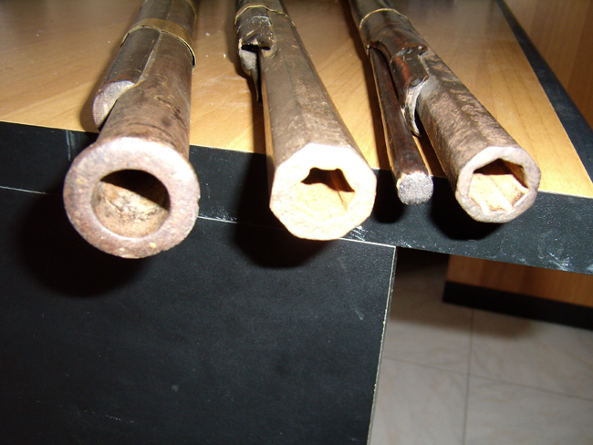

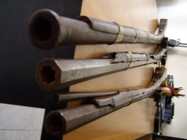

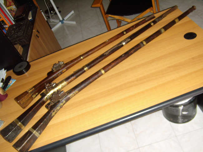

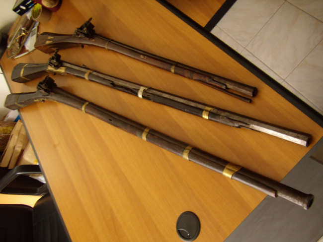

Default 2 more rifles
Hallo, thanks for your comments!
Any comments on the other 2?
The sorter one looks like a typical turkish tufenk -shisane, the other one has a round barell. Is this a simpler construction or an older model?
Old 8th July 2007, 05:19 PM   #5
ward
Join Date: Feb 2006
Posts: 637
The more I look at your first rifle posted I belive it is Turkish made. The second octagonal barell again turkish. The 3rd rounded barrell as a quick look Indian,mounted in a turkish stock type but I would need better pics of the muzzle any markings and it would be helpfull to pull the barell and see pics of the underneath. often it is not oxidized and you can get a better feel for the barell construction to be sure of that
