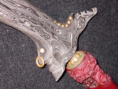

This really a modern keris. But I don't think not "a deconstructive concept" keris yet. This keris is especially designed by Gus Im (younger brother of former Presiden Abdurrahman Wahid) and or course, ornamented with "nose ring" and "tindhik" (gold pins in the blade) as if punk rocker, but made by Madurese keris maker. Many Gus Im's creation on keris, ultra modern. And with certain modern calculation, but also carefully calculate the past tradition during the making of the keris. Gus Im is a Kiai (cleric?) who like rock music, and modern science. Intelectual, but not a narrow-minded person. This keris was exhibited too in the Bentara Budaya Jakarta Keris Exhibition 2006...

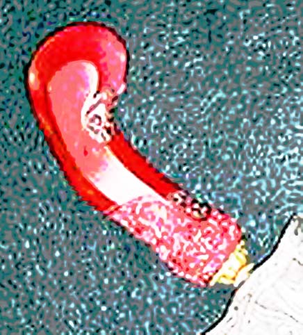

The hilt was especially designed for this keris too. The carving, and the "red" color. And even there is a one karat diamond above the nose ring. Really good diamond. I will close up the hilt, especially for you soon...

This is the close up of the hilt you request... It was made only one piece, and specially designed by Gus Im. (He likes Bon Jovi and Axle Rose). Hope you'll enjoy this "rocker's hilt"...
Old 23rd May 2007, 11:23 PM   #7
Posts: 7,258
Looks like a putri kinurung to me.
The outline does looks similar, but the carvings does not.

The ricikan at the back of the blade (below the 6 gold dots) looks more like a turtle beak. Just my imagination.

Oh yes---you're right---I missed all that foliate carving.I'll try to remember to look at all the pics next time.

I agree with Alan and Shahrial,
So? Maybe it is good to call this rocker's hilt as: "Madurese Putri Kinurung". Another angle from this rocker's keris in this following picture:

I wonder how the blade is sheathed? Won't the gold ring be an obstruction?

Shahrial,
I took this pictures last year. And unfortunately, I forgot to take fotos of the sheath. If I'm not mistaken, the sheath is Solonese gayaman, iras (one piece of wood) and of "jati gembol" wood his favorite. Jati gembol, is the "sick" teak wood, so the grain of the wood is more illustrious. The sheath's hole is normal, maybe a little bit wider in the ring's part. Anyway, no problem with the sheath..

I see... probably a wider opening (cross-cut), to accomodate the ring. Thanks.
