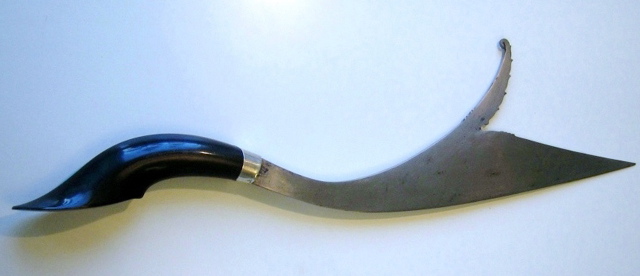

I have problems to find any references on this klewang.
Does anyone recognise it or have any ideas of its origin?
Michael

Hi Michael the crowit the only place where they have this is Borneo the handle type we see on sumatra
Ben

Michael,
The cross marks on the back of the blade is something that I know from both Sumatran Klewangs and from an occasional mandau.
So again, the sumatra Borneo mix...
Bets regards,
Willem

Hi Mikael,
I think its more from Kelatan ( Malay) like the parang Ginah
Arjan.

Thanks for all comments.
Ben, I am not sure that it's a crowit, couldn't it just as well be a kembang
kacang? On the handle which one in Sumatra do you mean?
Willem, on the cross marks they also are found in other regions, f.i. Sulawesi. But I agree that they are common in Sumatra (nice marks on your example!).
The ferrule, that looks a bit Filipino, is also confusing?
And the "whale-shaped" handle?
Arjan, I recognise some traits on the top klewang in the Spirit of Wood book.
So I have checked with a couple of collectors familiar with Kelantanese klewang but they thought it came from Sumatra or Java. I have a couple of Malaysian klewang and parang but this one doesn't have the same feeling when I compare them with this X-klewang. F.i. with this Kelantanese one that is close to the one in the book (picture below).
Michael

As it turns out, there's an example of this type in a museum in Denmark that was collected in Sunda.
See
http://www.vikingsword.com/vb/showthread.php?p=302388
See
Thank you Leif! I always wondered where this type of sword comes from. But it's not a certain proof but a good possibility.
