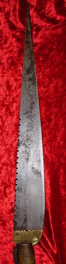

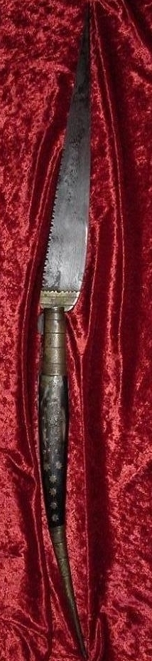

Hi everyone, I am very new to this website and the use of forums, but am not a new comer with collecting edged weapons.
I am hoping someone out there can help me put together some very hard to read script that is found on my pride and joy, being Australian, Spanish in not a language I grew up with.
With the use of internet tranlators I have worked out the first of the three lines found on the blade and only partially deciphered the other two lines.
The first line reads "Si esta vibora te pica no hay remedio en la botica", "If this viper itches to you there is no remedy in the pharmacy".....too right I say, wouldn't want this fella drawn in anger against me.
The second line reads "___ defensora de mi dueno bas ta el _____ ______", " ___ defender of my owner you go to ______ ______".
The third line is " O le ____ __ Grava __ Labra" ....something like "it burdens working to him" with a few words missing.
Those of you in the know, may know of this inscription or be able to fill in the blanks if fluent in Spanish.
I also remember reading in other forum discussions about the Navaja and someone stating how hard some were to open. I must say this one being my fav in my collection is extremely easy to open, just a firm grip in the middle, useing my finger tips to just push the blade free of the horn handle and a flick of the wrist and hey fresto, a 16inch blade ratchets forth. I know why many call these the predesessor to the automatic flick knives we know of today.
Many thanks
Gav

Hi Gav,
Hi, I am very new to this website and the use of forums, but am not new to collecting edged weapons.
Welcome to this forum.
First I must remind all forumites that right up to the the early decades of the 20th century, illiteracy in Spain was the norm, rather than the exception and cutlers coming from the lower classes were notoriously bad spellers. BTW You nerly got it right. The correct translation is: "If this snake bites you, there is no remedy in the pharmacy". "Vibora"is Spanish means snake, not viper as is often but erroneously thought. "Pica" literally means to pierce or sting, but in this instance it obviously refers to a bite.
Starts to get tricky. "defensora de mi dueño" is easy enough and means "defender of my owner".
"bas ta el" does not make much sense. If it is a misspelled "hasta el", which is probable, then it means "until (when)". However if what was intended was "basta el" then that means "(whatever) suffices".
With this I cannot do any better than you. "Grava" means "burden" and "Labra" "to work".
Why don't you give us a photo of the inscription and the navaja?
Most navajas used in Spain in the 19th century were French and fitted with what I call a "demi-lock" using a very powerful spine spring. These were notoriously difficult to open and close. The impediment in opening the ratcheting native variety was, of course, the ratchet. However, as blade size increased and if the the ratchet teeth were few and worn, as well as the pivot pin loosened up, then some could be flung open.
That is an unusually long blade and probably an exhibition piece by a cutler. Most did not exceed 9 inches; Reason being the weight and strength limitations.
Cheers
Chris

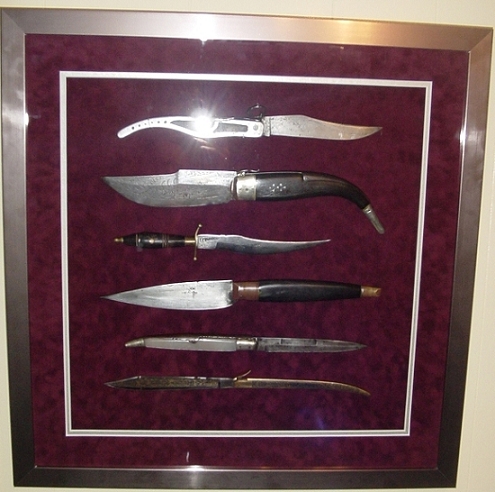

Thanks Chris, and sorry to everyone for a repedative blog, seems I added it three times....newbie to this.
I have uploaded a few photos of the large navaja and will add more of my navajas when time permits. I have also added an image of a framed collection I put together and various images I have on file of my Toledo navaja in the frame.
In the framed collection, all navaja are approx 16 inches long.
The top navaja is very unusual and I have no idea as to date or region, though I am thinking continental, first quater on the 20th century, it is a very well crafted knife, ring pull to top, razor sharp high carbon blade, aluminium handle with hard wood inserts and brass bolsters
The second in made by Alvero Garcia of Albecete, another razor sharp blade with floral decoratons to both sides and a Spanish inscription I have not yet even thought to deciper, though I will shortly and keep those who are interested updated. It is a very wide blade and has a large number of rachet teeth too, I wouldn't consider this blade loose at all but it does flick nicely in the hand.
The third is not Navaja but a mexican knife of the old wild west, marked C Camaren, just framed up for interest sake.
The Fourth has not locking mechanism at all, personally I think this may have been an apprentice peice???? crafted without the locking part of the blade in error, hence no locking assembly on the top of it. It has an extremely thick spine, heavy pointy and razor sharp blade (nearly took my whole finger off, hence it is framed now!!) , marked C.A and a strange little symbol above this. It sports the most beautiful high polish horn handle.
The fifth is a mid-late 20th century navaja with imitation mother of pearl grips.
With regards to the 6th one, a Toledo navaja, I beleive it to be late 1800s very early 1900s, though I one chap here in Australia said it to be a very modern tourist item...anyone have any take on these opinions. It has outstanding deep etched or chisled releif all over the blade and handle, it of an all metal construction and has Spanish inscriptions on both sides "Do not draw me without reason or store me without honour" and on the reverse side it says "Never a dent shall I suffer as Toledo was my Cradle" It has been gilded, blued and highly polished all over as seen in the images.
I would love to hear any input about any of these knives.
regards

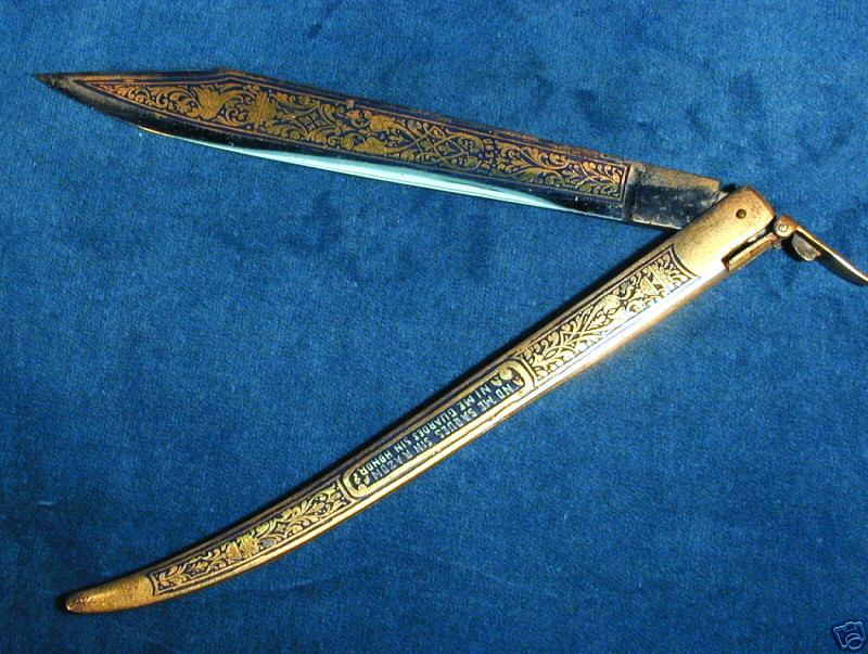

Old 2nd November 2007, 04:07 PM   #14
katana
katana's Avatar
Location: Kent
Posts: 2,658

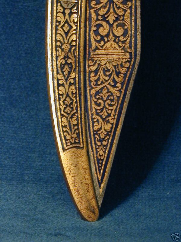

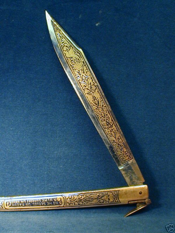

Hi Fernando,
I hope you don't mind me adding this, but this recently finished on eBay. I did bid ....but was not confident enough to bid too much....and (possibly) missed out on a bargain ?
I am not certain that this would be regarded as a Navaja as it is similar to knives described as 'Roman folders'. Whichever it is ...it is large. Blade approx. 25cms Opened approx. 53 cms
Any ideas
http://cgi.ebay.co.uk/antique-foldin...QQcmdZViewItem
Freebooter, I am no expert, but you have some really nice examples

Hi Gav
Your "pride and joy" is indeed a beautyfull navaja.
Certainly an exhibition piece, as Chris well puts it ( he is the expert ).
The inumerous phrases engraved on it, instead of the usual one or two, also bring it to the same conclusion.
The waved brass plates at the forte and the notching at the blade back are not often seen in Navajas ... what would you say, Chris?
Eventualy you can find a blue print of these efects in plug ( hunting ) bayonets from the Andalucia area ... if that helps to guess your navaja original region ?!
Fernando
I am not so good ( or don't know enough ) at evaluating things at distance.
Chris could tell you a lot more about this piece.
But i don't think you missed something valuable. You might have missed the bargain, money wise, but i don't think you missed a good collectible item.
To my ignorant eyes, the blade looks funny. The lock, besides not being working, looks itself locked . It looks as some extra device was added to it. But this must be because i never saw such pattern.
Again, Chris could help much further.
All the best
Fernando

Hi Gav,
You have a very nice collection. That large navaja is a beauty and most valuable.
I fear that Fernando, overstates my knowledge of navajas, but all the same will try to make a couple of comments:
That large antique navaja is in all probability a "Sevillana", that is from Seville, though one can never be certain without the cutler's brand or name. Forton dates similar pieces as late 19th century. Its high level of decoration and oversize blade tags it as a cutler's show piece - Then the Spanish upper classes still looked down on the navaja with utter contempt and the workers could not afford such an elaborate piece. The brass liners on each side of the blade, near the pivot, as well as the file work on the spine was a decorative feature found mostly on showpieces. All in all, a most collectable museum grade piece.
Now for the ones in the case:
The top one, with the aluminium handle has me wondering, but is in all probability post WWII, 60's perhaps. The ring pull on the spine spring suggests French. A further clue could be obtained from the lock: If it is a teat lock, then more likely than not French or Italian. If it has a rectangular "window" on the spine spring and it engages with blade ratchets or a single notch then probably Spanish. In the absence of a maker's brand positive identification of these clasp knives is very difficult as they were being made all over Europe.
The second from the top, by Alvaro Garcia, is typical of what was being turned out in Spain in the first half of the 20th century. According to a Spanish industry source, this cutler started working in 1878 and continued into the early 1930's after which his son Ricardo Garcia took over. The family is still active in Albacete. The difficulty in dating your navaja is whether it was made by Garcia senior or junior. For a start, the external spine spring definitely dates it as post 1900. At a guess, judging by the broad blade shape, I am inclined to think that it was made more towards the middle of the 20th century than earlier. As a broad generalization, as the 20th century progressed, Spanish made blades became wider. This blade shape is nowadays fancifully known as "bandolero" (that of bandits) despite that originally they were utilitarian in intent and that in earlier eras were referred to as "lengua de vaca" (cow's tongue). A strong clue could be obtained from the grind of the blade; If made by a grinding stone (rough), then it pertains to early 20th century but if by mechanized means (very smooth&polished), then it is a later product, since electric motors were not adopted until well into the 20th century. As an aside, I also have one of his navajas, but it has a much narrower blade.
The fourth from the top: Forton does list a CA (with an additional symbol over it) brand; At least one specimen is known of with the additional word "JEREZ" above the brand; This may be a clue to its origins - it is Spanish and pertains to the 19th century. Being without a lock, is what in Spain is known as a "navaja con cierro de fieles", ie a rivet lock, a real misnomer. These days we would call this type a friction folder. According to Forton this kind was the only one allowed by law in old Spain, notwithstanding the presence of locks on many others. - The very presence of such friction folders and the huge numbers of French imports without positive mechanical locks attests to the fact that the laws were in fact enforced, notwithstanding periodic laxness in this regard - This typology was probably normative in the olden days and is being used widely to this day. The famous navajas of Taramundi are a good example - Very utilitarian and functional, but rarely of high quality.
The fifth down is a 20th century piece. I have a couple that were made, I am told, by a defunct factory of Albacete in the 60s and were intended for export. They are of very poor quality, with an aluminium frame and stainless steel spring & blade. There is a fellow who still sells them on a Spanish forum, some with blades up to 10 inches. Actually, I bought three, but the moment I slightly flexed the blade of one it snapped!

With regards to the framed collection and Chris's reply,
The top one is definitely Spanish from what Chris has pointed out, it has a square locking hole with a single notch, amazing craftsmanship when examined closely. The piecing together of this piece is absolutely precision engineering.
The Alvero Garcia blade appears to be 20th century with the further input from Chris as the blade is super smooth, but it is heavily etched and I can see light file marks on the non etched edges??????
The Navaja without a locking mechanism is identical in everyway to this ebay link below. This may help further identify it. The little cresent for the thumb nail is present as is the symbol shown above the initials, though it lacks a couple of those strokes either side and the circle in the middle is clearer on mine. I have heard of this referred to as a "sun burst crown". Every engraving on the end caps are identical too.
http://cgi.ebay.com/ws/eBayISAPI.dll...MEWA:IT&ih=017
As for the junker with the fake mother of pearl grips, it also has a gorgeous file finished locking spring much like the large exhibition piece has on the blade, it also has a pipe tamper to the back of it, both the back spring and blade are reasonable carbon steel and the blade is very sharp, the fittings appear to be nickel wrapped around another type of steel on the end caps.
I am still not 100% convinced about the Toledo blade being very modern, there is nothing stamped about this navaja(to my eyes), it is all, what I believe, engraved, etched or chiselled, the lines are so crisp and delicate in many places. I do remember Laura from knifecollection some years ago put this around circa 1900-1910 as she too was watching the auction at the time and wanted to add it to her stock.
OK. we here a obviously Spanish style non functional souvenir grade navaja manufactured some time ago, but we don't know when. Apart from the ubiquitous "TOLEDO" there is nothing else to identify it.
In such cases we can only do the following:
a) Carefully examine the piece and try and detect the technology used in its manufacture, such as blanking of the blade, the mode of construction as for example cast or the earlier riveted sheet handle frame, indications of machining and die forgings, mechanical polishing, electroplating, type of engraving used, materials employed and any other evidence of advanced manufacturing. All this is then to be compared with periods of known cutlery output from Spain.
b) Try to estimate the probable age of the piece from condition and type of paint used to fill up the engraving. A powerful clue is whether the gold effect was obtained with powdered pigment paint or a thin coat of translucent "gold" laquer applied over a silvery electro plated surface. The way to detect this is to examine the area in question under a low power microscope (20x-50x) and with a scalpel gently scratch away at the surface. If this technology was used, then after removal of the coat of lacquer a shiny silver surface will be revealed
Now, we do know that
a) Up to around 60s, cutlery in Spain was a cottage industry, using only the most rudimentary tools and basic materials. After that, it modernized;
b) There was flood of cheap souvenir daggers, and swords in the 60s and 70s with cast metal handles and plated blades using the above "faux" gold plating, all etch engraved and painted with enamels. As far as I can ascertain, the sequence of paint deposition was as follows:
1st coat: Silvery electro plating
2nd coat: Translucent "gold"lacquer
3d coat : Colored enamel, the "gold" lacquer serving as an undercoat/primer.
I have not seen any earlier Spanish decorative cutlery that utilized this "faux" gold finish.
c) We also do know that cast metal navaja handles became widespread sometime after around 1960. This how most of the modern imitation junk navajas are made. The only way to get a "real" navaja, built by traditional means (Spanish "artesanal") these days is to have one custom made. If still producing, then the navajas of Exposito are exempted from these remarks.
Hope this helps

A bit late, but just in case you have not seen it, here is a link from the old forum wich display an interesting 55" navaja from Santa Cruz or Albacete with inscriptions and red enamel paint filling the decoration chiselled or engraved on the blade. http://www.vikingsword.com/ubb/Forum1/HTML/001357.html
Thank you for reminding us. I do remember seeing that very old navaja. I am inclined to think that it was probably from Santa Cruz de Mudela rather than Albacete.
Of all the old navajas that I have seen, red was the only colour that I noted as having been used to fill in the engravings. It was only in the 50s and 60s the Spanish cutlers decided to put out polychromatic and very garish versions, using oil based enamels, all aimed at tourists. The vast majority featured the ever recurring "Recuerdo de..." (Souvenir of....) and all bore the Toledo brand, even if the cutler's workshop was in Albacete, the place that most came from. A few were quite decent but most were junk - In those decades the industry nearly disappeared.
