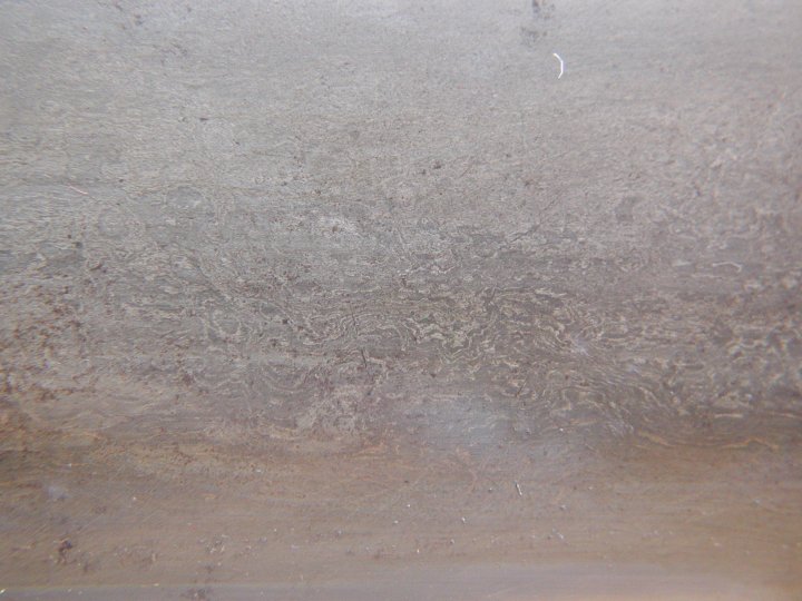

Recieved this heavy Kris that's collected in Negros.
Any ideas about what the star on the handle could symbolize?
And what is the, almost wootz resembling, pattern on the blade?

Hello Michael,
I realize that it's awfully difficult to photograph steel, especially wootz, but I can't see anything vaguely resembling wootz I'm afraid...
Those specks don't resemble any crucible steel pattern I've seen. Any intentions to polish this blade? This may help to reveal their true nature.

Thanks for your comments.
Rick, I didn't think about Katipunan on a Visayan sword but maybe the star symbolise Visayas (like on the flag)?
Most of what I read about the Katipunan part of the revolution seems to have been centered to Luzon?
But there was the uprising of Papa Isio and his Tribo Pulahan on Negros. As far as I remember, of the statue of him on the crossroad in Barrio Isio, he didn't carry a Kris however?
Unfortunately I didn't have a digital camera at that time and I haven't been able to find a picture of the statue on the Internet to doublecheck.
But from what I have read he also had some contact with Rizal & Co.
Sorry for the lousy close up Kai. The blade actually is quite well preserved and has a nice grey patina that I don't feel like polish away. The specks you see on the picture are the dominant ones. All over there are several smaller ones that I unfortunately can't seem to catch on a picture.

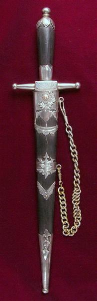

I had posted this dagger some time ago and there were comments about it being KKK origins, but I can't find that post.

I see the sun and the three stars. But I haven't seen the sun with a face before, as well as those kind of stars, on Katipunan emblems?
I am sure that some of the other forumites know much more about it.

On the Katipunan question, the sun with a face is a definite Katipunan emblem and was in fact incorporated later into the Malolos flag when the government as set up around latge 1899. It is a form of Malay sun and the rays in this case represent the 8 original provinces that revolted this last time against the Spanish. Later some of the Visayas revolted, like Bohol island, Negros, etc.
The star in the middle of the hilt in this case -
Bill - yours is the best example I have ever seen (grumble,grumble,envy,envy ). I would add that it may have belonged to a general.
Oh yes, here is that post:
http://www.vikingsword.com/ubb/Forum1/HTML/002102.html

Originally Posted by Bill Marsh
I really like the Negrito kris.
Bill,
Negrito does not equal Negros.
There are Negritos all over the Philippines and the correct term for them is Aeta.
To call anyone who is from Negros, a Negrito, is not correct.
That is like calling anyone who was born in America, an Indian (which is not correct either).
To call an inanimate object from Negros, Negrito, is not a good thing either.
Remember, Negrito is the term used for the aboriginal inhabitants of the Philippines, not the people of Negros, or as you stated in another thread, the ancestral peoples of the Moros.
The Spanish originally called that island, Negros, because the people were dark.
The inhabitants of Negros now, are either Illongo or Cebuano, with some others, such as Waray-Waray.
I'm surpised the other Filipinos on the board havent corrected you yet.
VVV,
Very nice dagger!!!
This is a Visayan Dagger

VVV
Here is a kris with a similar dendritic pattern in the steel.
Lew

And another different pattern from normal.

This pic was taken from an old Philippine bolo and even though it looks like wootz the experts say no.
Lew

Thanks for sharing.
Do you have any ideas why those patterns show up on the blades?
Michael
