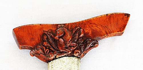

Here are a few more examples. Please excuse the image quality, as i shot these very quickly on my porch this afternoon :

Here are three patrems from Madura in three basic sheath forms:

Yes, I have also often wondered at the variety in Madura wrongkos. There`s a lot of variety in the handles too.
Regarding the photos that have already been posted:-
VVV--- I don't think this is a Solo style wrongko, it appears to me to be East Jawa; Madura is of course a part of East Jawa. The handle looks like an old North Coast one, not Madura.
Rick---why do you think this is Madura dress? The wrongko is Jogja, although the handle is Madura.
Here are few Madura wrongkos from my own collection. I`ve left handles and blades, and mendak out of it for the time being, to allow us to focus on just one element of dress at a time.

Are there names to identify the various types of sheath form?
Afaik, from the pictures... Ladrang Madura, Gayaman Madura and Sandang Walikat Madura in general.
David, your 1st piece, the sheath form is interesting and a beauty (the bird hilt too.) Your horn Sandang Walikat sheath is exquisite.
Alan, what are these type called? This one, the wings reminds me of the piece from Nagasasra's "Unusual Keris Dress from where?" thread.

Old 23rd September 2006, 04:45 PM   #26
Posts: 7,297
That first modern example is quite nice. The Madurese knack for wood carving doesn't seem to have diminished much over the years.
That second one is a puzzler. I can't say i have seen this style of sheath from either Jawa or Madura before. To my eye it is more like a cross between Bugis and Madurese forms. The pendok looks more Javanese to me though. Hopefully other will know better than i.

Yes, the Madurese has not lost their flair for wood carving and even though this is a decorative wrongko most likely made for the tourist trade, they tend to apply that unmistakable level of workmanship.
As for the second one, it certainly look like Shahrial's wrongko is from the very same culture, one thing noticeable is both of them have a pendok in the Yogya/Central Javanese older style with the top edge arched.
