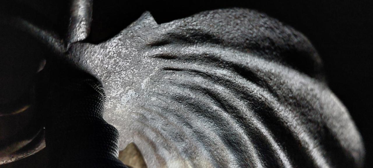

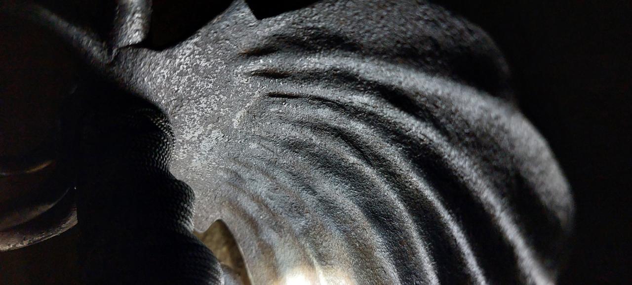

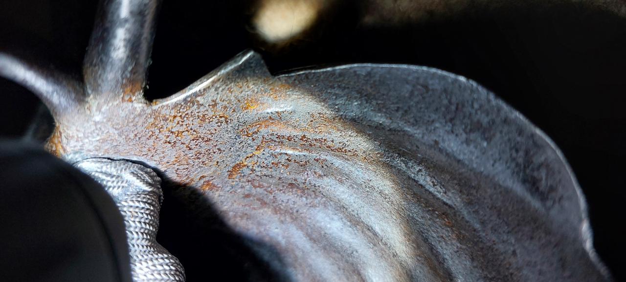

Sure thing, Andreas - pictures of the inside of the shell guard

Thank you. On the 3rd picture next to the grip, is this delamination? Can you see delamination anywhere, also on the blade?

I'm not sure it's a delamination. It's a tough spot to get good pictures, but I tried shining the light at different angles to give a sense of the surface texture. Do these help?

To be honest, also after having seen the latent images, I tend to think that Copycat is öikely right. But there are others which much more knowledge then me here. Maybe they also state their opinion
