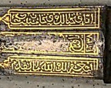

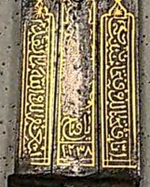

I am sending enlarged details of the text – cropped sections from the original photograph – and would like to ask colleagues-forumites again for help with the translation and determining the corresponding Gregorian date...

The date as far as I can see is 1238 AH corresponding to 1822-23 AD.
Norman.
Old 14th February 2026, 04:07 AM   #13
GePi
Join Date: Mar 2016
Location: Germany
Posts: 101
I do not understand Arabic, but can read the script somewhat and recognize the inscriptions from other examples.
The long ones seem to be the beginning verses of the Surah Al-Fath.
إِنَّا فَتَحْنَا لَكَ فَتْحًۭا مُّبِينًۭا - Indeed, We have granted you a clear triumph (last word is off, somehow, no idea what is up with that)
يَغْفِرَ لَكَ ٱللَّهُ مَا تَقَدَّمَ - so that Allah may forgive you for your past and future shortcomings (a bit missing at the end)
The short inscription over the date
يا فتاح - ya Fattah - 'the opener', one of the 99 epithets of God in Islam.
The date is as Norman says.
