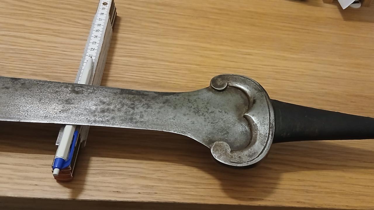

Default Help to identify a sword
Hello all members,
I'm new here but I read a lot of the forum threads and like edged
weapons.
I have this strange sword to identify please.
For most of my friends it is just a fantasy sword but I think it is good.

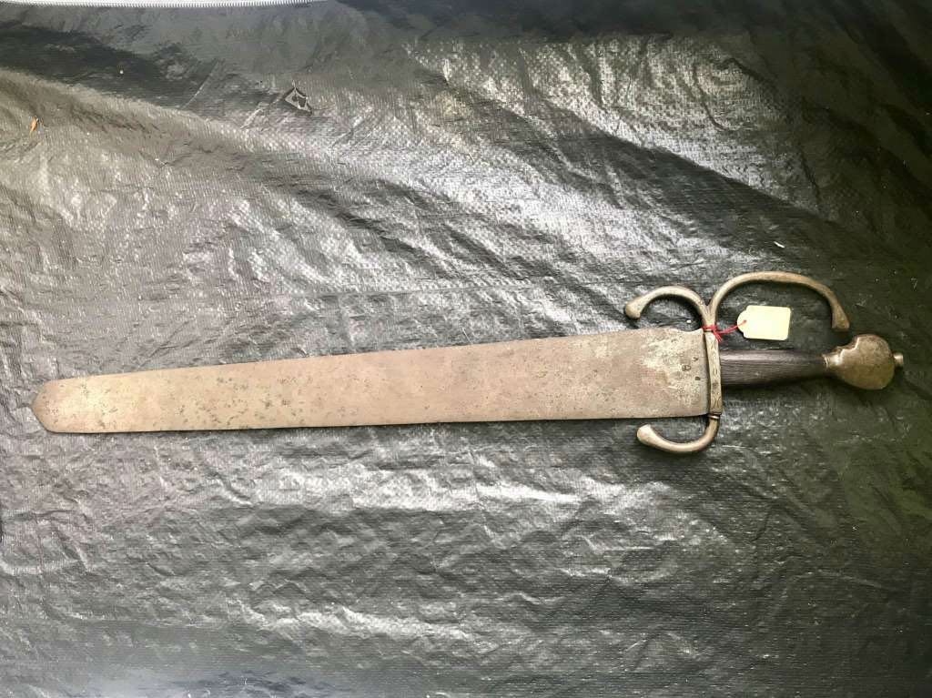

Hello thank you,
I tried , now I hope it will be ok.
Sword is a mix of medieval pommel and hilt with a celtic ? ?
guard and blade
Almonzo is offline   Reply With Quote

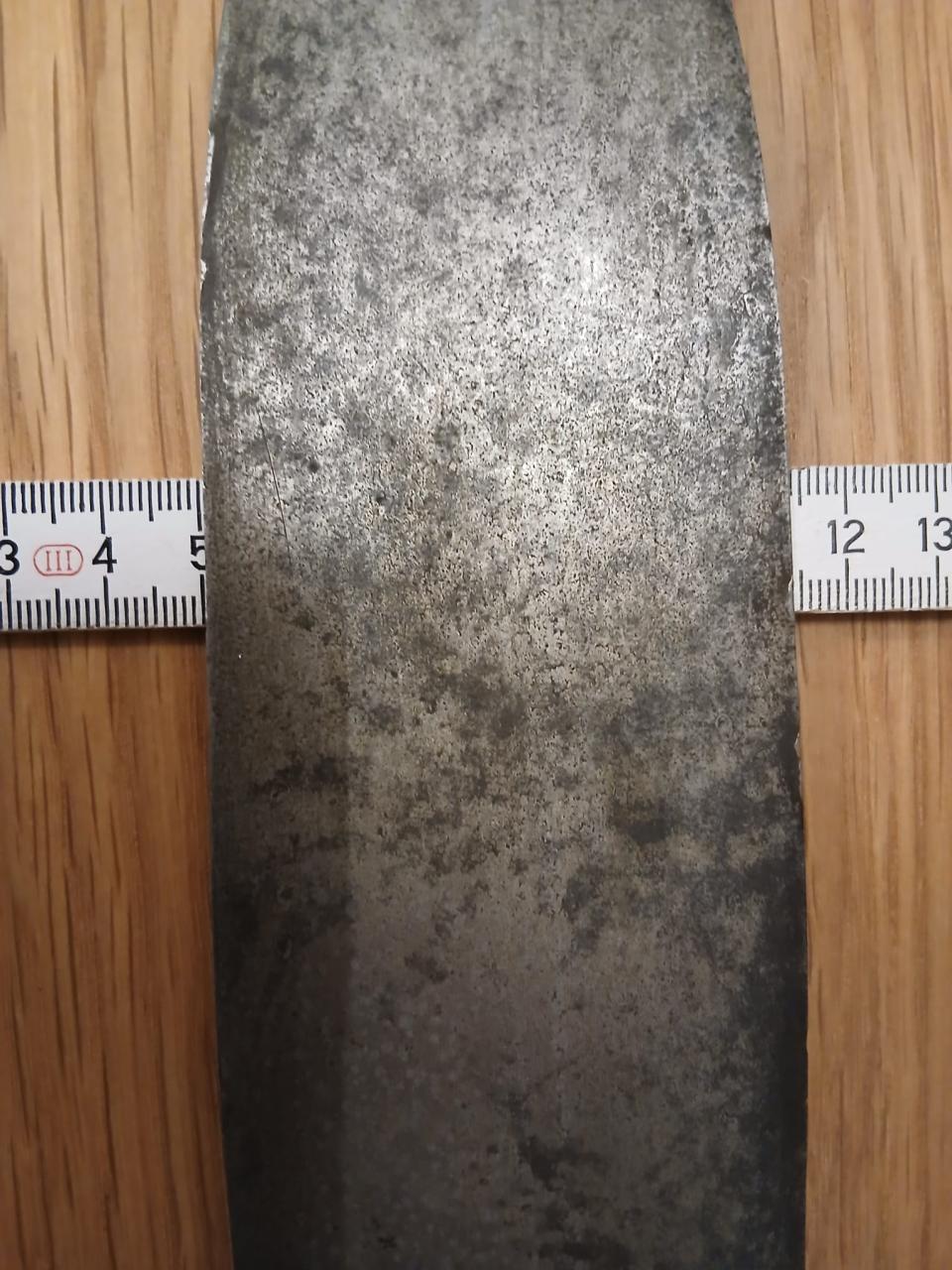

Posts: 12

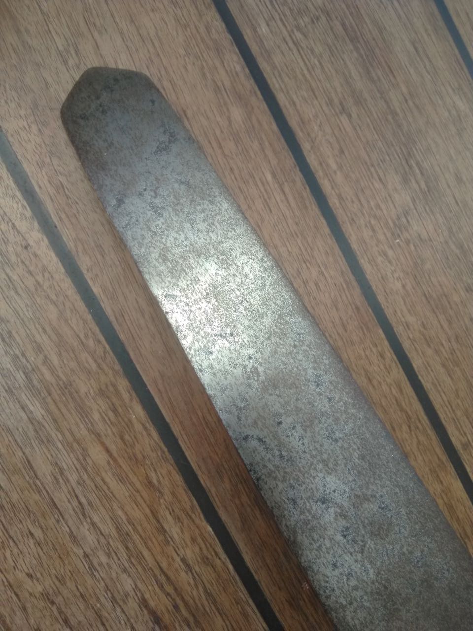

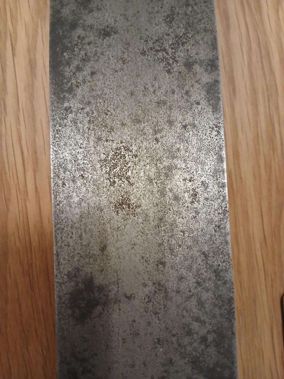

Hello, OK thank you !
I put other pictures with more light,
The blade is really thin , sharp at edges and 3-4mm at the middle
With no visible central ridge
Thank you

I think that you are correct in your attribution of the styles of the various components. I do not recognize the whole, perhaps something along the lines of an militia infantry sword of the early 19th century, a hunting hanger or a particularly nicely made theatrical prop with some age. Hopefully someone will have more definitive ideas.

My guess would be a 19th century historicism piece, though I can't say I've ever seen another like it.

Possibly from the Hollywood sand &sandal era. I saw this one years ago, listed as a prop for the silent Ben Hur. B&W era stuff.
For some reason, my first impression was the type of stuff Kirby Wise may have made during the SCA years but this has real age showing.

I'll be less harsh than my comrades.
The leather-covered guard is old, and the wide, flat, and sharp blade as you said , which shows clearly some age and is made of quality steel, reminds me of my 16th-century Italian sword/storta.
See my previous post: Strange blade on Italian(?) old sword
Is it a short sword or long sword?
The hilt, even though it looks like a Viking/Norman or Celtic type, reminds me of certain long cinquedeas from the same period, 1500-1600. Clearly, the leaf-shaped blade is anachronistic. Perhaps it was a special order with a beautiful medieval pommel. What is the sword's length and weight, by the way?
Kind regards

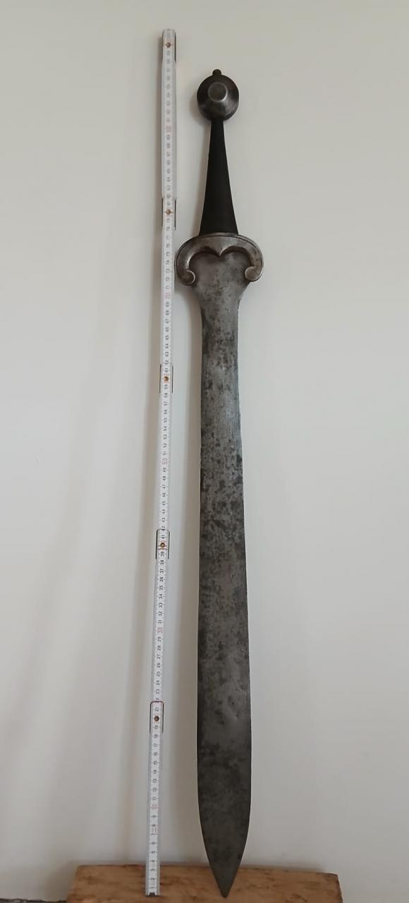

What are the measurements?
To me the hilt looks to be 1.5 hand sized but the sword as a whole looks like a one handed sword, so if that is the case the proportions are a bit off as compared to historical examples (but as it happens actually do match lots of movie swords). However it is hard to judge the real measurements from the picture.

Posts: 12

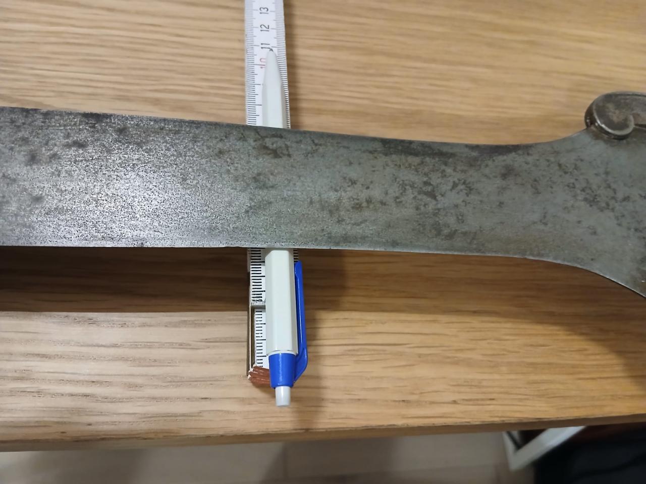

Thank you all members for the messages,
I will look for old European Italian swords .
It is a large sword, I would have mentioned that.
The total length is 97,5cm/ 38,38 inches
Weight is 1,4 kg / 3.09 pounds
Balance of the blade is 16cm away from the guard.
Largest part of the blade is 6,5cm large/ 2,56 inches and really thin ,
a little larger in the middle as I already said
It don't look like a deco piece ,
the blade is really really sharp all around the sword ; except the 5-6 first centimeters near the guard.
For a movie, I don't think it will be the best .

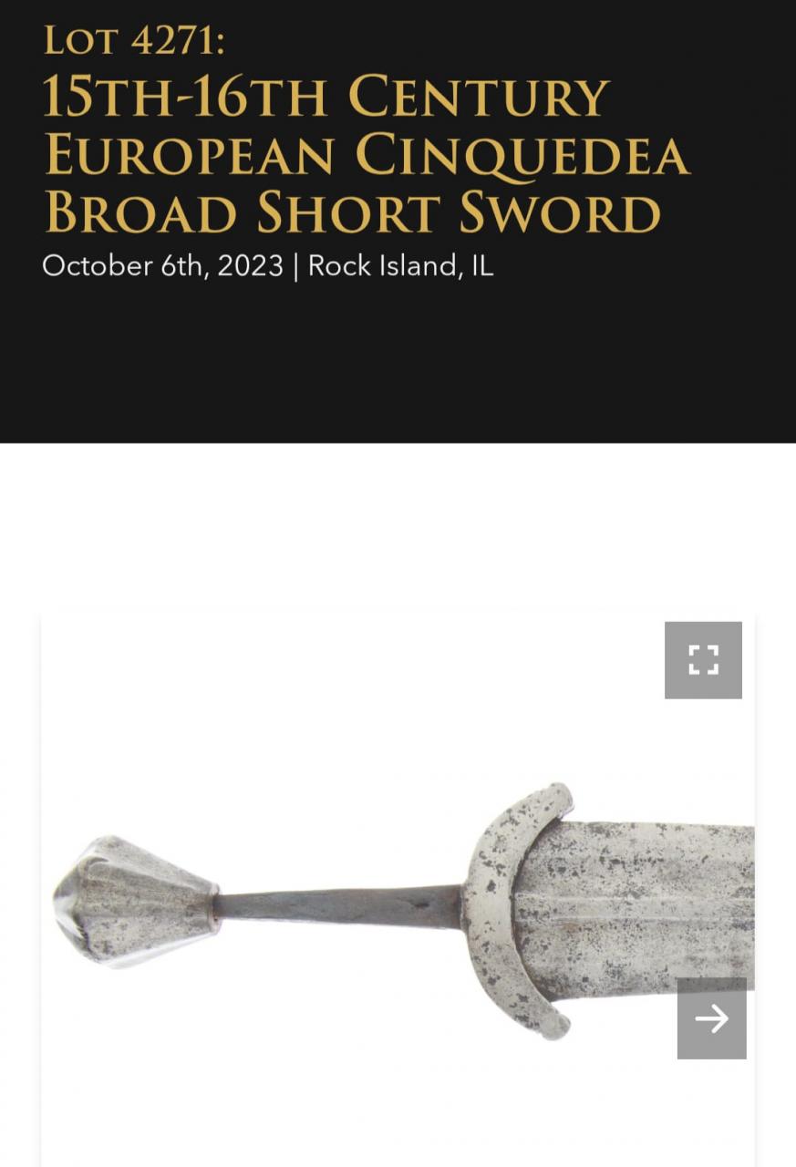

I forgot to write that when I received the sword
It was very rusty and I cleaned it with a lot of baking soda.
I wanted it shiny but maybe it is too much and help to make it seems too "clean'/fake

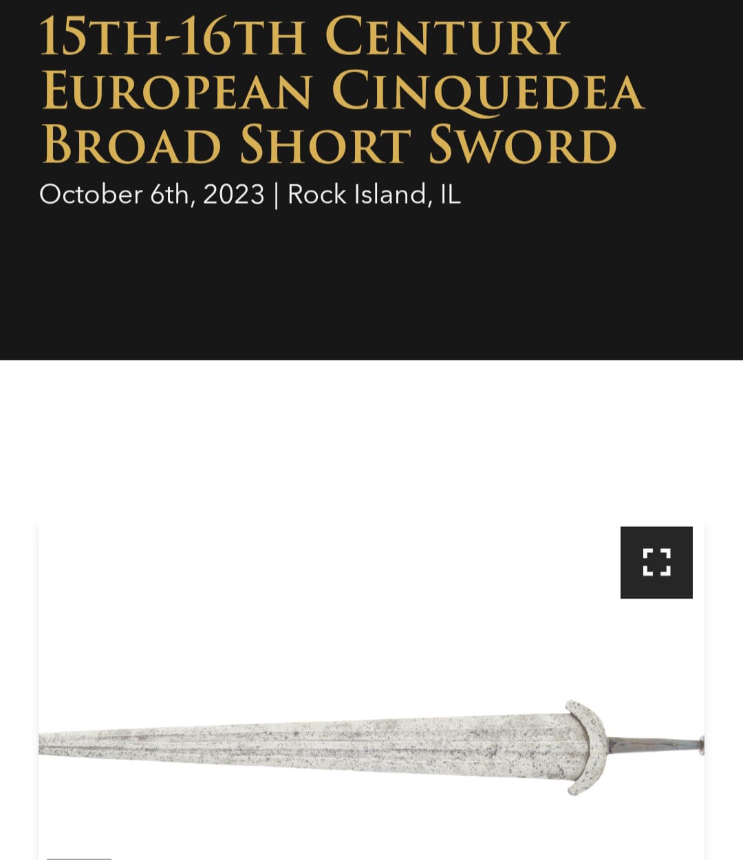

I found , thank you ,
this 16th large cinquedea sword who don't looks older, guard is +/- look like
The pommel is as unusual as my wheel medieval pommel.
Maybe this one is recent too ?

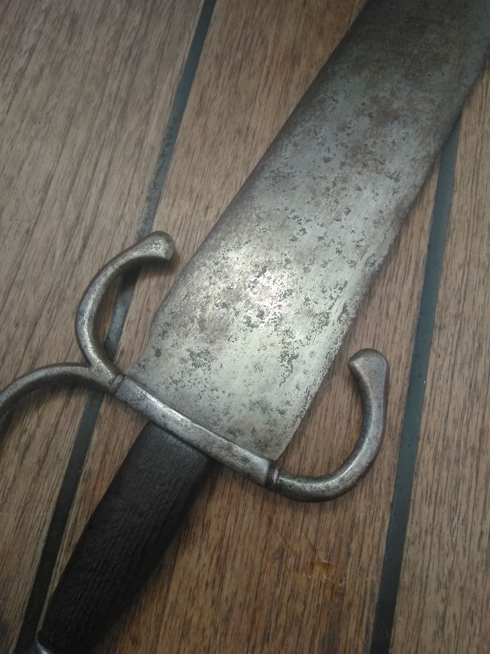

What stands out for me is the grip. It does not look as though you could get a good hold on such a long and heavy sword with that slim tapered grip.
Unless of course parts of the grip are missing and the tang has been covered over.

On the pommel I thought there was a cross but it is not,
maybe just a big scratch because it was under rust and still is visible.
The grip can be ok because when we grab the hilt and twirl or spin the sword,
The hand is "blocked"by the pommel who stabilise and make the movement easier
The second hand.is welcomed forward but I can not make a picture.

Thanks, Almonzo, for the picture of holding the sword. I see how the grip works now and it shows how it could be used single or two handed.
Do you think that the way the blade swells out at the hilt is a protective measure to protect the hand from an attacking strike running down the blade, by sweeping it aside?
Great looking sword and looks as though it was made to fight.

I do like the sword, but IMO the proportions are off for an original. The grip is much too long for the overall size of it and it doesn't have the length for a longsword (although it does have about that weight). Proportion wise it actually reminds me a bit of Conan the Barbarian's sword (which is not a slight, as that remains my favorite movie sword).
And the fact that none of us know of any originals that closely resemble it is also a clue. That should raise a red flag IMO.
