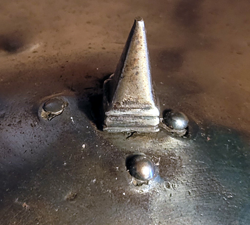

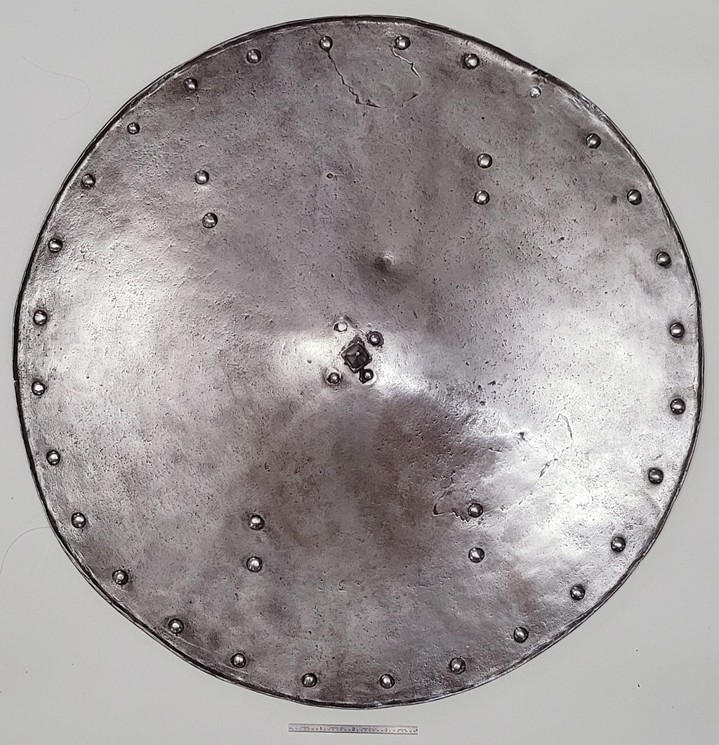

I'll add my own solitary shield of this sort - strictly munitions grade - really heavy and with what the seller described as a bullet-made test dent. 56 cm. diameter; 3.5 cm spike.

I strongly suspect that the shoulder strap shown in Triarii's upper image would have been absolutely obligatory for carrying my example. Unfortunately, other than the rivets, nothing of the suspension has survived.

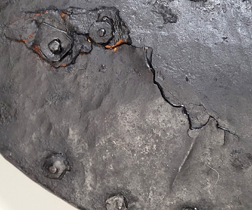

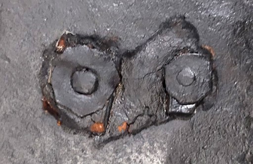

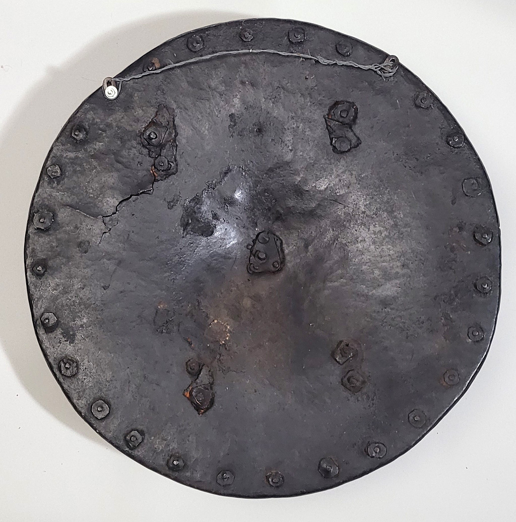

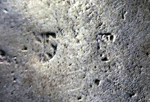

My curiosity finally overcame fears of the hassle of taking my shield down from where it has hung undisturbed for at least a decade. It weighs 15.2 pounds (6.9 kg). I found marks, pictured below, that I interpret as being for Nuremberg. A layer of iron has fully delaminated in one of the images of the back. As I said on my first post: munitions grade.
https://european-armour.com/Marks.html

That looks great Lee!!! The Nuremberg marks look like those of 1570s firearms.

My heavy ("shot proof") example is not lined, at least in its present state. While the pictures of the reverse may suggest leather, this is hard partially delaminated iron, confirmed to be such with a magnet.
Thank you for your insights into how it would have been carried.
