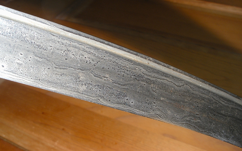

Posts: 6,376
Red face Please Pardon
May I inquire about my Yatagan; please excuse if I am interrupting the thread.
The pattern in the steel has me quite confused. Serdar, have you ever seen a Yat blade with this type of forging?
Parts of the surface seem almost crystallized.
I have never seen a blade like this; then again, I don't get out much.
Any input by anyone would be much appreciated.
Hmm, picture isnt much, but to me it looks like i dont know name, but bladesmith took diferent parts of steel quality and result was “damasc” looking blade, i seen it on saber blades but not on yatagan.
I dont say it is that, but reminds me on that.
I realy dont know, can you take better picture under sunlight maybe?
serdar is offline   Reply With Quote

The double fullered 'trade' blade has a bit of shallow corrosion, but no active rust. The scabbard has a tin ribbed throat area with a few bumps and wrinkles, once decorated, but is intact, the upper bras/silvered panels have ghosts of past decor. The leather is a bit shrunken where it meets the metal covers, but is intact With just a bit of the ladder seam missing.
The lower brass section has decorated grooves, the central area appears to have a lot of shallow dents and wrinkles from normal wear and tear. The lower panels are silvered, has a few cracks and one sort of circular area about 1.5 cm. in diameter missing the lower brass and silver sections have a wide - about 2 cm. grooved reinforcing band running along the spine and the edge areas of the scabbard, joining in a cross-hatched 'acorn' finial that's a bit worn and corroded black, but reminds me of a pine cone. it has a slightly upturned 'nose', so I don't think there was any further protrusion that snapped off.
The blade markings: I tried to get a macro shot, but it looks like the one already posted. can't see any more detail. I can, however, see a ghost of a shield shape with a crown in its centre, which is essentially worn away and may be my imagination. Can't get a photo of it.
Edge is sharp, a few nicks, and a slightly rounded tip.
All in all I am a hap,hap, happy guy.
