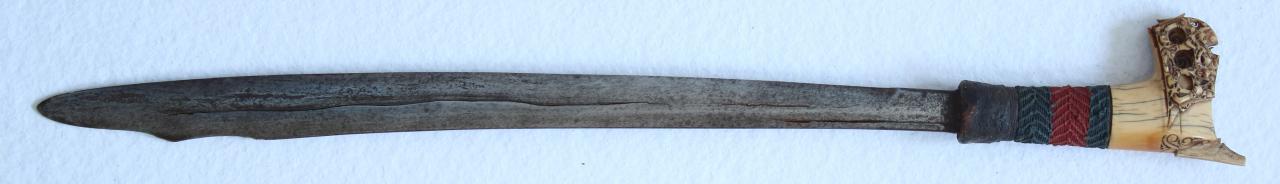

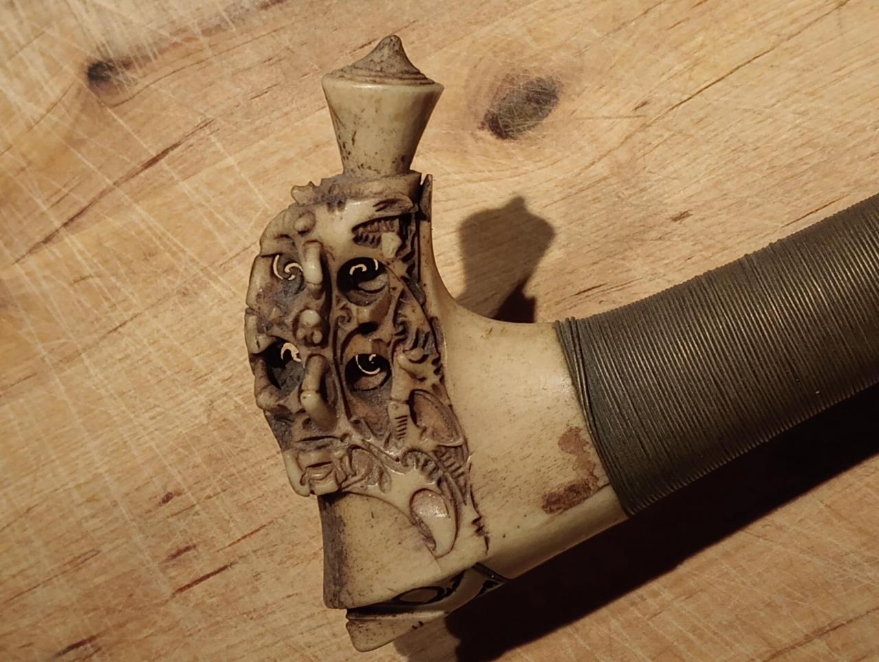

I recently received some objects from a friend who lived in Indonesia with her parents in the 70-80s. Her father traveled all over Indonesia for his work and regularly brought something home. Like these mandau's, quite small 65 and 63 cm. Both blades have a convex and a concave side. One blade is laminated steel with several fractures, faults, one over almost the entire length of the blade. Cutting on the handle reasonably good, especially the ivory piece. In both handles traces of where a coin once sat. Facinating objects but beyond my familiar knowledge. Made for those who travel, the real stuff, just let me know what you guys think.
Marc
Old 19th May 2025, 03:02 PM   #2
Marc M.
Join Date: Aug 2019
Location: Belgium
Posts: 296
More pictures.

Those swirls in that ivory hilt are lovely.

Congratulations Marc!
Very cool swords!
What is the diameter of the coin slot?
Very cool swords!
With respect,
Yuri.
Hi Yuri
About 15mm.
Marc
I don't think that the hilt is carved from ivory.
Hi Detlef
It is ivory, the Schreger lines are clearly visible.
regards
Marc
Old 21st May 2025, 05:00 PM   #11
Posts: 7,289
Looks like elephant ivory to my eye. See the cross-hatched lines? I do think this is a bit unusual, which makes this mandau a bot special. Certainly not made for those that travel.
Old 21st May 2025, 06:14 PM   #12
Posts: 7,399
I agree with David on the cross hatching - elephant ivory
Is there any information about the production of ivory mandau handles in Borneo?
Pertinax is online now   Reply With Quote
Never seen any. But Dayak weapons are only a minor interest for me so someone more invested in them might have better information. I only have one in my collection and it's hilt is deer horn. That is probably what the majority of hilts are made from and you will, of course, find wooden ones. I have read that on rare occasion human bone has been used, but i have never seen an example yet. I have never heard of ivory being used, but this very clearly looks like ivory to my eyes and it is certainly a traditional carving. So it seems to be a rarity to me.
Old 21st May 2025, 10:45 PM   #15
Posts: 7,217
I agree that the ivory shown here is most likely elephant ivory.
However, ivory from some other animals does also display schreger lines. An expert in this field of ivory identification can in most cases differentiate the source of an ivory, however, in the case of mammoth ivory it can be somewhere between difficult & impossible to be absolutely certain with any identification.
Fossil ivory has been used in Indonesian artifacts in the past, & is still being used in Indonesian carvings today. In Bali a tour of shops, galleries & workshops that sell ivory carvings will almost always identify the ivory carvings being offered as "mammoth ivory".
Old 21st May 2025, 11:05 PM   #16
Pertinax
Pertinax's Avatar
Join Date: Dec 2023
Location: City by the Black Sea
Posts: 350
A.W. Nieuwenhuis in his book "Quer Durch Borneo" describes the Dayaks making mandau handles from deer horn.
The Bornean elephant, or Kalimantan elephant, or Borneo dwarf elephant (Elephas maximus borneensis) is a subspecies of the Asian elephant that lives in the northeast of the island of Kalimantan.

I had no idea that ivory is rarely used to make a handle for a mandau. Although the material is available locally, culturally it is apparently not the custom to use it.
Have shown the mandau to a friend who is more familiar with it. He confirmed my suspicion that the scabbards were fairly recent, but the swords seemed older. The quality of the carving is good and the small utility knife has a good patina. He also found that the talismanic figure is of good quality and age.
As in many cultures, the things most exposed to wear and tear are replaced regularly, perhaps with these mandau's the case.
The blade of the mandau with the ivory handle is laminated, not visible in the photo but in the right light and at a certain angle it is slightly visible. I assume the damage to the blade is from use. The flaws present in the steel created during the fabrication process may have been visible but still found good enough to make it a weapon.
Marc

The handle is indeed from ivory, the first mandau I've seen with such a handle. The handle also shows a very nice carving and also a face. Laminated mandau blades are also very rare and seldom seen. In short, you have a great mandau there, I hope Maurice sees this thread and will comment, he is, at the moment, the person who knows as best about mandaus. Great score, congrats!

First time that I see a mandau hilt of ivory ( in over 30 years)
Old 3rd June 2025, 11:47 PM   #22
asomotif
asomotif's Avatar
Join Date: Nov 2006
Posts: 2,238
It would be worth to restore the hilt in my opinion.
The ivory most probably allowed a more detailed carving compared to deer antler.
Thank you for your response. Is there any particular reason that ivory was rarely used although the material is present?
I suppose the piece missing from my mandau is similar to your mandau. A restoration might be considered, I have a piece from which it could be made.
Marc

I do not know if there is a specific reason why ivory is seldom/almost not used in Borneo.
I have only seen 2 objects of elephant ivory before. Both were earrings, and one of the owners was for some reason claiming that it was an ivorine fake. This is the 3rd object of ivory that I have seen. And based on the carving I am sure this is the real deal 🙂
The material is indeed present as in local elephants. And also through trade it must have been possible to get ivory from either Asia or Africa.
Ido notice that elephants do not play a role in the art , myths and religions on Borneo.
Old 5th June 2025, 08:49 PM   #25
asomotif
asomotif's Avatar
Join Date: Nov 2006
Posts: 2,238
Ps. I just noticed that on your hilt, the protruding point at the back is an inserted piece of a different material. Probably antler. I assume the ivory was not big enough to carve this protruding point from one piece.
Ps. Here a picture of a hilt of similar quality to give you an idea about how the missing 'nose' might have looked.
Indeed, I forgot to mention that the piece sticking out is of a different material, probably antler or bone. Do you have an opinion on the blade, apparently a laminated blade is something not common? The flaws in the steel make it of little use anymore. Reason to sell perhaps.
Marc
Marc
Hi Marc,
Do you have picture of the other side of the blade ?
Roughly / locally forged blades are sometimes referred to as "mantikei".
I have 1 blade in my collection with a similar surface as this one.
They are rare, but I am not sure if they have a special status.
Old 6th June 2025, 11:45 AM   #29
Marc M.
Join Date: Aug 2019
Location: Belgium
Posts: 296
Hi Marc,
I read on the forum in an old post that when the men left the village to settle a conflict, the big mandau were taken with them and the small ones stayed in the village to defend it. I also thought I read that the mandau's were kept in the men's house, longhouse. No idea if this is correct, can't find the post again.
Marc
