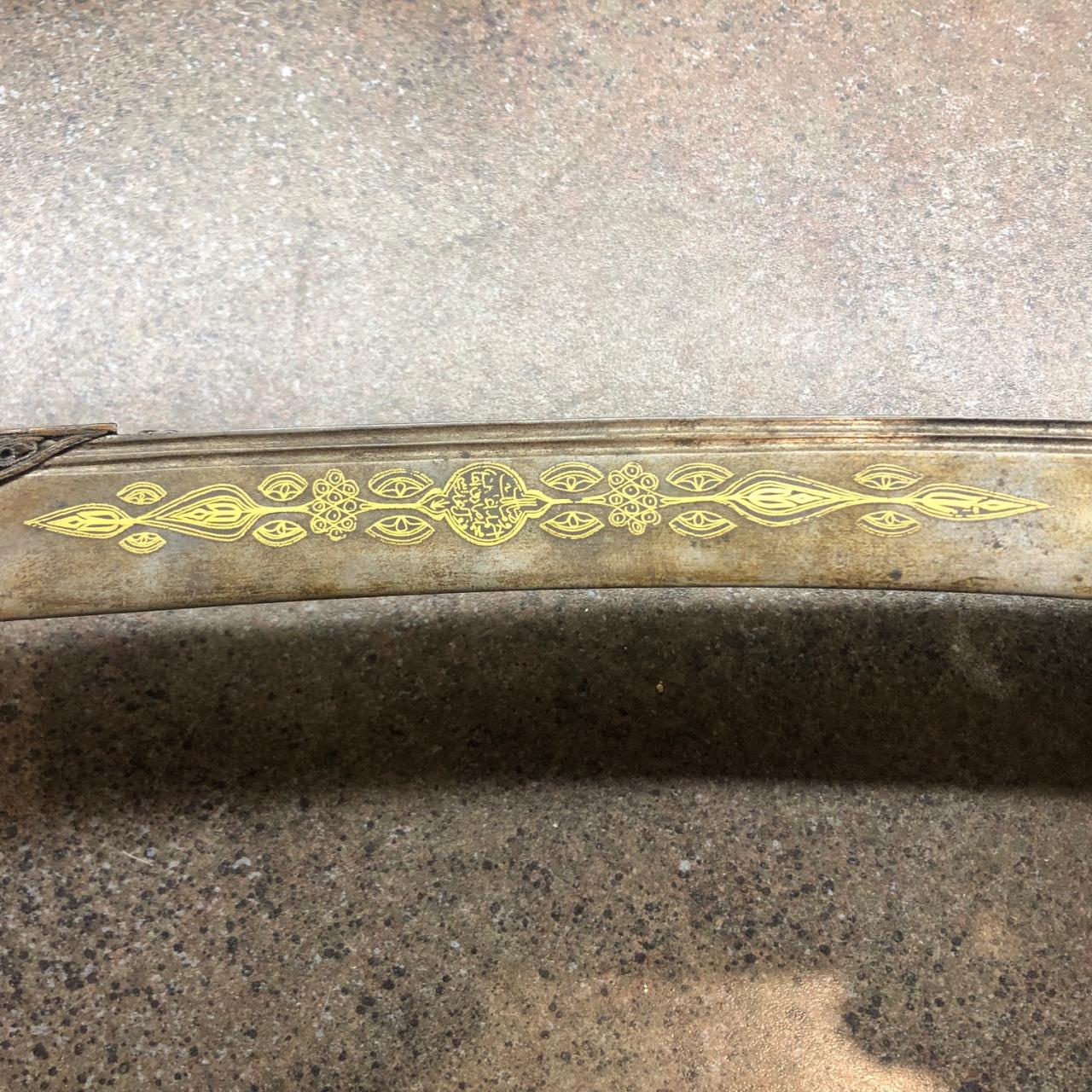

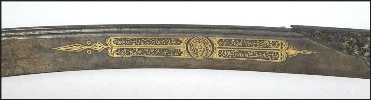

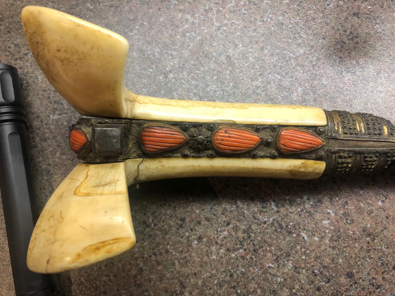

Recently found this 29.5" Ottoman Yataghan.

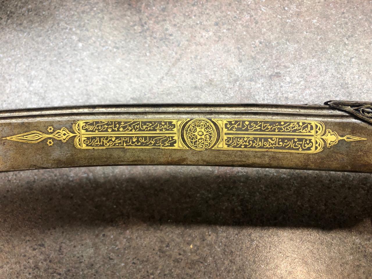

I am wondering if the Gold inlaid Inscriptions can be translated? Likely Quran verses, but perhaps something more like a name or date in the roundels.
Google thinks it is Persian / Farsi but it doesn't translate properly.

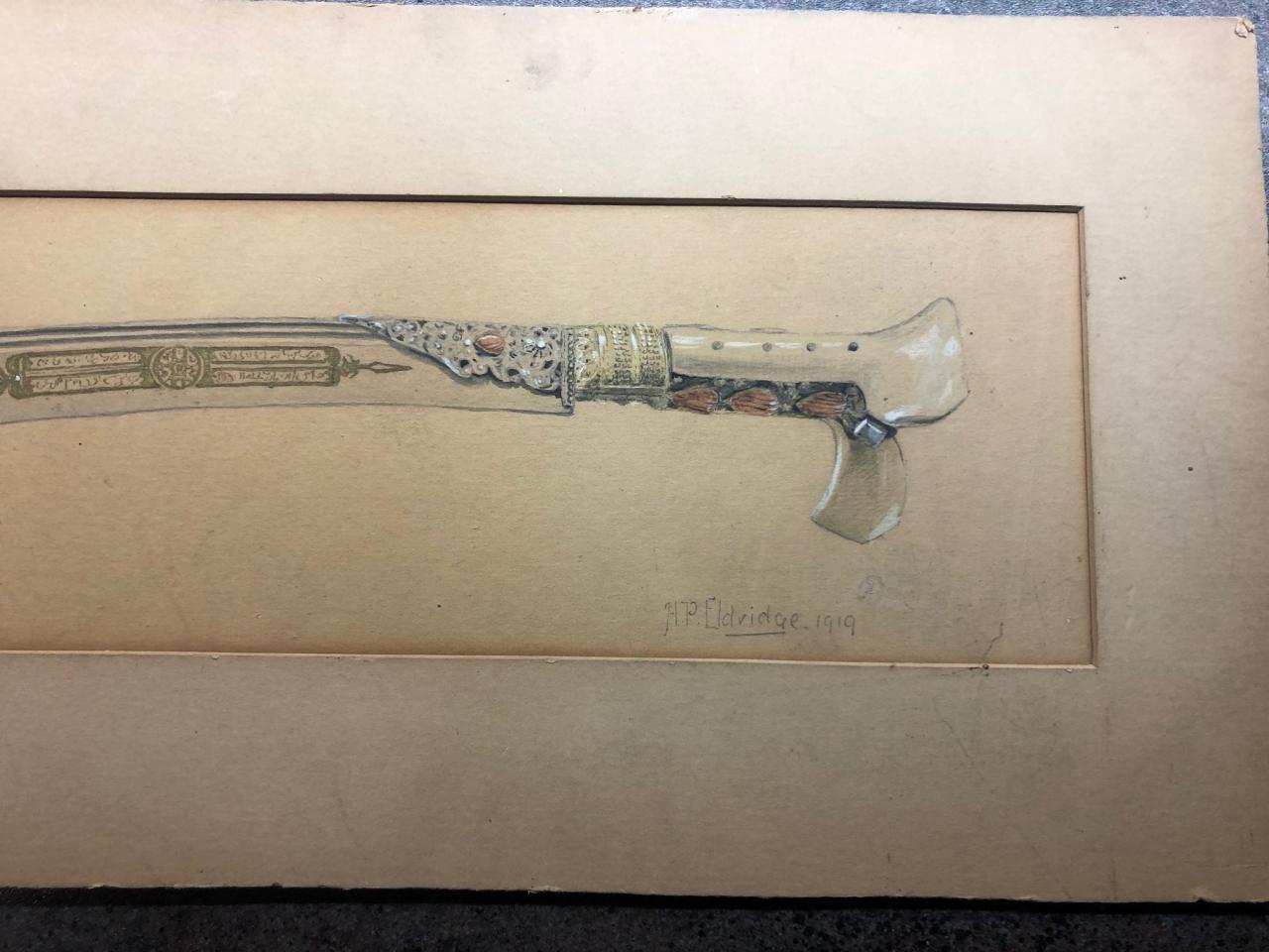

The sword is in pretty good condition and came with a signed 1919 gouache /watercolour painting of the exact Yataghan on laid paper.
Quite a handsome weapon.
Any Help would be greatly appreciated.

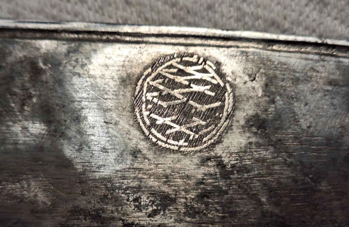

This is from the Balkans, perhaps Bosnia. Might have belonged to a jannisary. The ivory is walrus ivory with red corals. You even have the seal of Soloman on the blade.

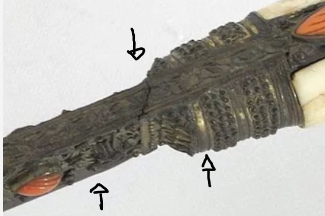

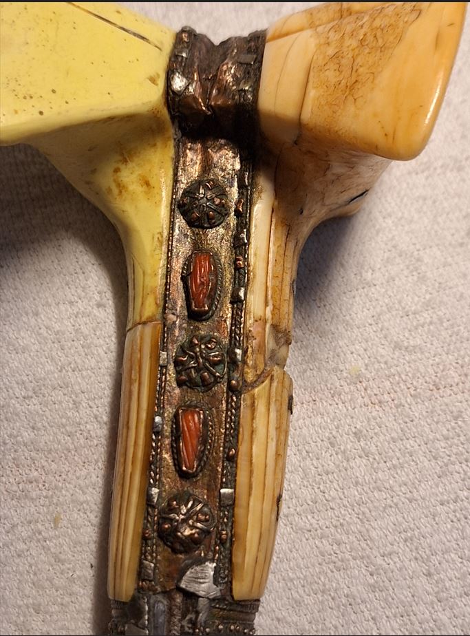

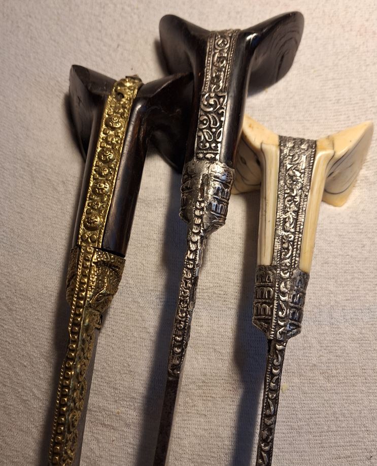

Indeed as Jose wrote it is from Bosnia, the Balkans ( as the handle / grip or hilt is very similar to the Bosnian ones I have) and my guess about its age: about 200 years old and owned by an important man.
Please allow me to be so bold and give a piece of advise:
clean both the metal and walrus to keep them from deteriorating...
After cleaning also add some oil to :
1. the walruss to "feed" or preserve it longer and stop the breaking line or crackgetting deeper and widening .
2. the copper metal pieces to also avoid "drying out" or oxidation, causing some it to break ( further than already)
as yours is a too beautiful one to let it deteriorate over time....and the copper deserves to shine ☺
It will improve your outstanding yataghan greatly as it did mine.

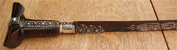

I shall show some pictures, but you have to be a little patient as I just had a eye operation. Enclosed one picture of mine halfway cleaned last month .
But you can already see the positieve outcome on both the metal and the grip/handle even if it is not completed.
The inscription is in a most beautifull condition and outstanding in both its size/ the amount of scripture as in its caligraphy and indicates having belonged to a quite important owner,
FYI: normally it would be just the name of the maker / smith and just the owner with sometimes his title , approx. 2 lines . But by the amount seen on yours, it is a special made one. Congrats !

As for the metals, it would be a good idea to carefully clean off the dirt on them or else they will not just oxidate but corrode the underlying copper structure.
much obliged, I an only fullhearted support this. Found some pics of mine 3/4 cleaned in the way Jose described .
FYI: mine were in exact the same condition as the above uncleaned one ( both bone handle as metal part).
You can compare the above uncleaned one ( first pic below) with my 3/4 cleanded ones and see for yourself...both bone as metal looks better

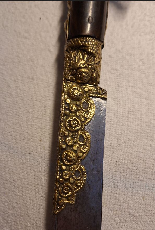

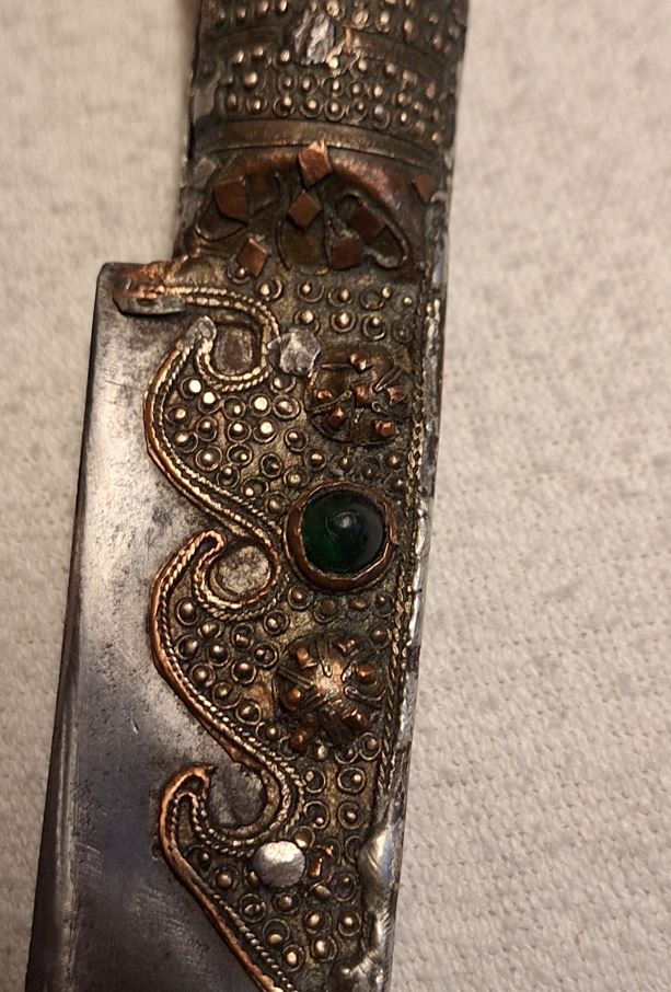

Old 10th November 2024, 02:11 PM   #6
gp
gp's Avatar
Join Date: May 2020
Posts: 1,028

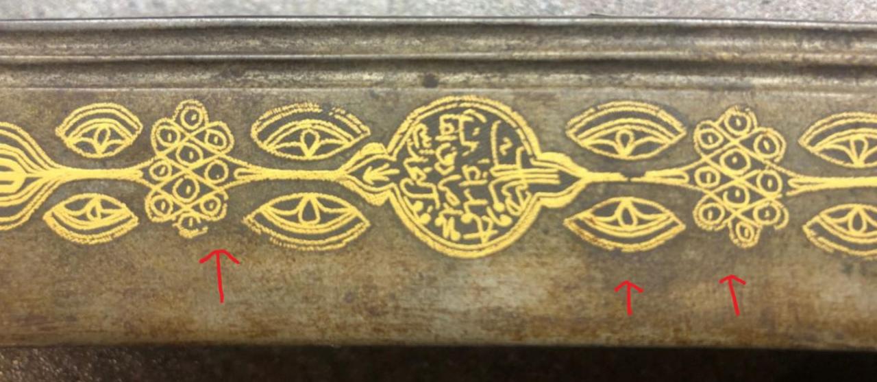

I also would recommend to clean the dirt on the blade close to the golden decoration, this in order to avoid that dirt getting a negative impact on that decoration ...
some of my blades were as dirty as yours
please compare ; the first picture is your uncleaned one versus the others ( my cleaned ones in black and white pics).
Good luck and thumbs up with your very beautiful yataghan !

I had the gold inscriptions translated by an Ottoman Scholar.
It is the Sword of an High Ranking Janissary Agha.
The Agha of the Janissaries or Janissary Agha (Ottoman Turkish: یڭیچری أغاسی; Turkish: Yeniçeri ağası) was a top Ottoman military official and courtier, and the commander of the Janissary corps.[1] Apart from the commander-general of the entire corps, the title of "Agha of the Janissaries" was also borne by the commanders of provincial garrisons of Janissaries.
The Poem is Incredible!!
I knew the sword was cool but ....
Included a picture of an Agha below.
Next I need to research the Swords owner.
Best Regards
Rob
P.S. The sword has been cleaned and preserved.

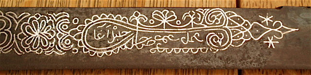

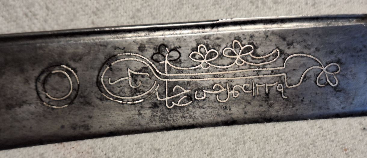

Hi,
This silver mounted one of mine may also be of interest. The translation was done quite some time ago. If anybody can decipher anything new or rectify any mistakes if indeed there are any re the translation I would be most grateful. The blade has been cleaned since these old photographs and the decoration is actually silver inlay.
Norman.
Translation,
amel-i Ömer, sahib Halil Ağa / made by Ömer, owner Halil Agha
Devleteyn babına olsun ey mir-i mu'teber / Let both this world and the other be at your door, O beloved Emir
Düşmanın bağrını delsin daima bu tığ-ı teber / Let this sword always pierce the bosom of your enemy

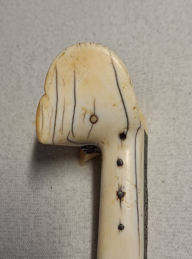

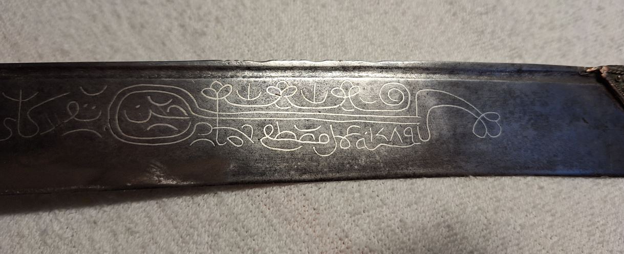

Default Cleaned
Here are some photos of the Sword after Cleaning and preservation. There were some areas of Gold inlay loss that looked like dirt. There is some brown toning on the blade and it does not come off (Not Rust). This is as far as i am willing to clean it to preserve the age/patina.
I am only presenting what the translation has brought to light. As a non Turkish speaker everything I am saying is my interpretation only.
All I know is that this is one of the finest swords in my collection.
I bought it because it is beautiful and I knew there was an interesting story behind it.
Cheers
Rob
