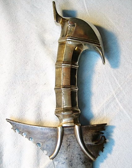

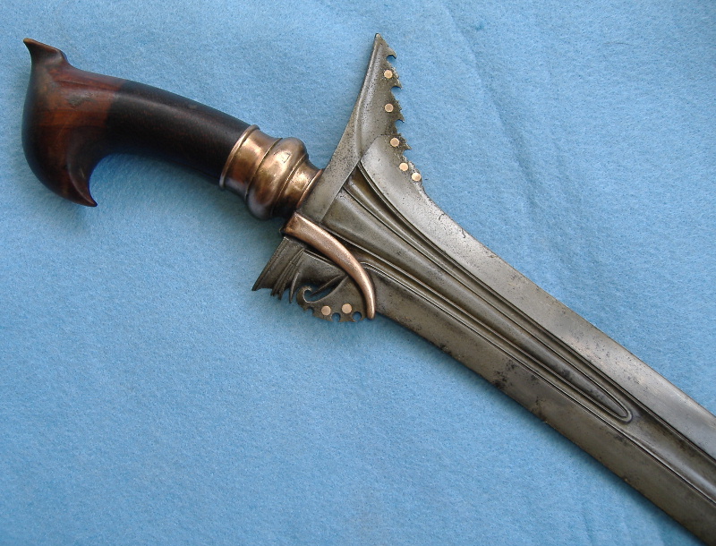

The "Moro" kris you show is in Melayu dress. It is missing any asang asang (stirrup) to clamp the gangya and blade together. The multifaceted hilt is consistent with Melayu hilts and the end of the scabbard, with its inverted "V" cut out, is also typical of Melayu work, although the gap would be filled with a dark wood for the toe of the scabbard. The blade is probably of Malayan manufacture but might be a trade blade from Sulu.

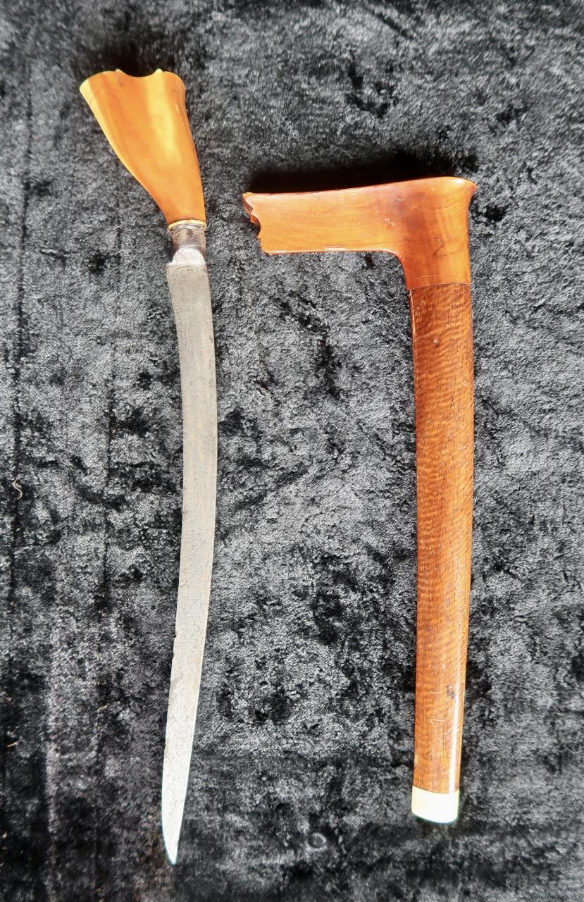

Nice purchases. I would love to see the sewar blade as well

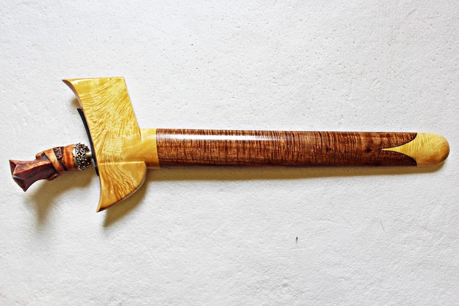

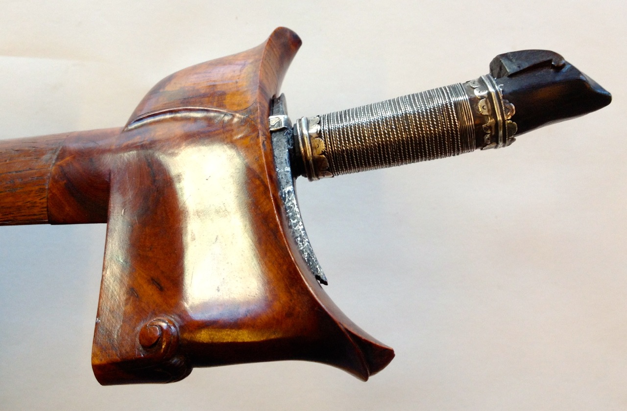

Hi Pendita65. Here is an example of the Melayu scabbard style for a keris. The wood at the toe is a light color. Ebony is more usual I believe.

Thanks Ian,
i will make one from Ebony i guess it would look good for it.

Here is the Sewar out of it's housing.

Hi Martin,
I personally would use black horn for it, it's more common.
Hi Martin and Ian,
The Malay kris may never have any asang asang, many Malay kris don't have any clamps. But the hilt missing a cup in down I guess.

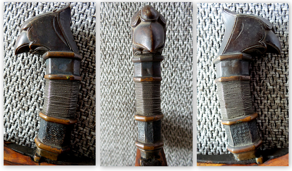

..., the hilt is square and has chamfered sides, would the cup be square too?
Hi Martin,
Yes, the cup will be square too.

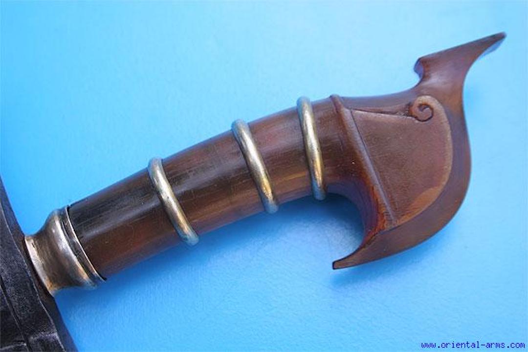

Well, there are perhaps Moro blades too dressed as Malay Sundang, but there are also genuine Malay Sundang with Asang-Asang. May be it's true for a later period, but to say, Malay Sundang never had Asang-Asang - that's simply wrong.

Hi Martin,

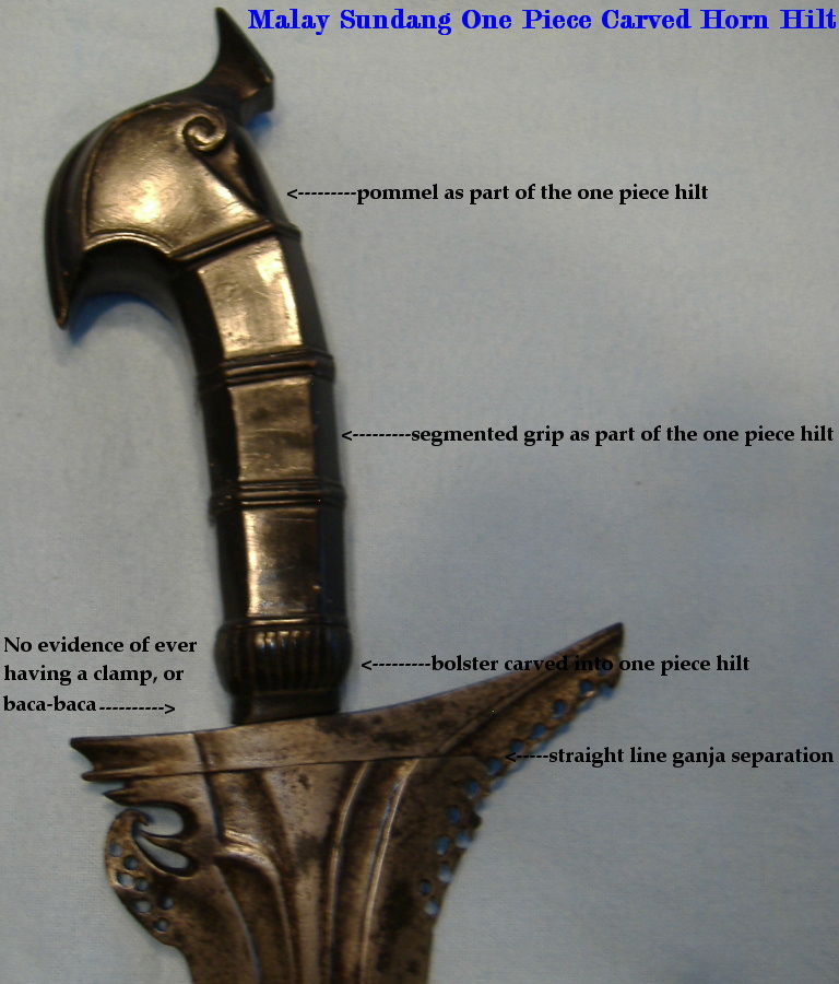

I've written "kris" and I mean the sundang with this term. Many Malay sundang don't have clamps. Can you see any signs that there had been a clamp (asang-asang) before?
For your Malay "keris" I am maybe able to help, I have some pendokok assembled. Would need the diameter of the handle. We speak about this by mail!

I've written: The Malay kris may never have any asang asang, many Malay kris don't have any clamps. But the hilt missing a cup in down I guess.
And I've shown pics from older threads to show which cup could be missing and there are Malay sundangs with and without "asang-asang".
I never claimed that Malay sundangs never had asang-asang.

Agree completely with you. There are typical Malayan sundang with asang asang/baka baka. I think that is what Detlef was also saying.
