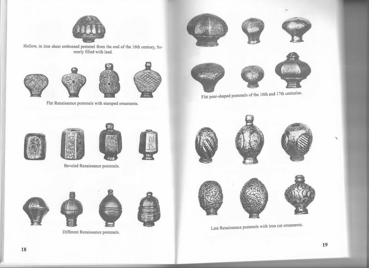

Not an exact match, but below is the closest analogues I've been able to find in Forrer's "European Sword Pommels" (the flat renaissance ones, second row left). Unfortunately the subscript is the only information given.

Hi Werecow,
Actually I did order that book yesterday Thatīs a perfect match! Thanks a lot. The decoration of the depicted pommels fits as well.

Hello Andy, that pommel is original no doubth at all, its 15th c,
